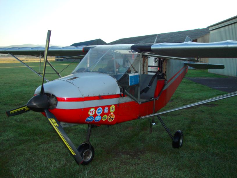

    This is the only thing I fly these days - Not quite in the same league as your Falcon, and converted to pull start for more fun LOL
    #31 The Engineer, Sep 4, 2013
  12. It's red and got DUC on it so I guess it's ok.... ;)
