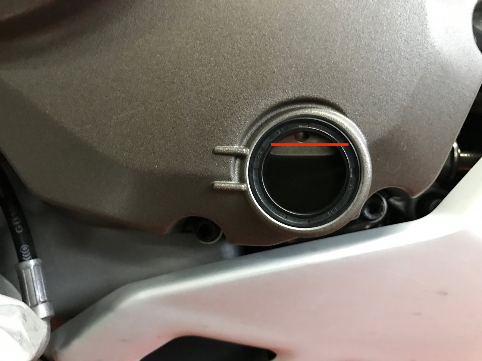

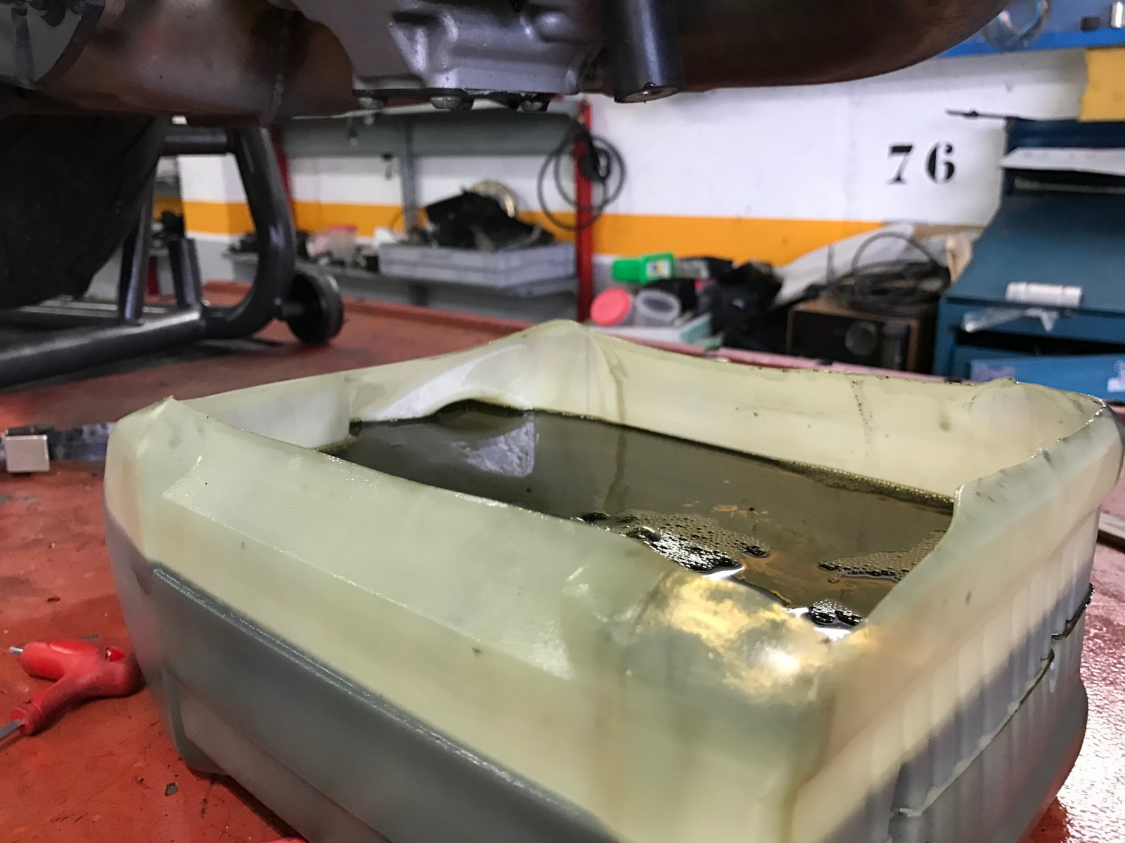

  1. THE FRIDAY I HAD TO PASS the annual revision the marker was in 7993, bearing in mind that I changed the oil with about 989 km the first time, the oil was 7000 km or so. The multi makes 3.8 liters of oil to the red streak of the photo, take measurement of the oil that came out to change and take 3.55 liters so that the consumption in 7000km has been of 0.25 liters and the kilometers have been done by All types of roads, and types of driving from highways to very small mountain passes with travel between second and third speed over 60 km.
    The red line is where I left the oil when I put the 3.8 liters and I took a picture of how far I had gone down and the oil that I took before measuring it
    I hope you serve them.
