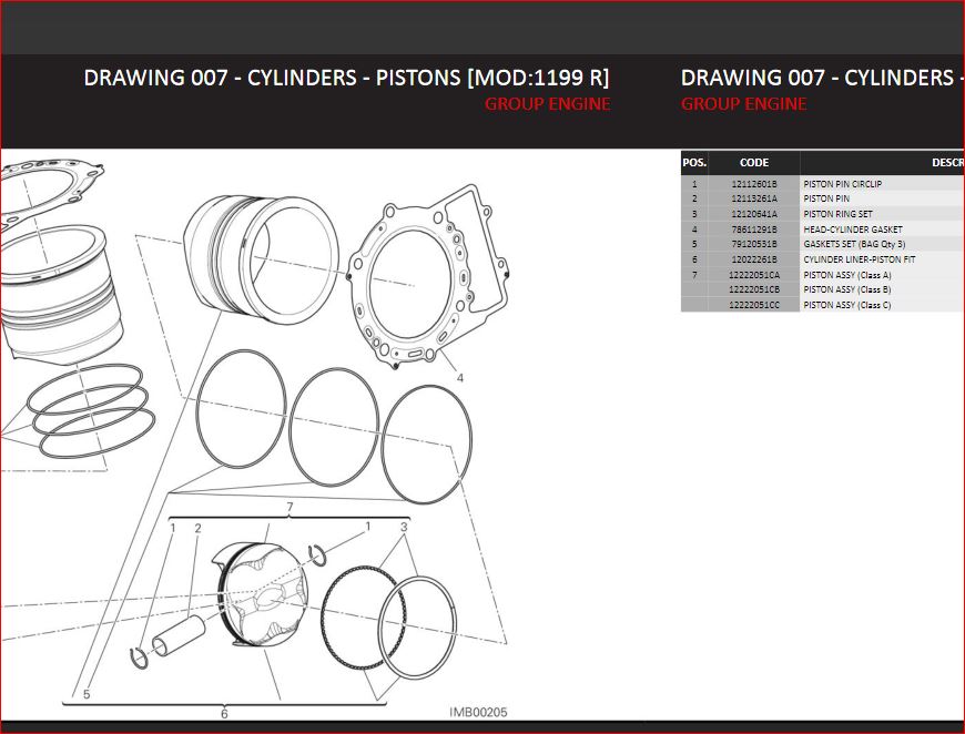

    the race engines have one compression ring and one oil ring? you sure on oil ring? very interested.

  5. So I was told by moto rapido ?

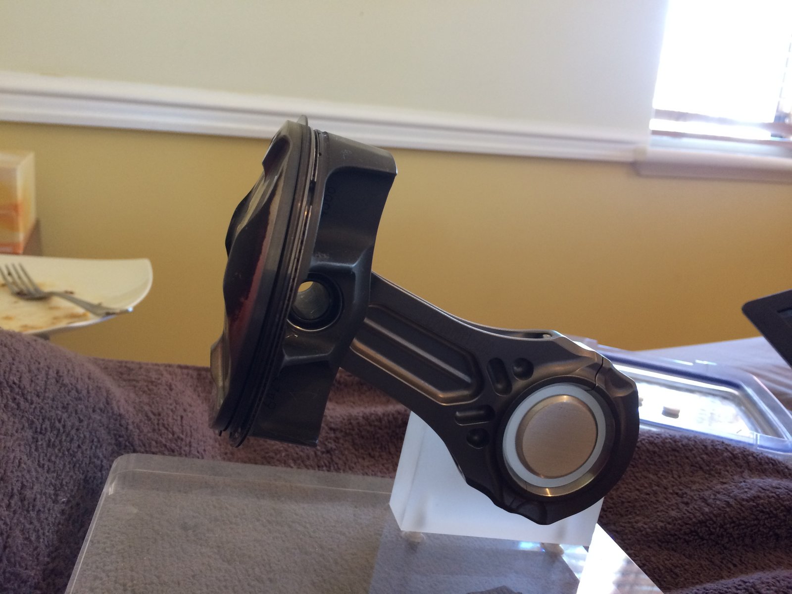

  8. I think wrong? but not sure
    Ferrari F2003 piston different again has 2xcompression 1x oil but bottom compression is in same groove as oil? Titanium Rod IMG_2778.JPG
