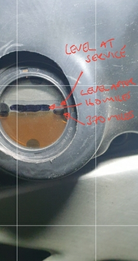

  2. So this is my oil situation. Bike has now done just over 4.5k miles.
    1st year service was done and as can be seen on my doodlings I marked the level that the oil level was filled to. After 160 miles i marked it again and it looked like it had dropped.
    Today another 210 miles and the level has dropped considerably.
    My guestimate is that with 800 miles it will have gone from maximum to minimum mark.
  3. So today i used a syringe to re fill the oil to the service level and it took 135mls.
    #83 999nutta, Oct 17, 2021
