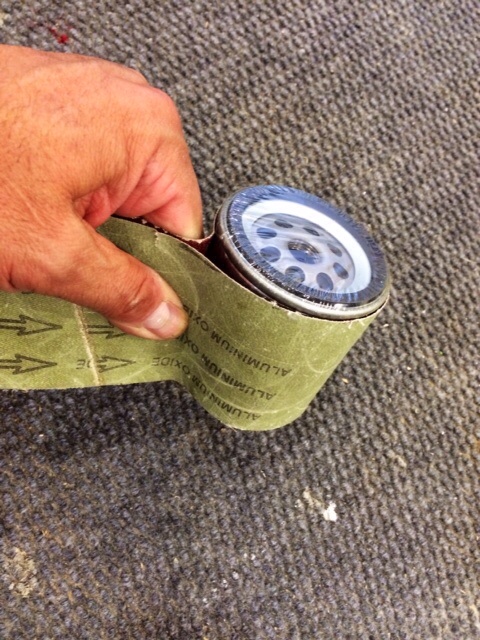

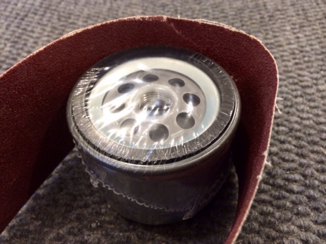

  5. Hi guys. I'm new to this forum. Residing in Canada, and loving my Ducati 848!
    A trick I discovered while dealing with a tight filter was....... To flip a sanding belt inside out and slip it over the filter, then use it as a wrench. Works every time.
    The sanding grit , grips the filter very well and the width of the belt won't crush the filter like a belt wrench.
    Just thought I would share.....

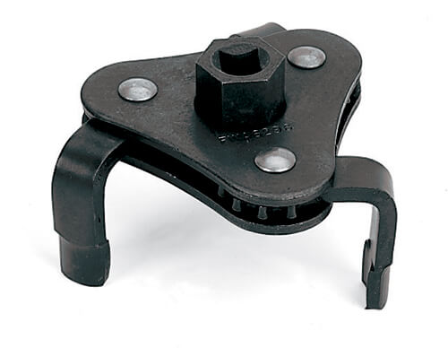

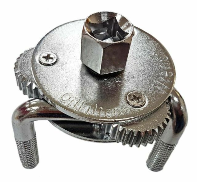

  12. You need one of these, 3/8" drive, the more force you apply to a ratchet the tighter the fingers grip.
    These spin-on, hand tight, filters are often over-tightened & I have never failed to get an oil filter off with this.
    Don't be tempted to go for this cheaper version, they're crap !
    There is no need to use a torque wrench to tighten one of these spin-on filters, hand tight is plenty tight enough !
