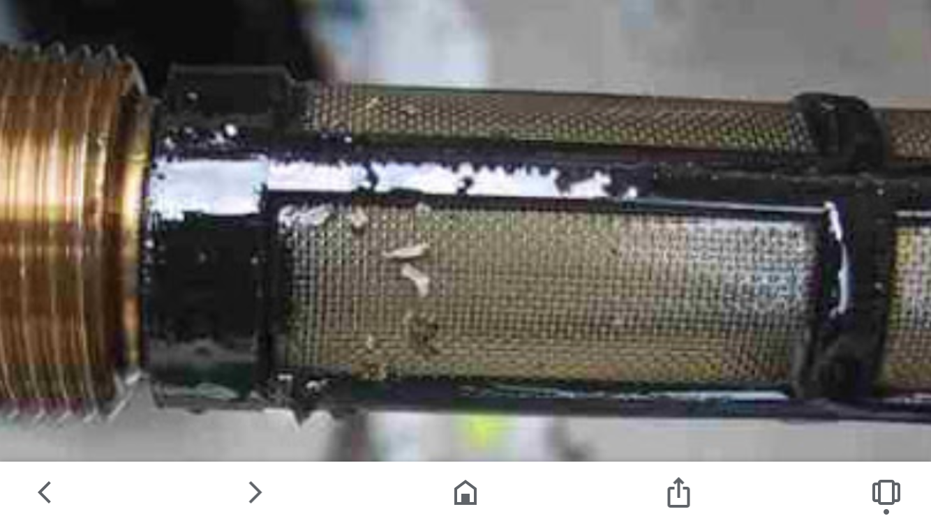

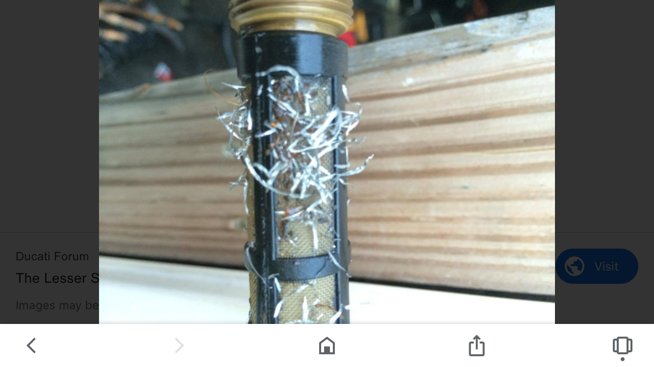

  7. 03D74E3E-9717-4BB0-888B-F535138AFA5B.png 3B47B22F-090D-4840-B37C-98BEF36A0107.png Post a photo of the strainer once it’s out, I’ve seen various examples from long ribon like pieces of alloy to “finger nail clippings” as Chris described, it’s possible to have some metallic deposits on there though that are nothing to worry about, ref my post further up this trail it’s a quick job to check the strainer and you don’t need to drop all of the oil, if you find the rear brake is binding check you’ve got play between the master cylinder actuating rod and piston, move the brake lever with your hand and the rod should tap against the piston, this tells you there’s a gap/clearance, it shouldn’t constantly sit against the piston the gap is necessary.
    Here’s a couple of examples of debris on the gauze, personally I doubt you’ve got a gallery plug issue, but it needs checking.

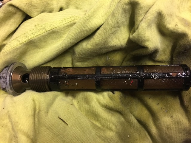

  9. So, finally got around to draining the oil this w/e and extracted the filter which looks like this. Not much in the way of metal shavings but a bit more crud than I expected. Quite a bit of what looks like grit!! Is this more crud than I should expect to see? I wonder whether this might be affecting the oil pump in some way?
    Oh yes... and brakes are off for a refurb as they are the only bits that I hadn’t touched after 7 years standing the garage.
  10. It’s certainly got a lot more on it than my 900ss and M900 had, but you don’t know when it was last cleaned I suppose, there does appear to be an aluminium shaving or two in the debris but it’s hard to tell from a photo, for me it’s inconclusive but you really need someone that performed a lot of oil changes on these to comment, Nelly?
