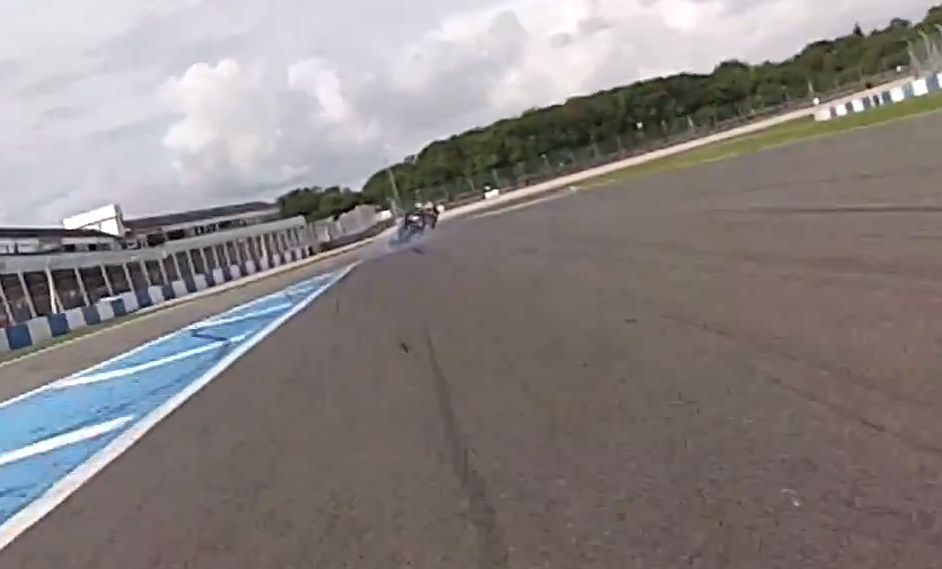

  2. brake failed?????
  3. Pumped it once and no brakes pumped it twice and locked the front up . Very easily done when you are trying to brake for a fast corner only to find there isnt any. Natural reaction will be to grab a big handful of brake on the second attempt . I think you did well it could have been a lot nastier .

    My bet is air got in the master from the oem coffin reservoir.
    I believe supersport rules were changed to allow 749r riders to use remote reservoirs for this very reason.
    Either way, nasty crash and I hope you make a speedy recovery.

  6. Ouch! Sounds like pads knocked back, pull, nothing, panic yank, full on lock up
  7. Defo pads weren't knocked back as i didn't have any tank slap before hand. Its got to be air in the system via broken seal on the master cylinder or something. Either way its to late now just got to get fixed and fix the bike when i can afford it . Will defo be investing in a new race brembo master cylinder though :). From the start though its not shaken me from riding and i cant wait to get back on! I love trackdays as it the only way im aloud to ride and ride fast which is what i want to do. Heres a pick of my knee from nottingham hospital once they'd cleaned it up. [​IMG]
