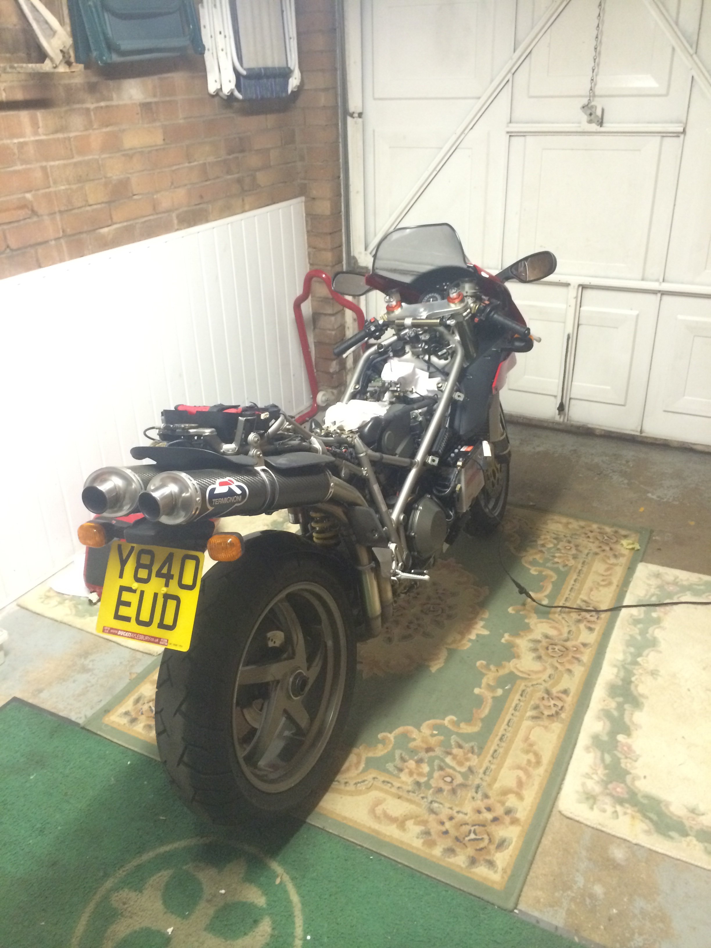

  9. Cheers. Got a bit carried away last night when I got her home..
    Off to ducati today to get/order some genuine parts for her, fluids have been ordered elsewhere as they are stealers!! Going for Metzeler M7RR rubber and ordered Brembo SA & SP pads. Can't wait to get her on the road. Cheers guys.

  11. The stealers wanted £20 each spark plug! I've ended up ordering two NGK iridium plugs which people seem to rate for the 996 for £13 delivered. Just working my way through servicing her now, hopefully have the belts done tomorrow but I'm shitting myself. Ordered all the fluids online as it was way cheaper than getting them from the stealers.
    The oil leak has turned out to be a really mucky mating service + the M6 thread in the crankcase has been stripped, I've managed to source a slightly longer bolt which grips the last few threads that aren't stripped (.literally 2) and I'm hoping that plus the new oring will do the job.
    After that I'm just waiting on the postman. Booked her in for an MOT next Saturday. Even treated myself to booking up Cadwell at the end of the month on the trackbike :)

  15. Great! Anyone else had problems with iridium NGK plugs? Got timing belts and oil change done today, ran sweet as a nut.
  16. do the belts yourself?
  17. Yeah, all done with thanks to the Haynes manual. Just the wheels, brakes, forks & brake/clutch fluids to do
  18. Just in case you didn't have it on your checklist (and I can't recall if the Haynes manual mentions it) but make sure that you rotated the tensioners anti-clockwise when setting the tension otherwise the belts will run too close together and it could end in tears.
