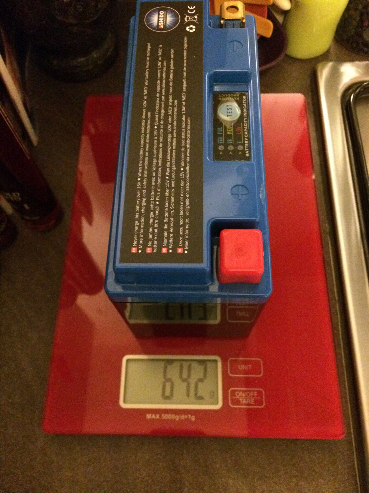

  11. Mine just came from moto Rapido. Great service as always.
    Charged and ready to fit. Amazing how light it is.
