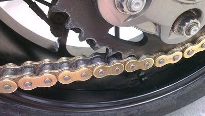

  3. My o/e chain and sprockets need replacing having done 13755 miles; all with an e-scotoiler working away on an 11 plate MST. Quote from my local dealer for a new o/e set plus fitting was £390!!!! Found these guys online - JJC Race&Rally who stock bits for tin boxes & bikes. A DID X ring gold super heavy duty c&s kit (steel JT sprockets) from them is £186. Needles to say I've ordered a set.

  7. Re my earlier post above for a new C&S kit. I had an e-mail from Hayden at JJC Race & Rally saying that there were probs with my order! 'Too good to be true' sprang to mind. My DID super duper x ring was there but wrong sprockets had turned up. He rang supplier who had put a 'stop' on them!! No idead what that meant. Needless to say they (JJC) have come good and sent me the chain and a pair of AFAM steel sprockets. All for £185 so I can't grumble. They go on next week along with a 15k belt service; gulp.

  10. Right here goes; update no. 2. Picked up C&S kit from courier from JJC. Opened it and inside......a C&S kit from AFAM!!!! Not what i'd ordered so e-mailed Hayden again. His reply; D.I.D. have withdrawn their X Ring Super Heavy Duty kit for the Mutley as it's not strong enough! Hence them sending me an AFAM kit with gold XS AFAM chain, sprogs are steel as well. All 530 pitch. It all goes on on Friday so will let peeps know after a few 1000 kloms to see if it's stretched. My old o/e chain was completely u/s after 14000 eScotoiler miles!
  11. Nowt wrong with Afam kit, I've used their stuff many times. Once you've got it on spend some time making sure the tension and wheel alignment is right; that'll kill your chain and sprockets quicker than any farting around with different brands of chain or lube. Again, don't go mad with the cleaning regime, it doesn't help.
