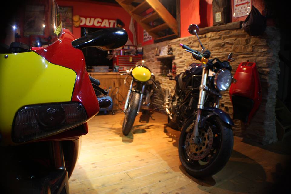

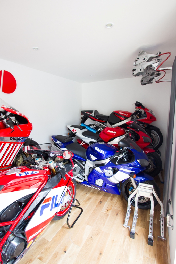

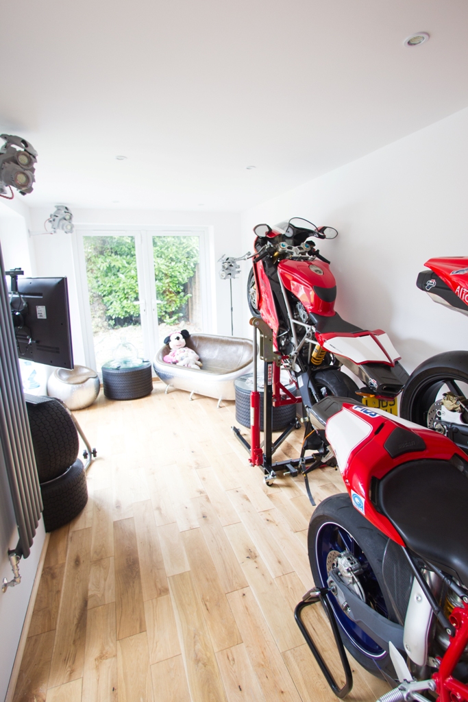

  2. Well my man cave is no where as posh as some of these but I like it.

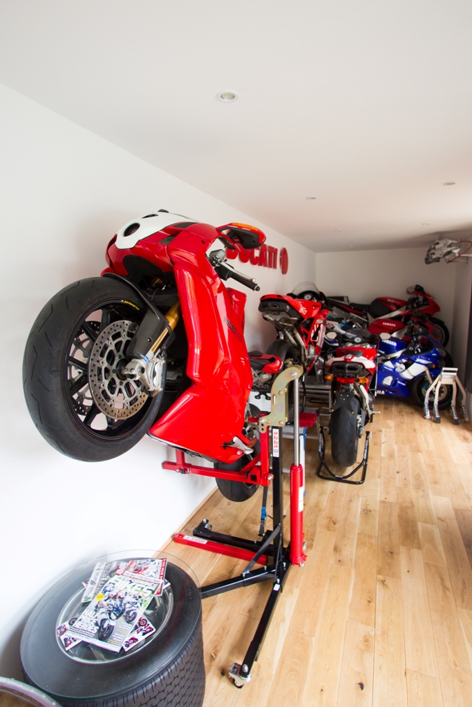

  3. Two bikes and multistrada mounting device for shortarses, perfick.
  4. Had to use it for my KTM 690 enduro R
  5. Looks damp and cold....could do with ac?

  9. Yellow number board on red bike, not seen that before, more pics please.

  13. Originally got the idea not from 500GP but from AMA in the states where they run with yellow boards for a while in the early mid 90's. much like BSB ran yellow on non-factory teams/evo or whatever. Also it's nice to not be like every other 916 style bike with the statutory white. Allways easy to spot my bike.
    Ok but another pic inside the garage/house LOL
  14. Doesn't have to be posh, i used to have an old single concrete sectional garage, rammed with 12 bikes and a racing outfit parked outside. Still it was my domain and it was what was in it that was important to me. As long as it has a roof and is dry, thats all that matters.
    • Agree Agree x 4
  15. Nice idea, would like to see same daylight pics to do it justice.
    Is the front board a sticker or a paint job?

  17. I painted it in about 2000, living and working at the Nurburgring it does get used.
