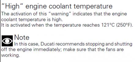

    Never had the 'high temp' warning come up btw
