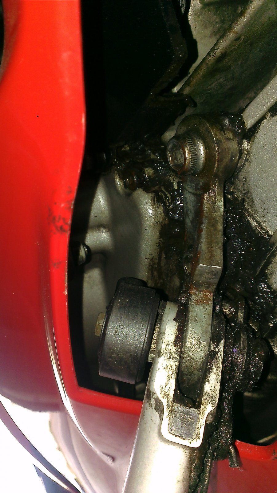

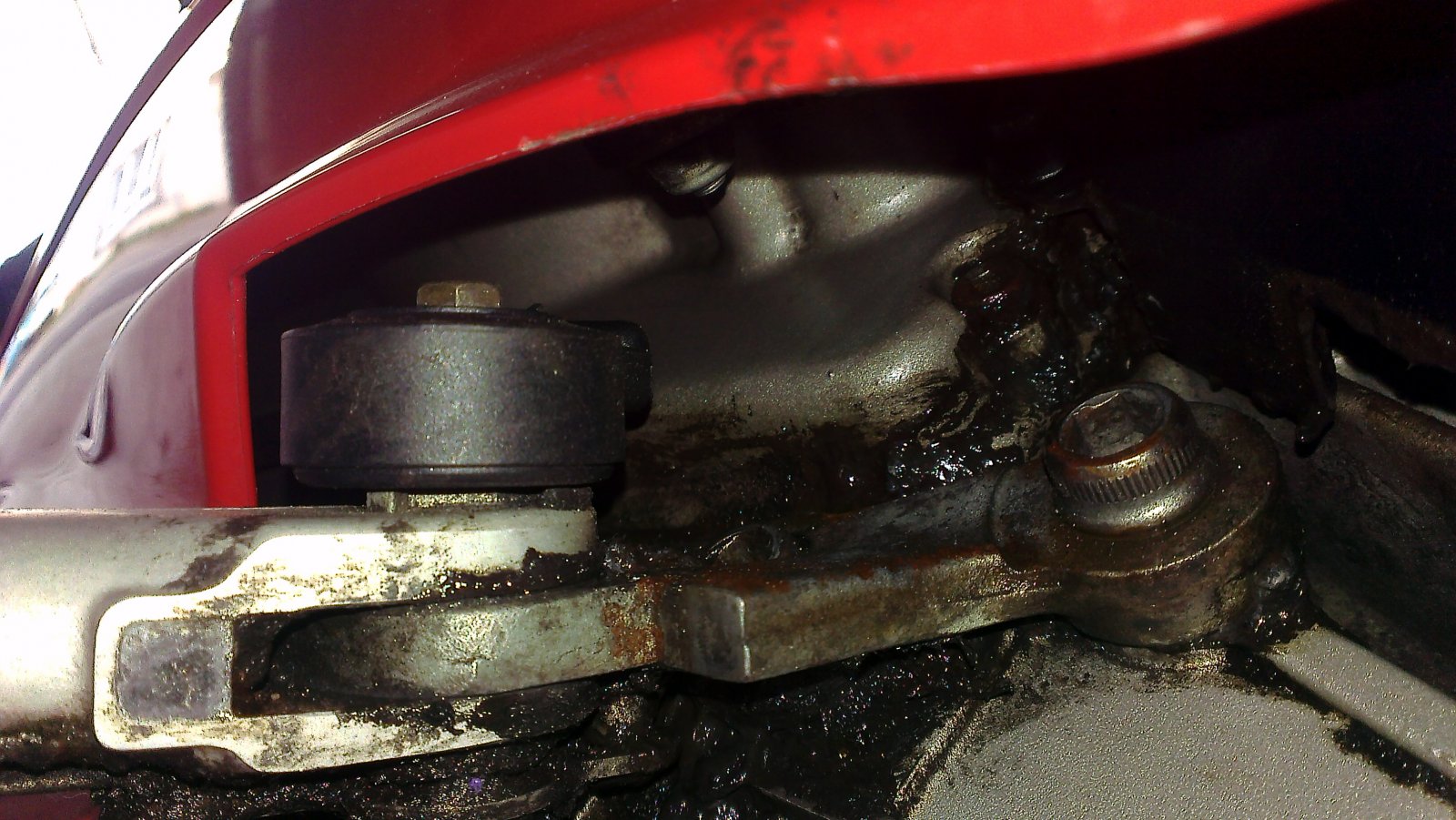

  16. Bike now seems to be running at half the power, no force when opening the throttle, something holding it back. I used to almost wheeely when taking off..
    I noticed build up of black residue on bike above side stand. Hopefully can see from pics. Is this something to worry about? I took the pictures from looking up at side stand joint.
  17. Chain lube
  18. In my opinion the best thing that you can do is to take the bike to a dealer. You seem to be clutching at straws and not getting a definite answer here.
