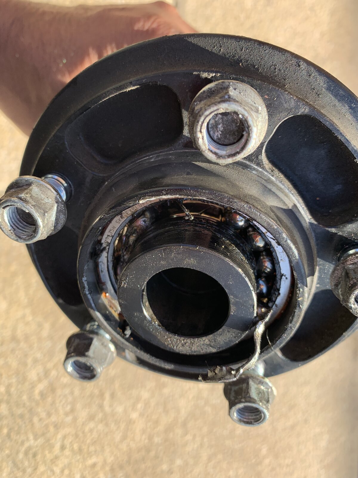

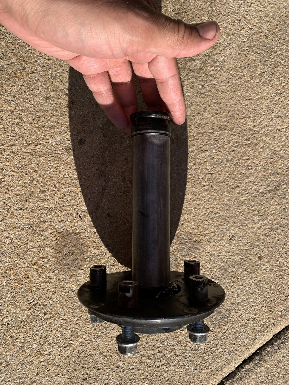

  10. On my rear wheel(double sided swingarm)
    The is of the internal spacer is larger than the spacers that sit in the bearing leaving a small lip to tap out, is used a spare swing arm spindle and rubber hammer and gave both sides a couple of taps. Disc side spacer pops out, however sprocket side spacer looks to be a two part affair either side of a third bearing that sits in the sprocket carrier. I could not drive that bearing out(will drop it to a mate with a press.( I tried destroying the bearing but it’s design makes it hard.

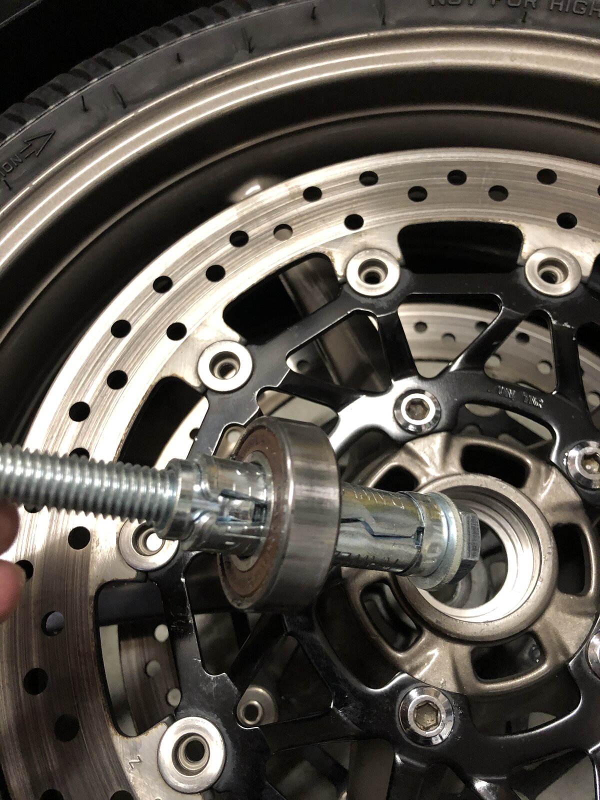

  11. Plus one for @RickyX rawl idea. Here’s one I did last year on Daytona.
    Edit. It’s an m12 / 60L Rawl
