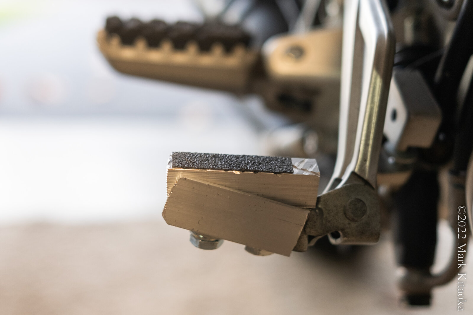

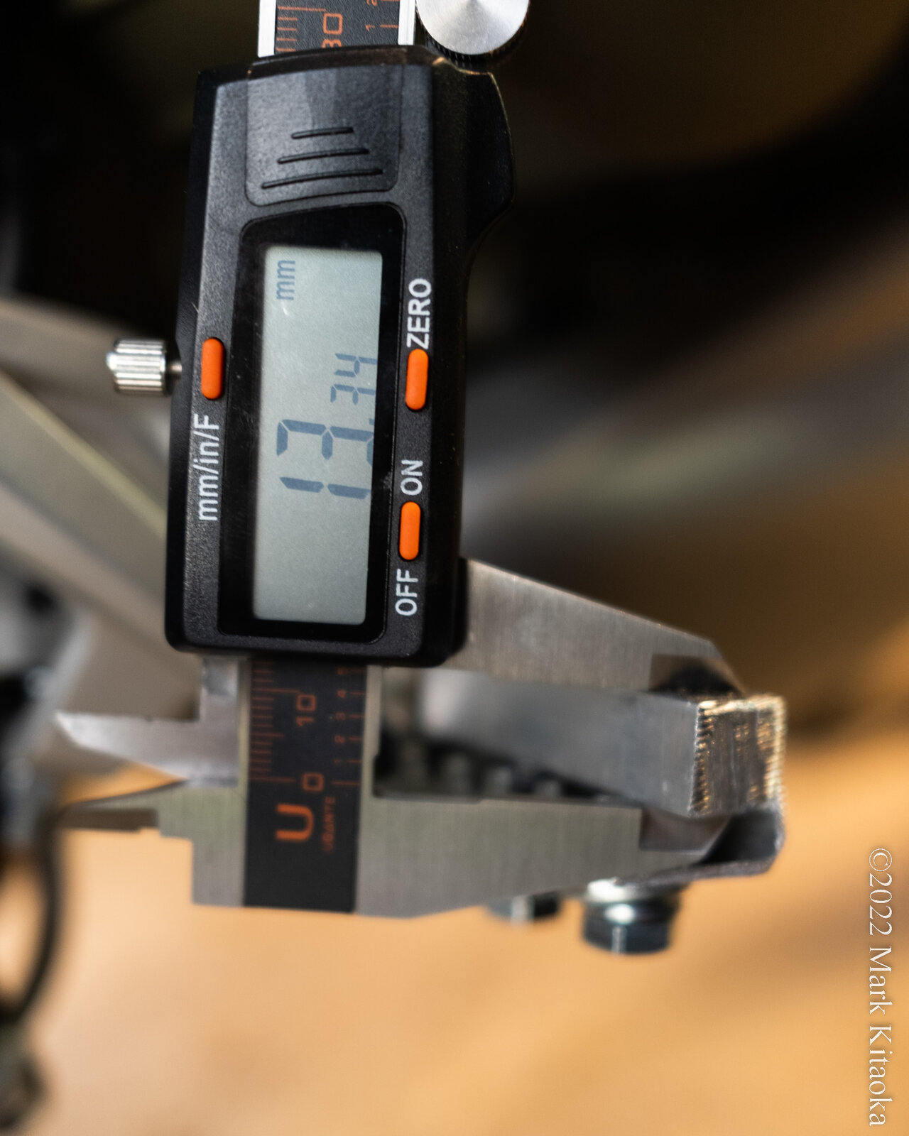

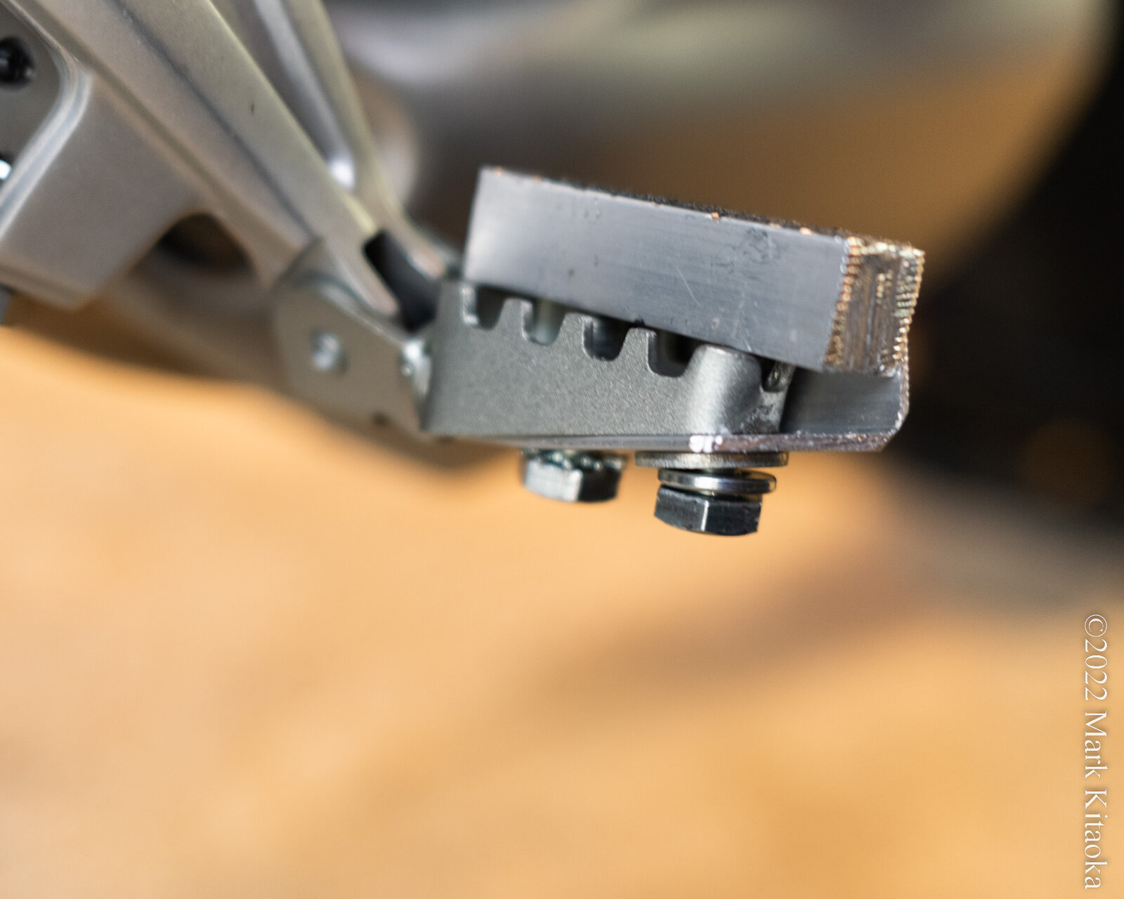

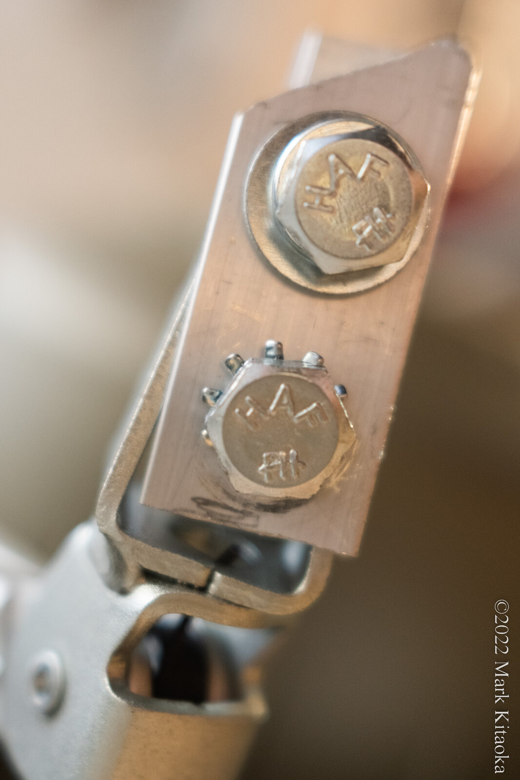

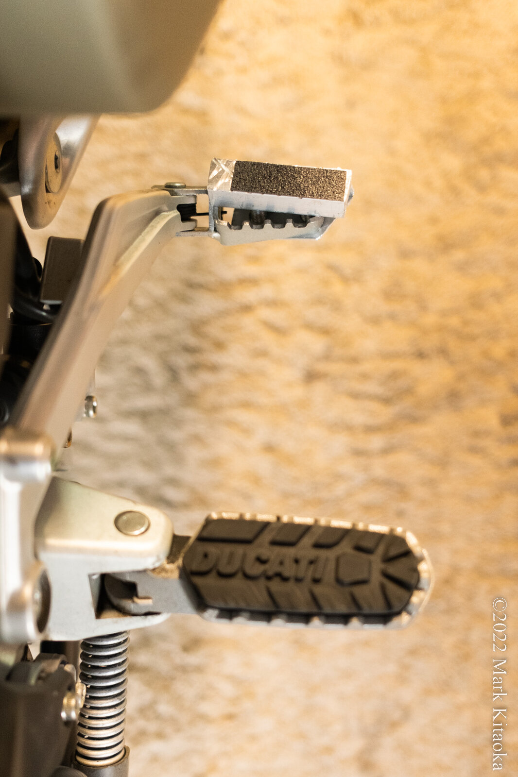

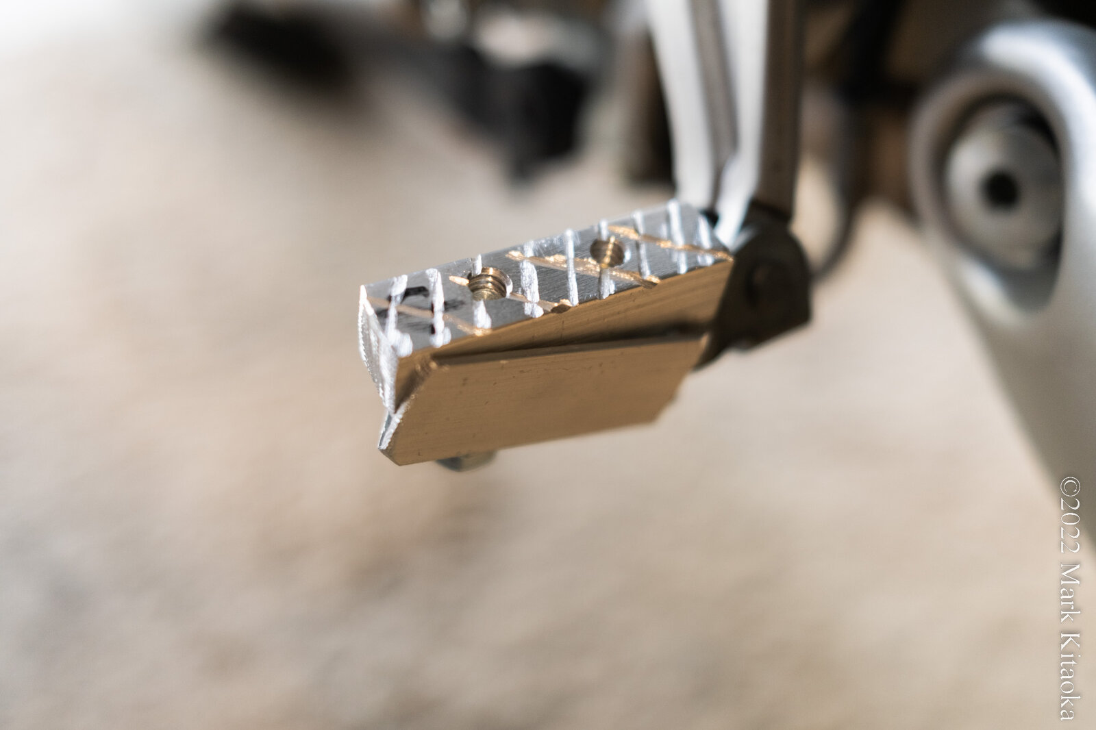

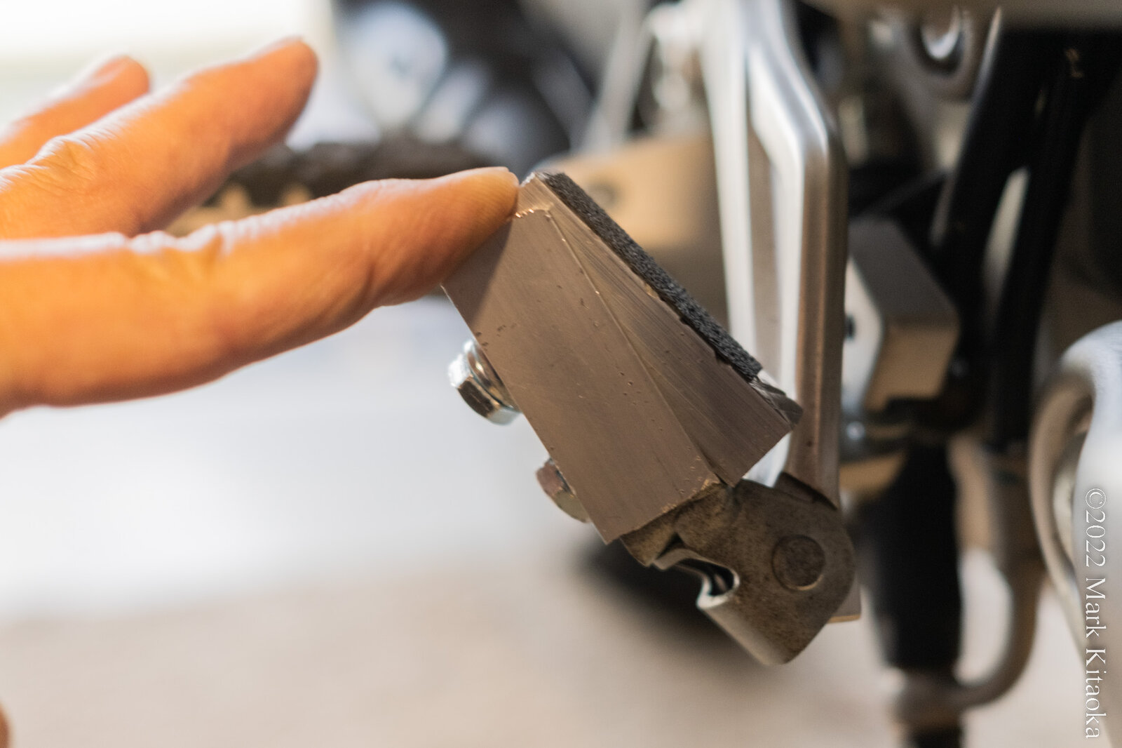

  2. I own a 2022 MSV4S Sport. The one thing that bugged me was the poor bite and performance of the rear Brembo. I adjusted the plunger rod so that the bite is sooner than how the bike was delivered. Adjusted the stop/brake light switch trigger stop to its minimum. And I fabricated my pedal extension out of aluminum bar stock to raise the pedal height by 13mm. Drilled and tapped it, bolted it to the pedal. The OEM adjustment was not enough for my liking. The new MS Rally has an adjustable rear brake pedal for height. Not sure how much those are, but my little ugly mod works for me so I'm keeping it.
    I road raced and taught road racing, and used my rear brake for trail braking in turns or to settle the bike when needed. Loads of opinions on using the rear brakes, but what worked for me in late braking is what I did.

  3. Brilliant.
    I wander if the rally pedal can be mounted on my 2010 model.
    Also to adjust the rod you need to remove the brake lever. Am I correct?
  4. Oh gosh sorry! I 'assumed' you were talking about the same model as mine. Oops. I'd check to see if the arm is the same as on the V4s. I never looked since I'm frugal and happy with my DIY extender.
    I also changed my footpegs. I found the OEM ones too narrow for my liking. The SW Motech ones are wider so while standing is more comfortable. And they adjust for pedal height and angle. This is just another option you can look to.
    They also sell extensions for brake pedals.
