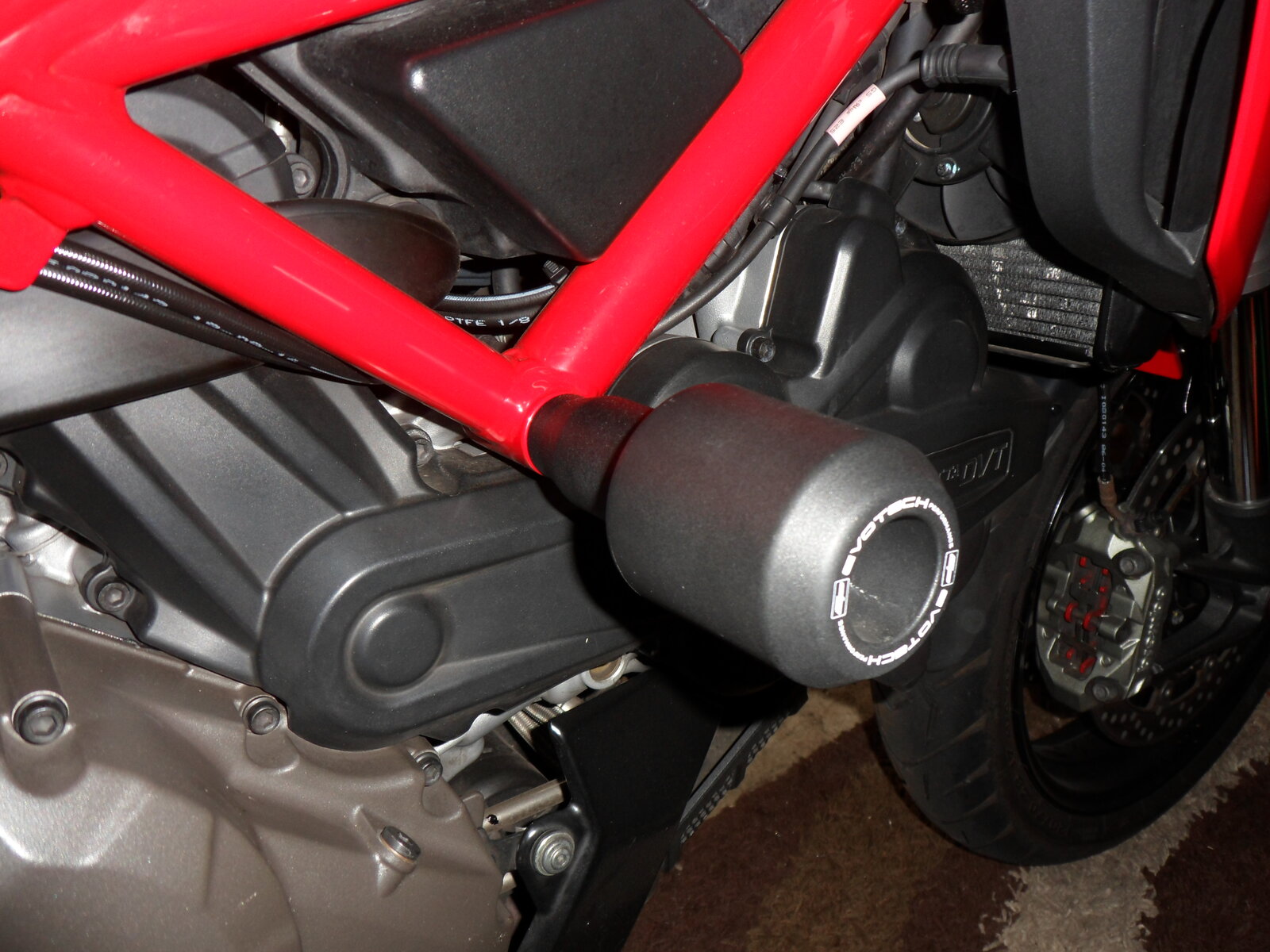

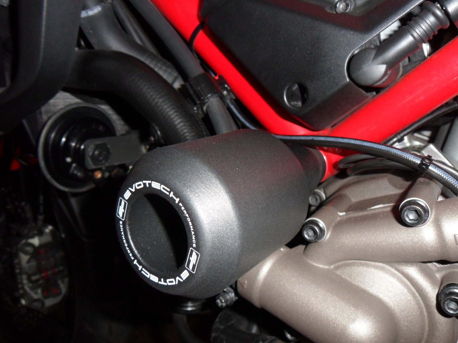

    My EP crash bobbins
    LHS
    RHS
  3. Thank you. How much of a gap is there between your frame and the bobbins?
    Is the oxidation the black colouring?

  6. Just had a looksee at EP and they are different part no's, DVT being 12482-01 and 1260 013903-01.
    Mine are flush to the frame no discernible gap as the mounts are nipped up internally, if that makes sense!

    My dvt bobbins from EP site
