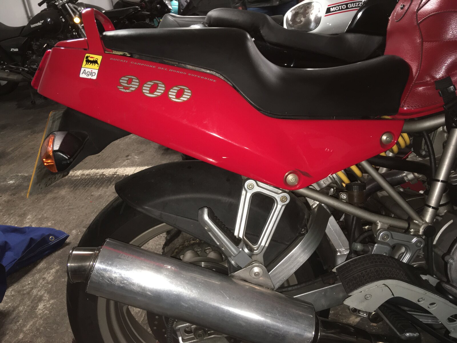

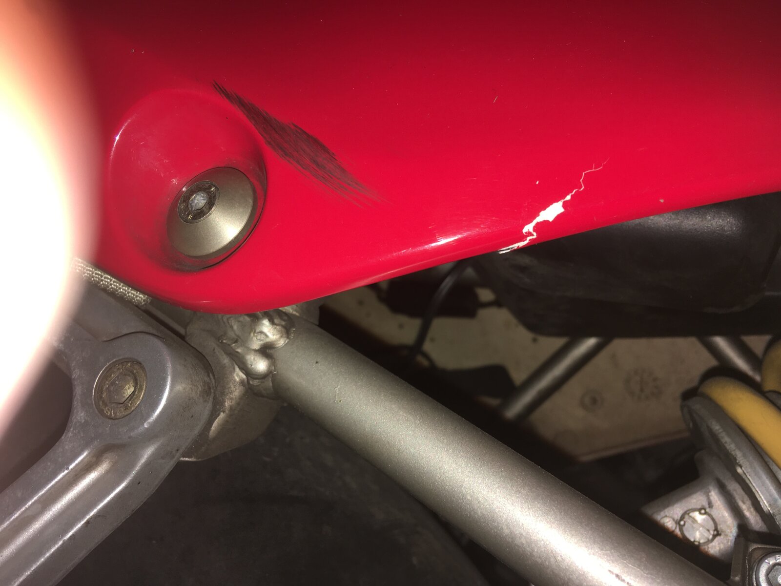

  3. Just snapped the rear side panel damage.

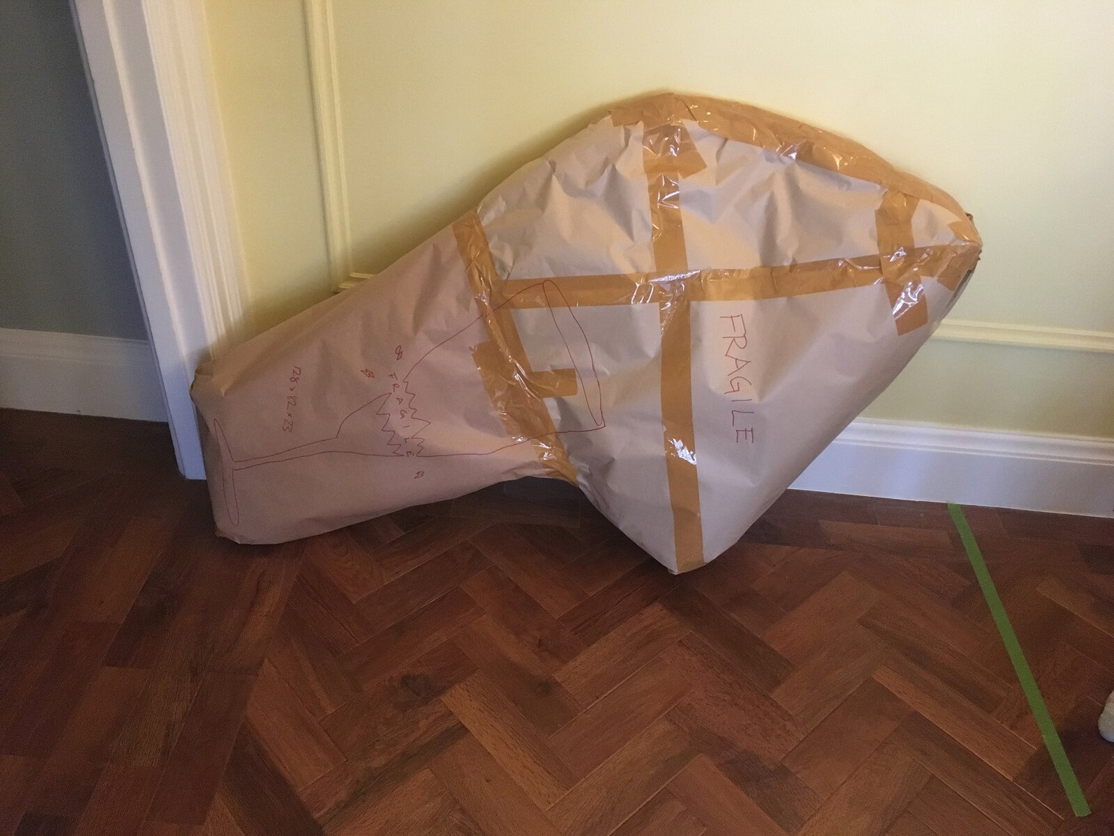

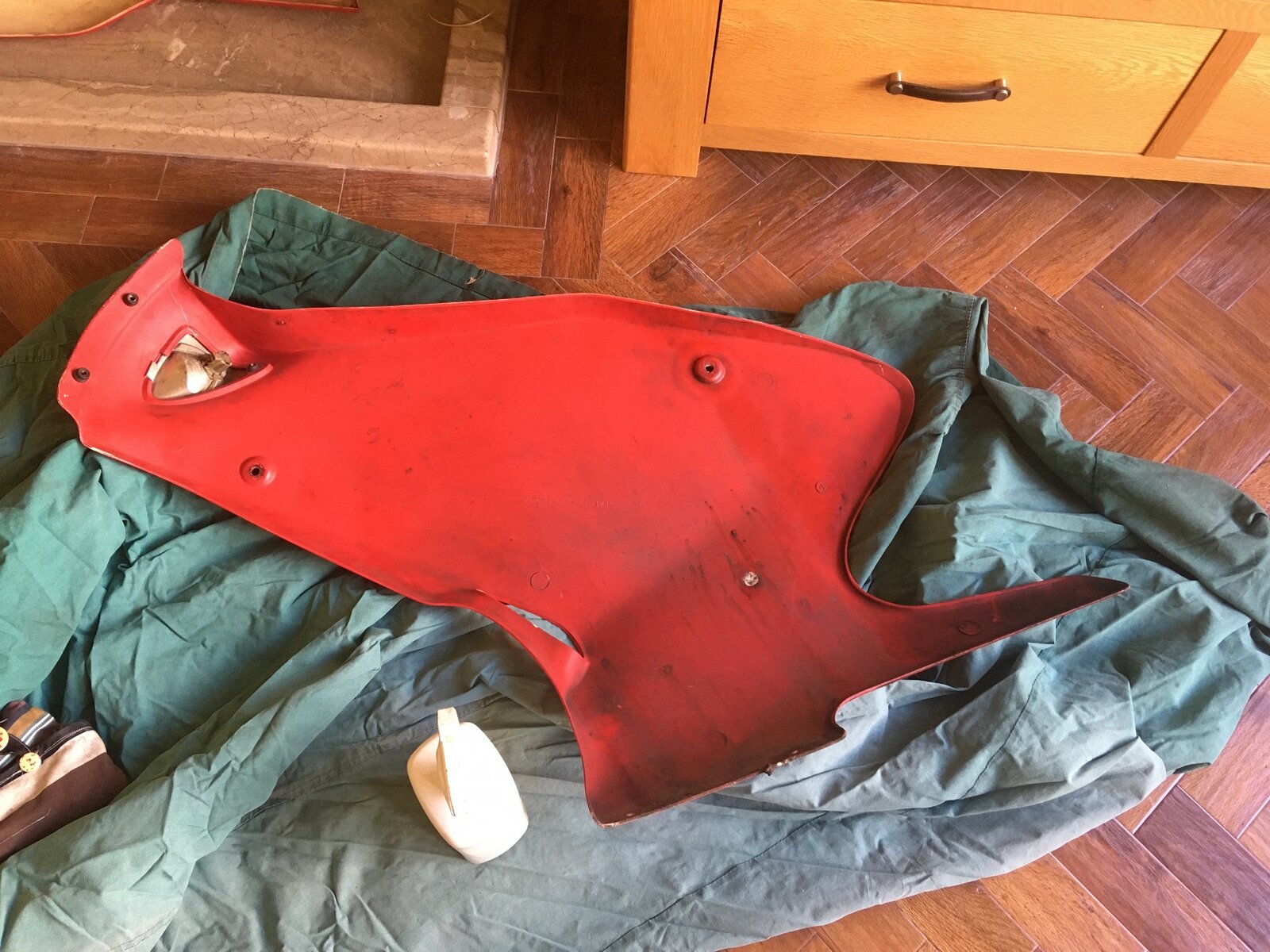

  4. Off the parts went, after a bit of a clean, a couple weeks ago.
    I hope they reinforce the area (arrowed) where the fairing stay has worn some of the fibreglass away.

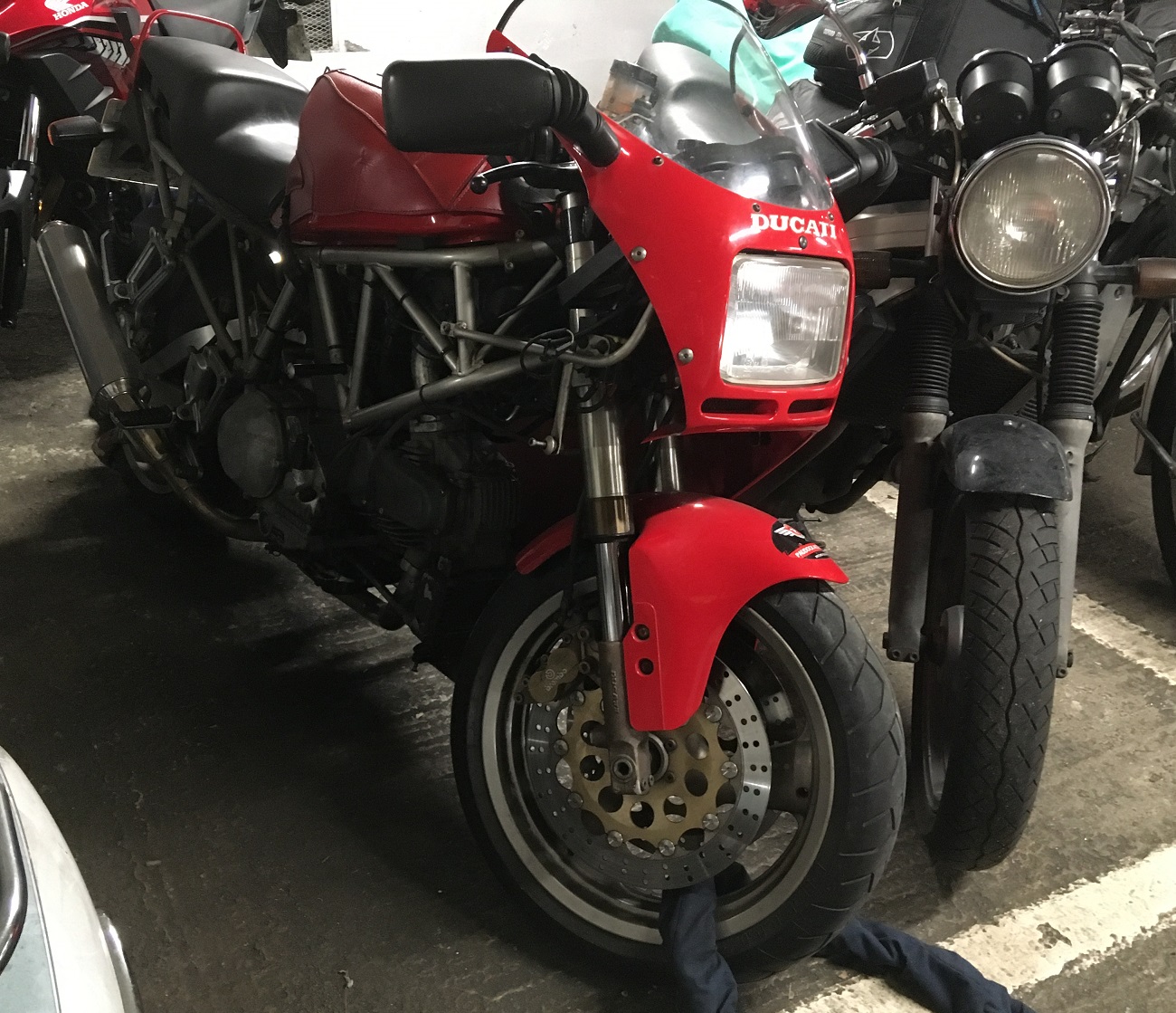

  5. The bike looks a bit sad at the moment.

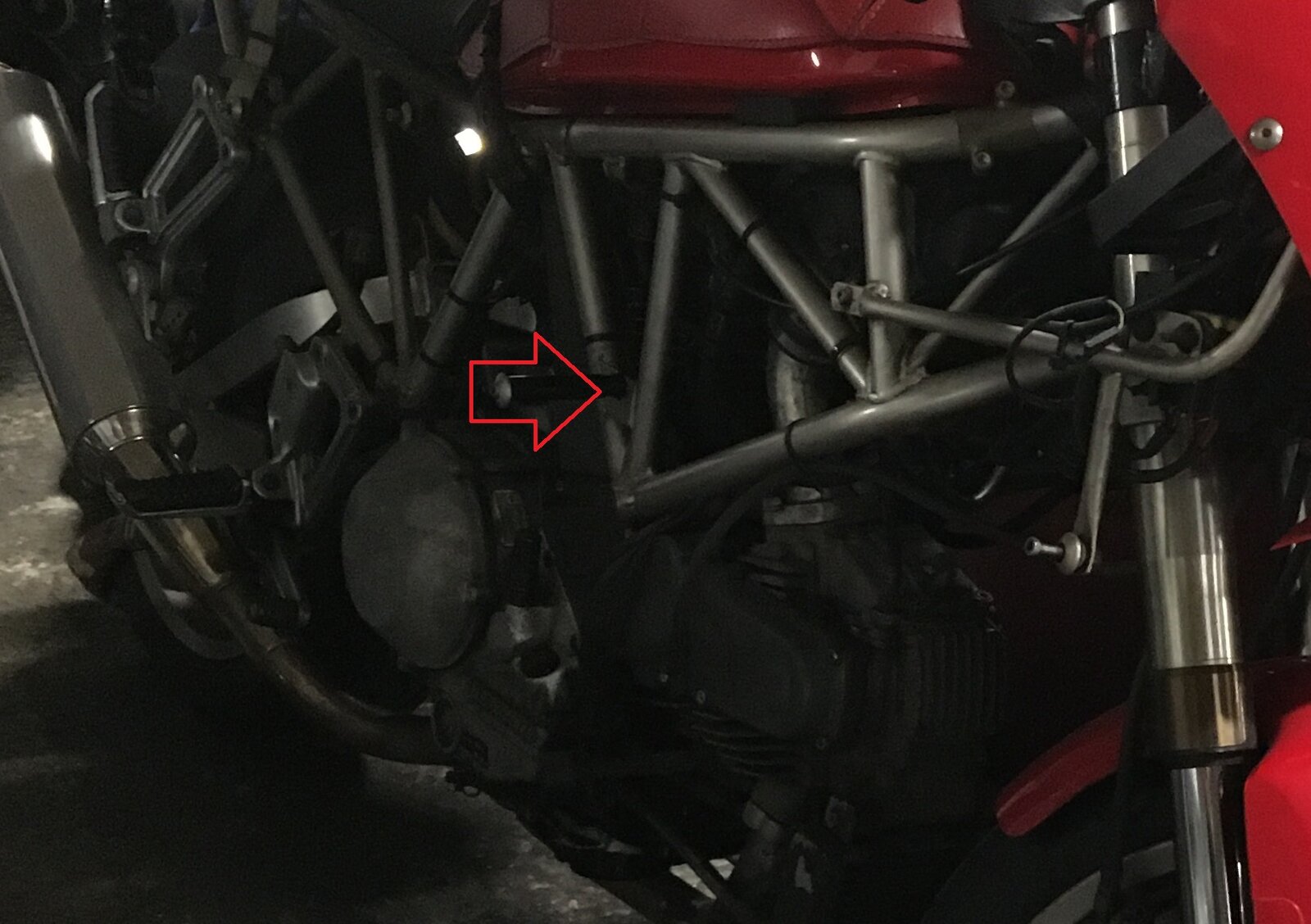

  6. If this plate is a little bent (outwards), should I try and straighten it?
  7. I would use a large g-clamp to flatten the metal where the fairing stay sits and tweak it so that it is perpendicular to the frame horizontally and vertically. Then you know it is not moving the fairing mounting point and potentially introducing misalignment /stresses elsewhere in the fairing.
  8. if it's only mildly massaged and plate not cracked then, yes, definitely! as long as you are careful.
  9. hard to apply force considering location - what would be ideal, because you are exactly reversing the damage action - is to attach a slide-hammer or equivalent. A bit of ingenuity adapting something could be just as effective e.g. - a nice long bolt with plenty of thread, some "mass" with a hole in it, i've known people drill clean through the head of a club hammer just for this purpose.

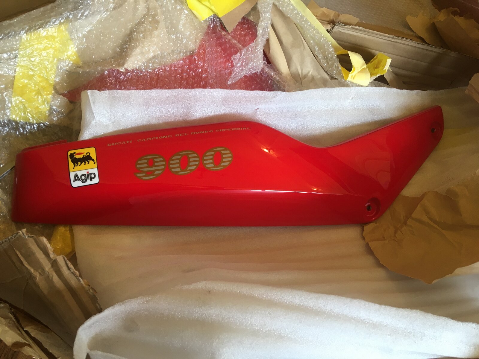

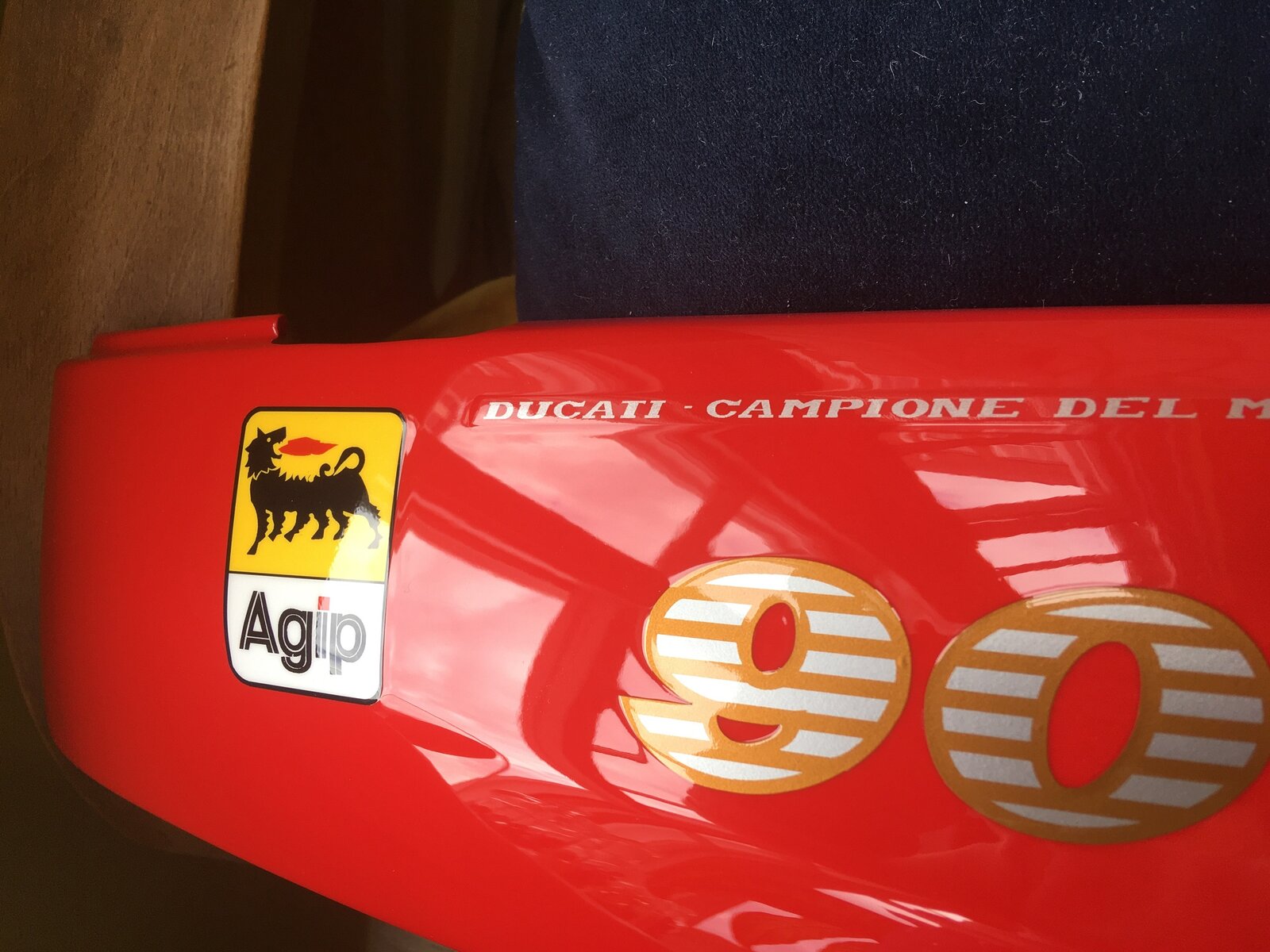

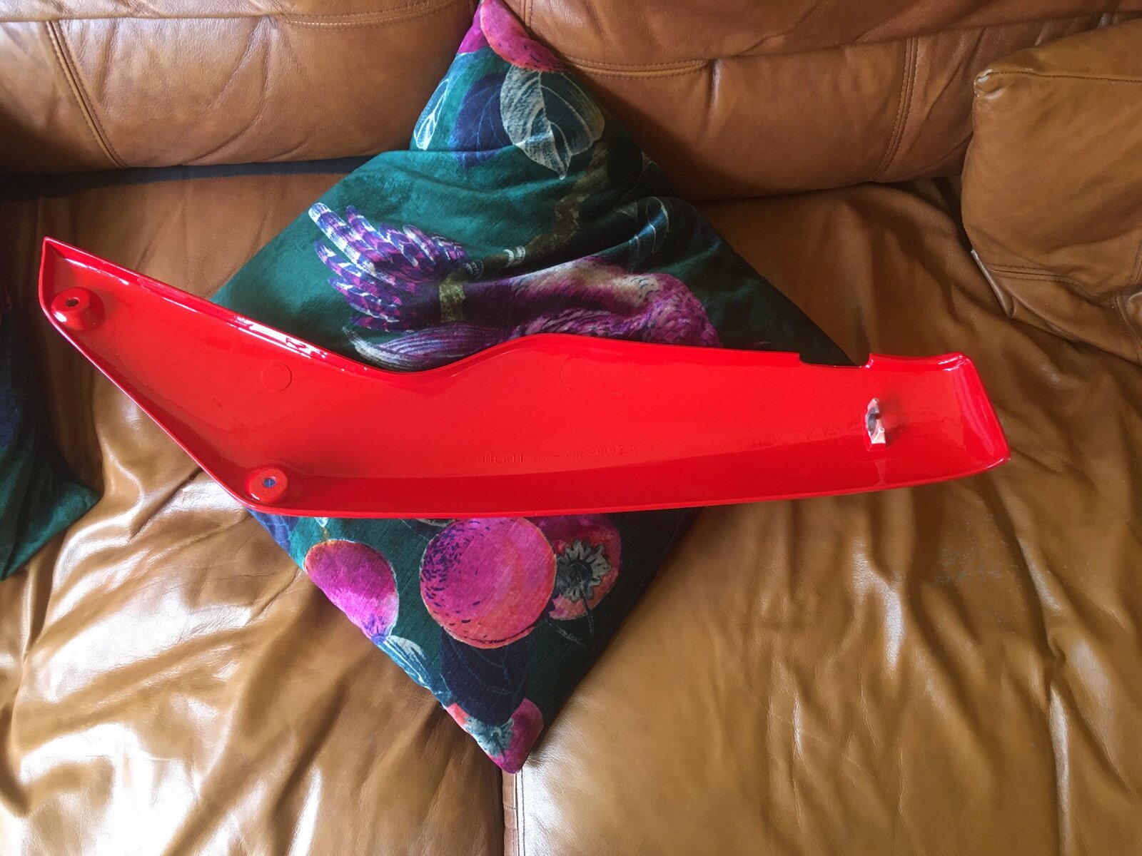

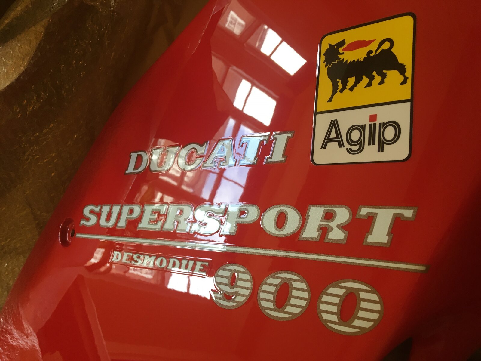

  10. The fairing pieces are back. Painted inside and out, only diff to std that I can see is that the painter lacquered over the stickers. Rear fairing, £100.

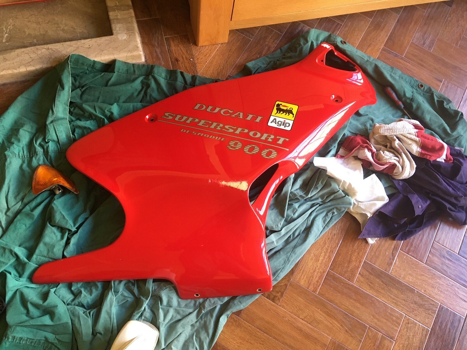

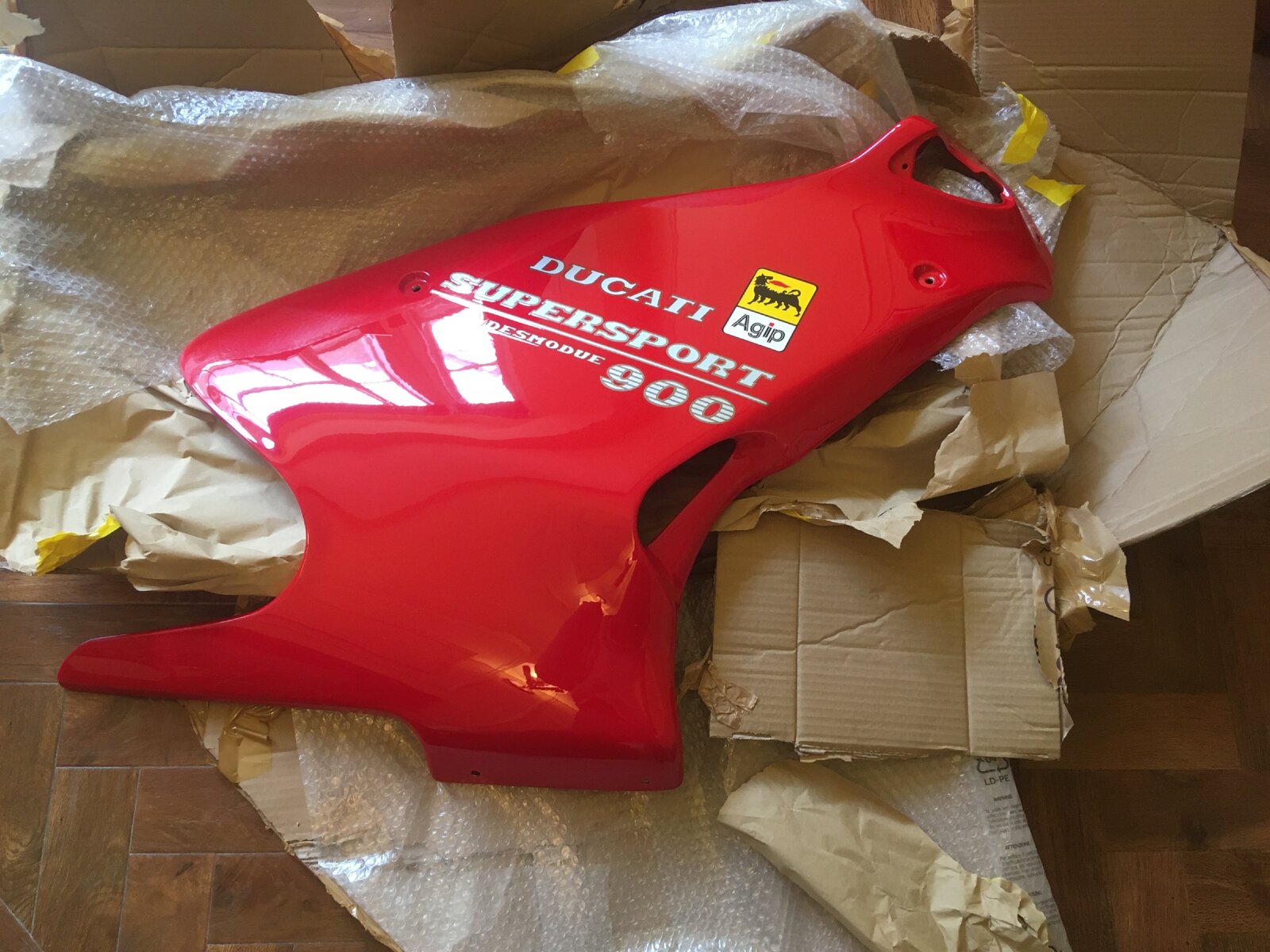

  11. And right side fairing, £250
