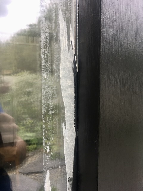

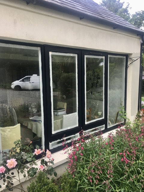

  15. Sometimes I hate masking tape :mad:. I masked ALL the windows of the house, then painted all the woodwork. Dodging showers and with intermittent bike rides when it was sunny, it took a few days. Would the b’stard tape come of cleanly? Would it f**k:mad:

  16. Use 14 day blue tape instead
  17. It's got UV stabilisers in it :bucktooth:

  19. Never does once it's got wet and dried out, royaly boils my piss at work when the put masking tape on panels to write something on it :mad:. Keep telling them to write directly on the panel 4 years and they still do it.:mad:
    I've found Waitrose window cleaner effective in removing it with reduced effort, spray on leave to soak for a little while return and wipe/rub away.
