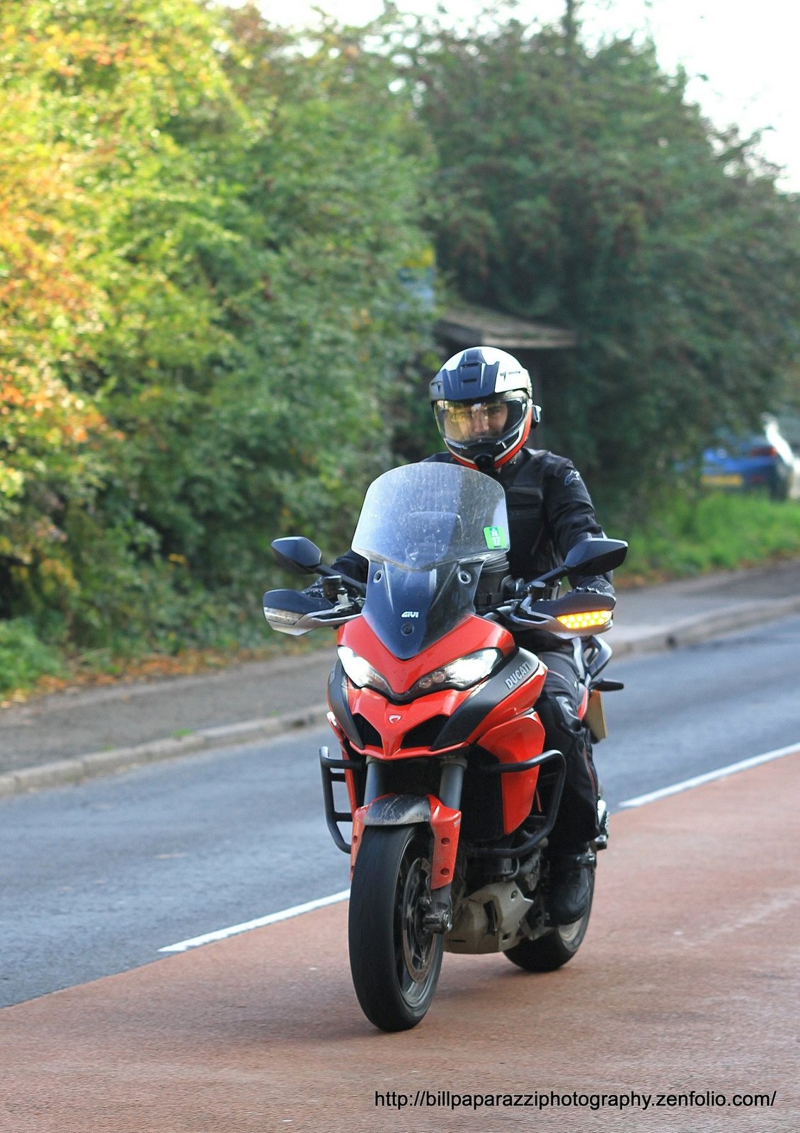

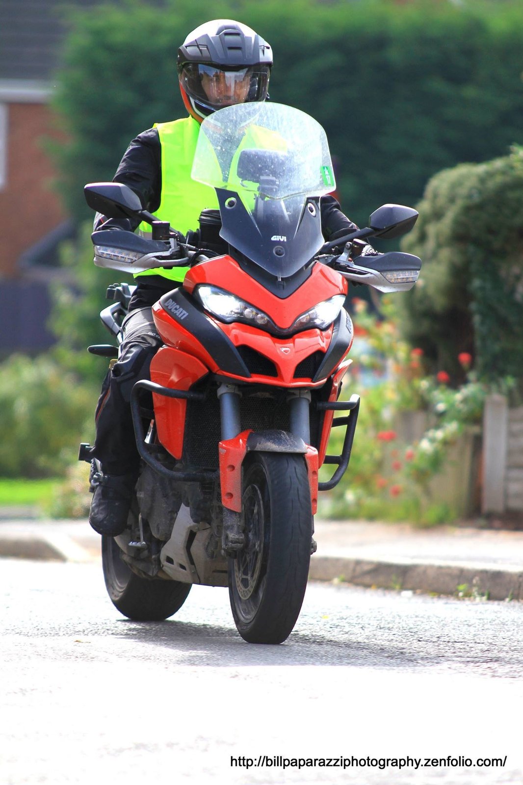

  7. I wish you lot would stop pissing around and just buy the big givi touring screen, it’s perfect!
    I’m 6ft 2 with the seat risers in, apparently it’s better without them fitted.
    It’s big but it suits the bike, and on the lowest setting it doesn’t weave, there’s no wind or vibrations even well into 3 figures... allegedly
    My mate borrowed my bike to see if it works, when we stopped at the cafe for a brew he ordered one for himself there and then.I
    High position
    Low position
