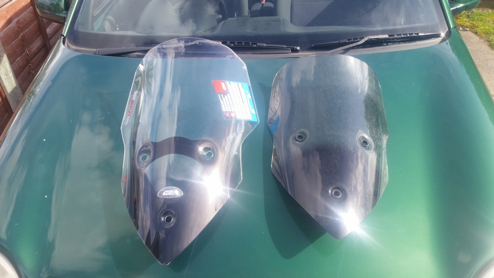

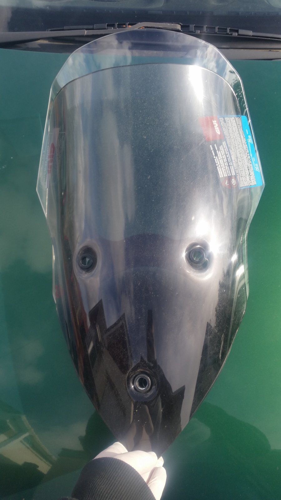

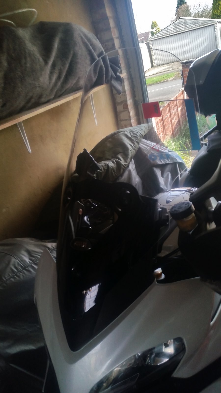

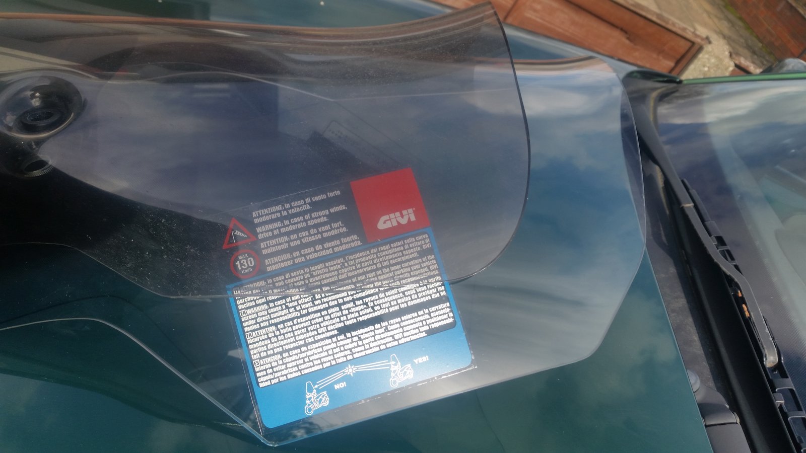

  4. I just bought the Givi screen and it seems allrght on the motorway in fully down and fully up positions . Only tried for 20 miles so far . There is less noise and much less buffeting , but there is still noise so it doesn't eliminate all the problems . I'm happy with it and will stick with it ,but will try a Palmer if one comes up here or on Ebay . 2018-03-16 11.42.52.jpg 2018-03-16 11.43.16.jpg 2018-03-16 11.43.23.jpg 2018-03-16 11.51.38.jpg

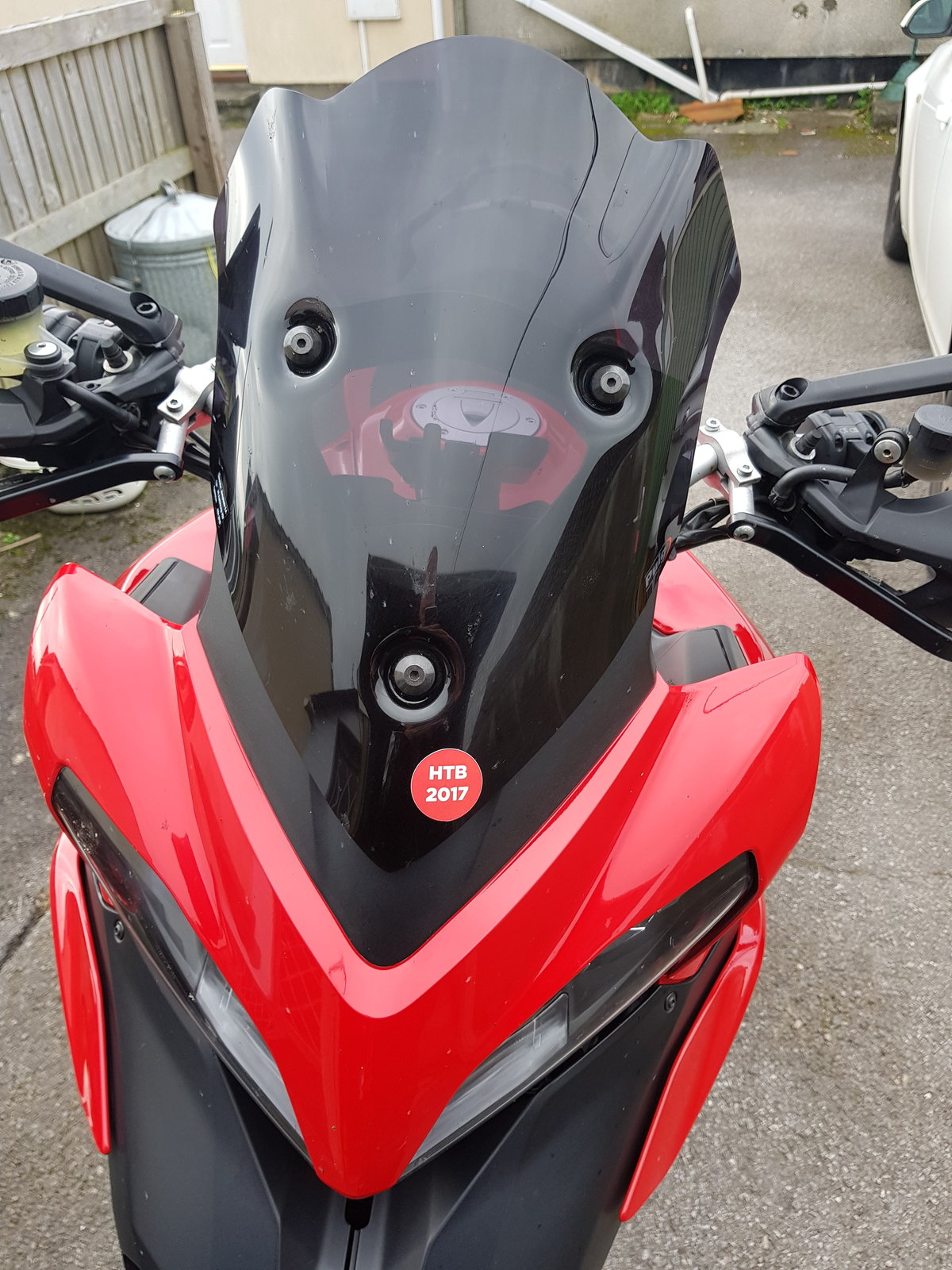

  5. I went with the Puig sports screen , I am 6ft and have found this works for me.
