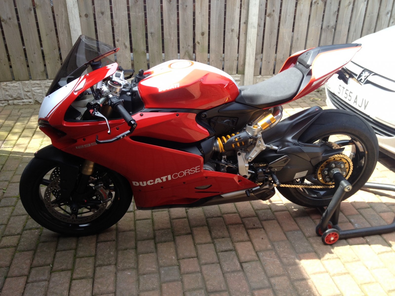

  1. Sounds good that mate, although personally I'd probably be more inclined to spend money/change the year shocks than the forks...

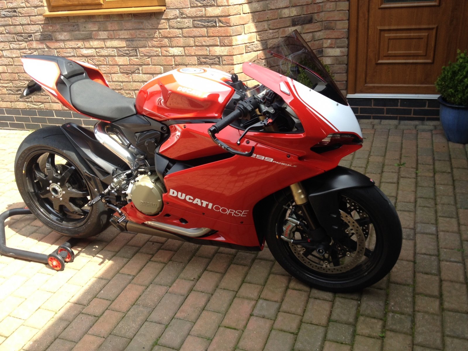

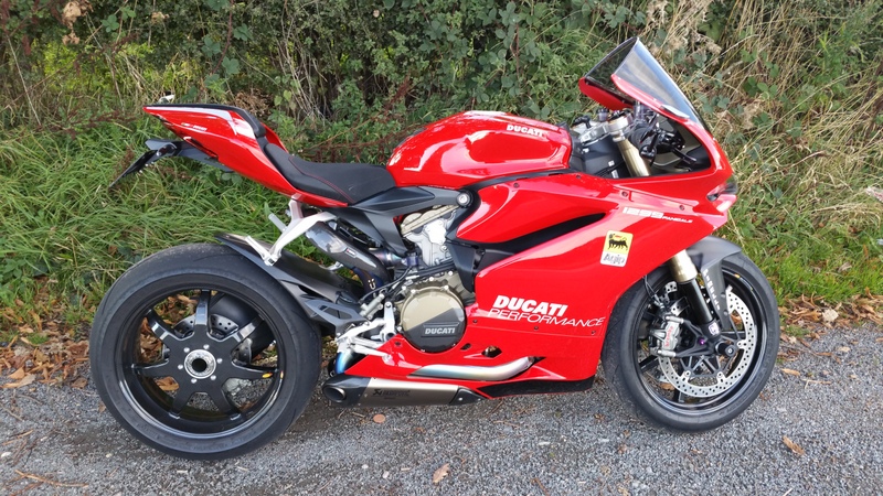

  2. Something like this then ? ....

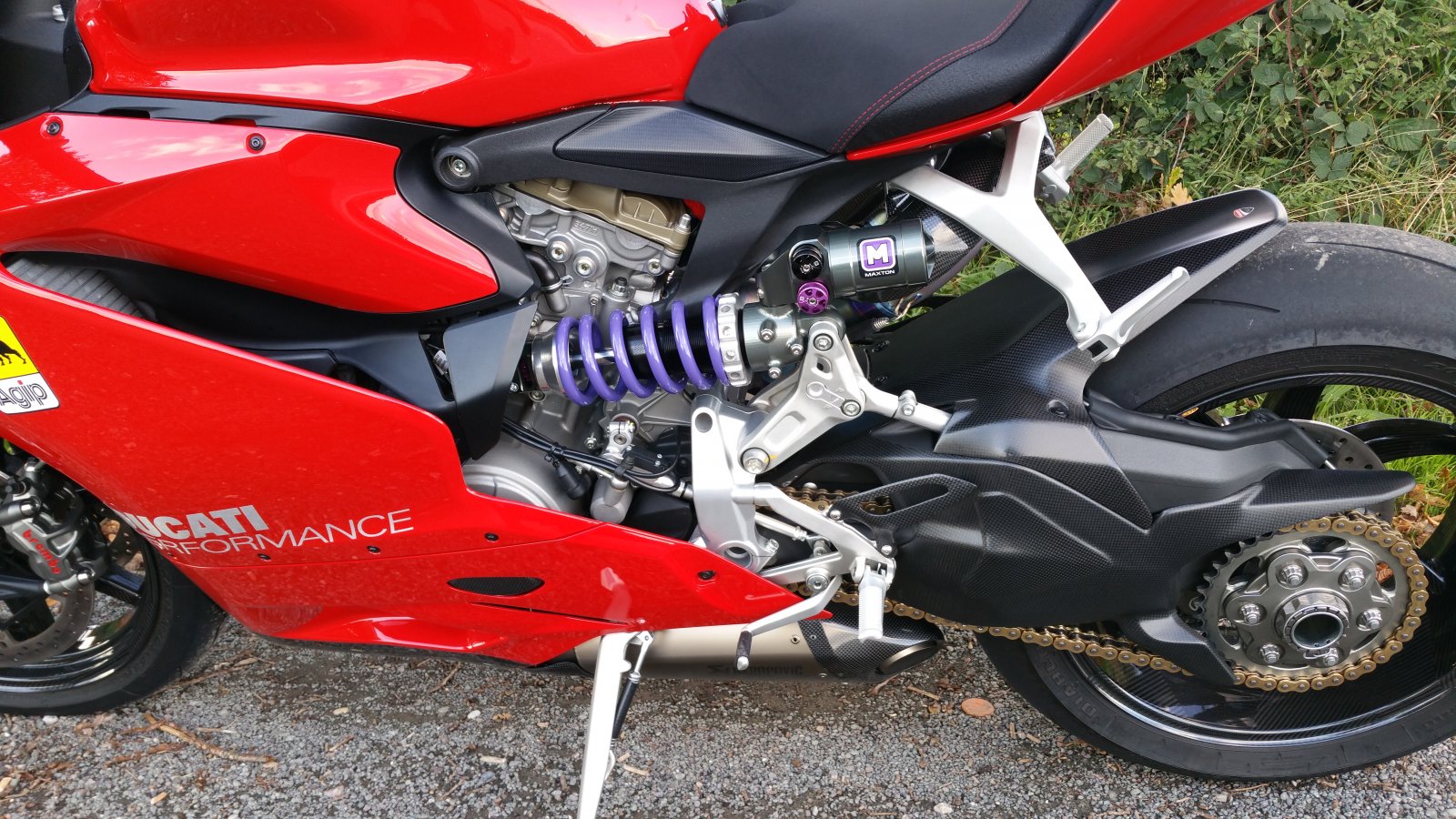

    Developed this from a new base as a pure road bike with a little two-up riding in mind (Mrs loves a spin in the summer months). Rapid Bike module is a very worthy investment. Maxton stuff built for me is an immediate improvement and the wheels DO make a noticible difference, particularly on the front. I could have bought an R for the money I've invested but I'd probably still want to do most of these mods to that bike too to make it ride like I want...Love the creamy torque of the 1299 with the exhaust and rapidbike and all the bits can come off and be sold if I ever decide to move it on or P/X

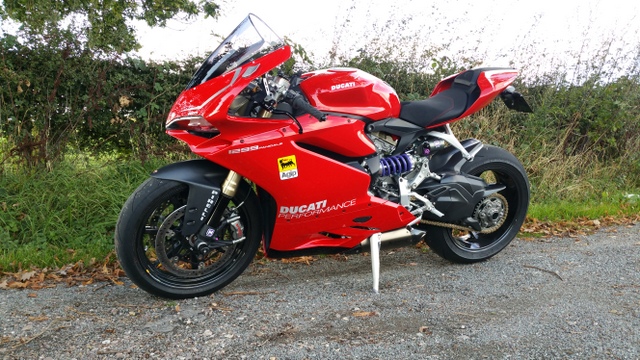

  3. Here's another one cos I can't decide which side looks best :grinning:

    @steeley that really is great looking!, I'll be adding some tasteful decals to but won't be making it an R look-a-like! How do you find the maxton shock? IMO for the road Maxton kit is really as good as you're going to get, on track the top end Ohlins or K-Tech stuff maybe edges it out. Was going to ask Richard to do a black spring for me if it was possible.

  6. Suspension is a really subjective thing and there are people out there that are genuinely happy with the standard set-up and that great but for road riding I found both the back and front too harsh (and I'm no lightweight) and when you try to soften them up with the preload, the damping adjustment and limited range just doesn't give me the changes I wanted. I.E. the front fork has very little rebound adjustment from full in to full out. Richard explained this as almost a safety feature as well as cost saving by the manufacturers on O.E. forks as they don't want people with little experience of suspension set-up getting it wrong and pinging themselves into the nearest hedge !
    I'm no expert, but it's easy to feel the difference in setting changes with proper damping circuits like on the hand built Maxton stuff, I think their TT experience rewards their road set-ups. 20161002_163818.jpg 20161002_163818.jpg 20161002_163818.jpg
    As far as quality goes, this stuff is top end..... end of story..... and machining quality is actually better than all but Moto GP/WSB quality Ohlins stuff. K-Tech is of equal sex status on my CNC-ometer.
    I'm quite happy to fly the purple spring flag for Ron, Richard and Mary and all the boys at Maxton. This kind of Company is what I would like to be involved in myself in another life :upyeah:
