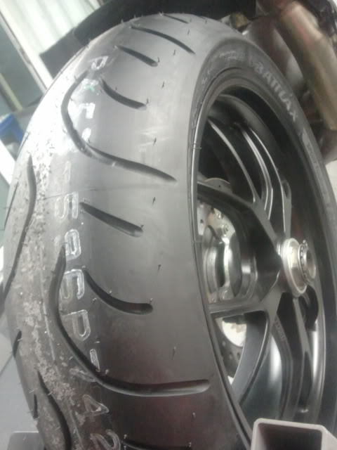

  1. Why did u change to 55 profile though out of interest? Does the 1199 in question also have any different profile to OE fitment?
  2. I wanted a tire with proper wet grip so fitted Michelin Pilot 3's. Only available in 55 profile rear.
    Have spoken to Dunlop this week and have been told that their Sportsmart 2 is out in a 60 profile rear will be available in 5-6 weeks time. They are pretty good in the wet so that would be an alternative. Must say though they are in the same league for wet grip as the Michelins.
    i think the the 1199 had a narrower rear but pretty sure the profile was std.
  3. Coincidently yes different profile tyres.
    Maybe something in it?

  4. Hi there.
    Yes, mine ran 200/55 tyres and 190/55 tyres. It did this when on 190/55. Cerec1's did this on 180/55 not 180/60 tyres.
    But as I am quite good at maths, I will simply ask the good people at Ducati to explain to me the formula governing this ECU intervention, and the relative impact on this calculation that changing one rolling circumference for the other makes in both instances.
    As long as the result of this change alone is a sudden acceleration rather than engine braking result, then I will be convinced and say nothing more about it.
    It isn't the tyres. If it were, then that clearly needs addressing too. I will find some answers and let you all know. In the meantime, I would only suggest that the gear position indicator jamming on "gear 1" is the red flag event.
  5. If the 1199 had a narrower rear then it's profile will have also changed, as a 200/55 isn't the same as a 190/55 (the profile is a ratio of the width). I can see why u wanted a more all weather tyre. I have super corsa's on my 848 and there no fun in the wet.
