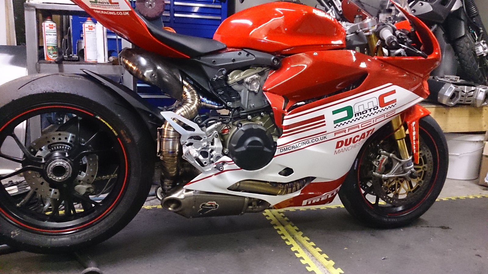

  1. Thanks for the comments, price has not been finalised yet but should be around half the price of the rs system and nearly half the weight ;-)

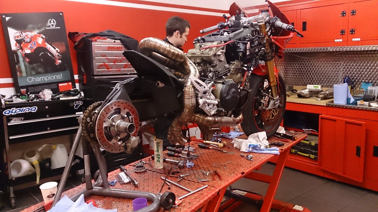

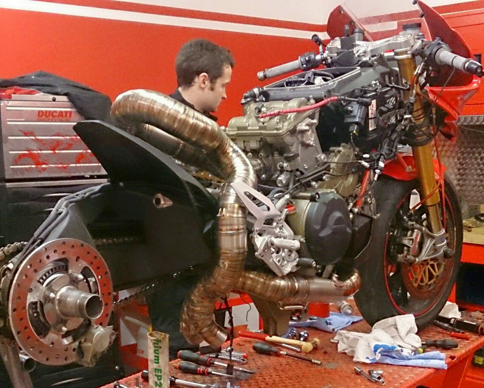

  3. Pani in for service and prep at Ducati Preston (Dmc) ready for Dyno work. ;-)
  4. WOW, Just WOW!!!
    Amazing quality and workmanship mate. Will be interesting to findout how much and the rwhp compared to the only other Full titanuim 1199 system (Akrapovic) ;)
  5. Thank you for the feedback.
    Dyno testing will be completed on Thursday so I will post the graphs.
    The system is Rs style with longer primaries so the system comes outside the swingarm but still using termi's until the Storm panigale silencers are developed.

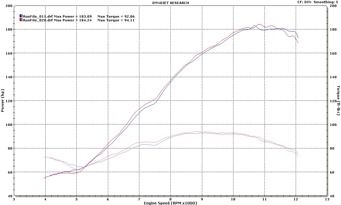

  6. Storm 1199 Panigale rs titanium race exhaust Dyno results :)
    Significant improvement between 4500 and 5500 rpm and holds the power curve at maximum rpm.
    The first graph is between the factory Rs termi and the Storm rs.
    The second graph shows the termi system with termi race silencers (black line) against the Storm system again with race silencers (plotted red line) note the huge mid range improvement.
