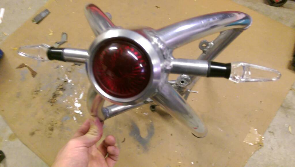

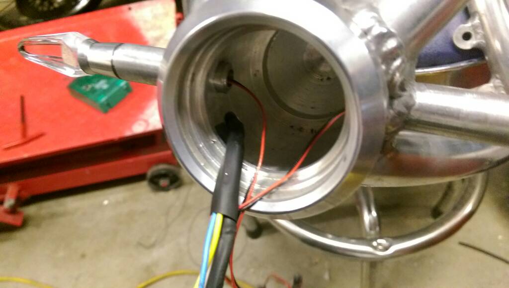

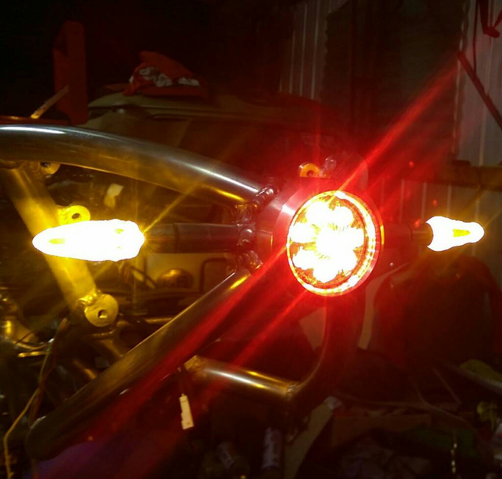

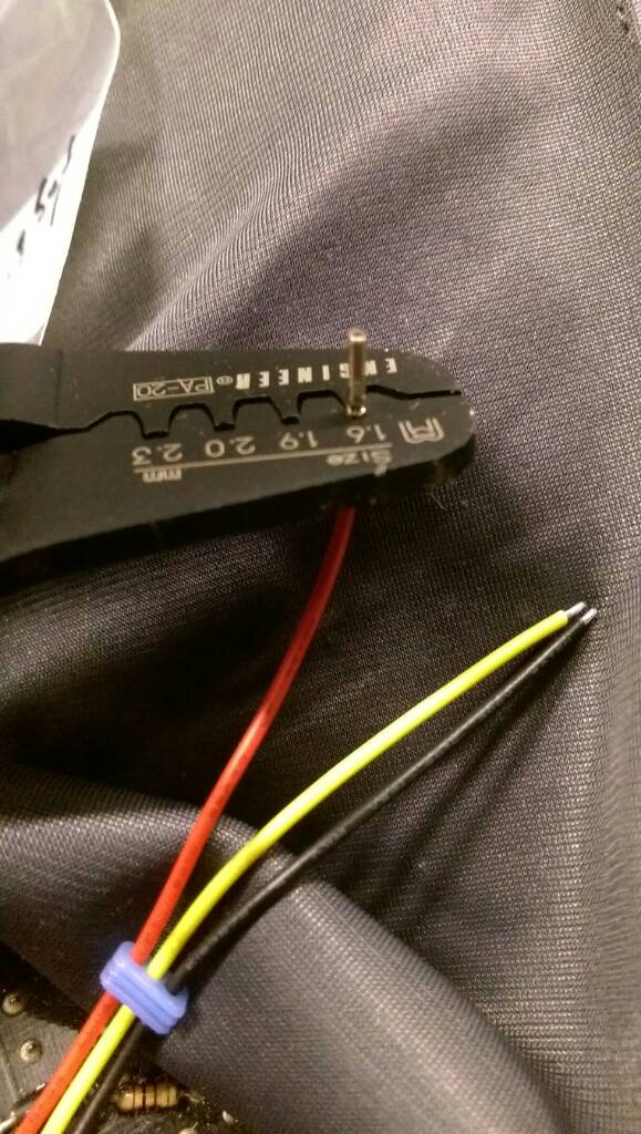

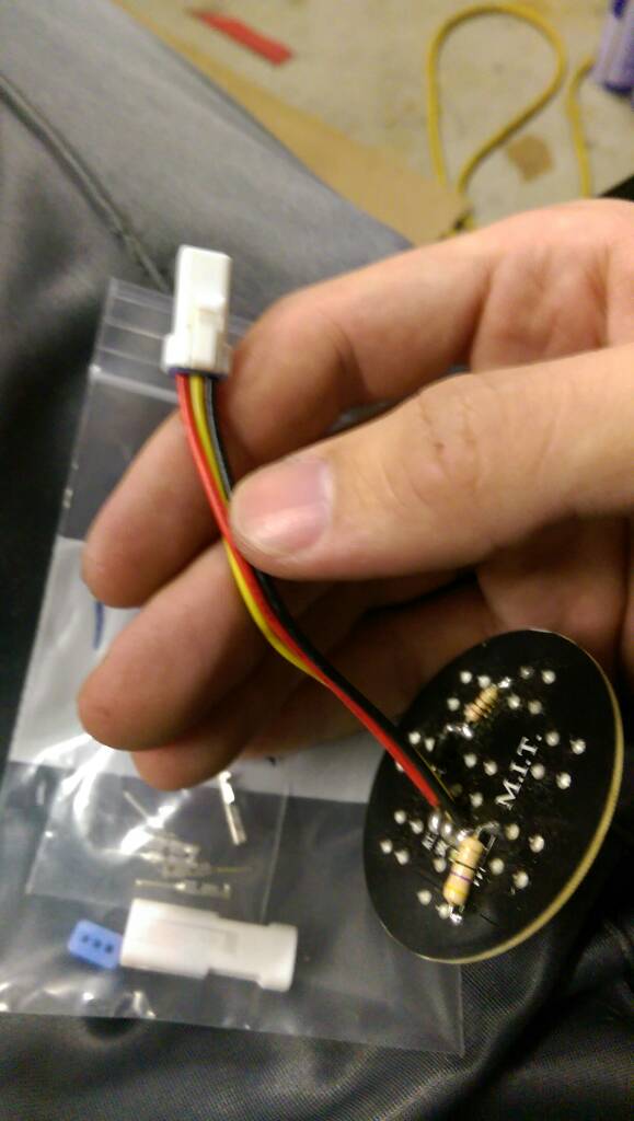

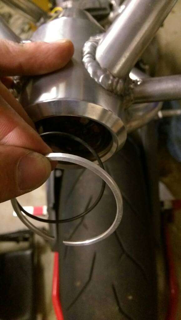

    Installing the tail lights. Using the same stock connectors, just re-pinned
    All the wiring in the frame is internal
    Machined a snap-ring from aluminium to hold the tail-light in place

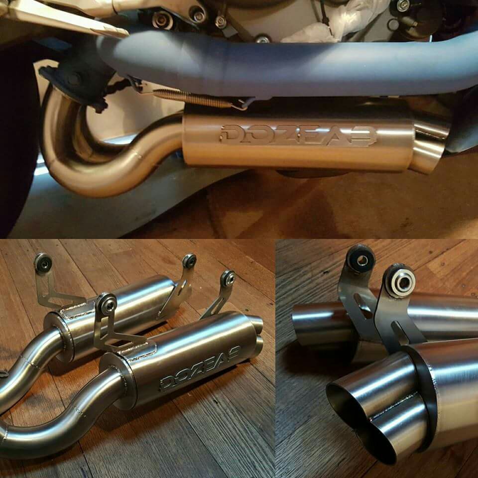

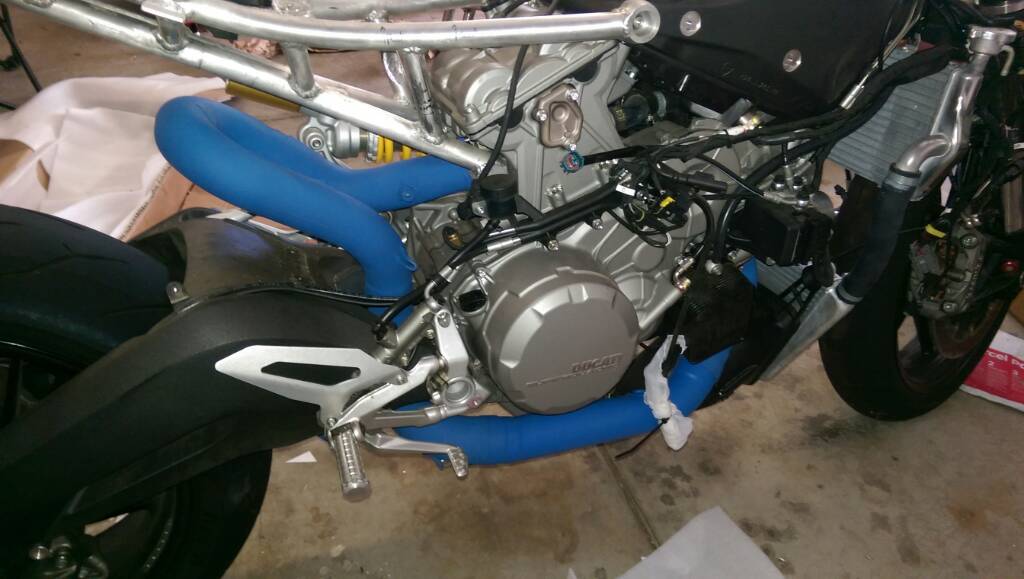

    Got the exhaust back from ceramic coating
    Then sent the bike off to get it's forward facing exhaust made up...
    It looks like this...

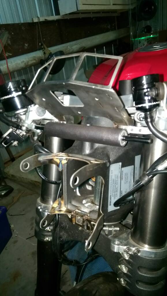

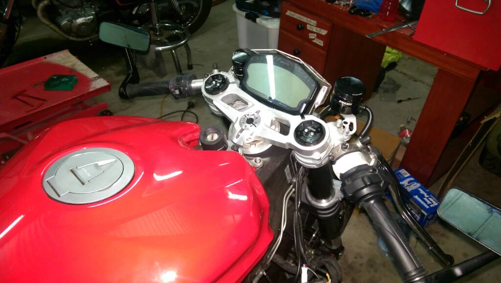

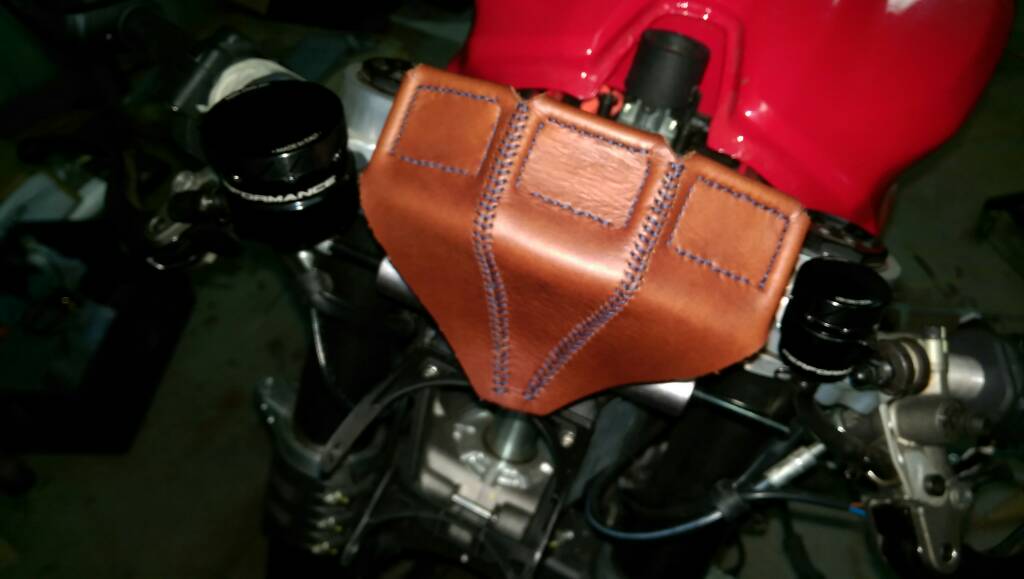

    New headlight and dash bracket goes on
    Stock dash fits perfectly

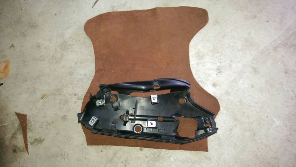

    Made a leather cover for the dash bracket and stitched it on.

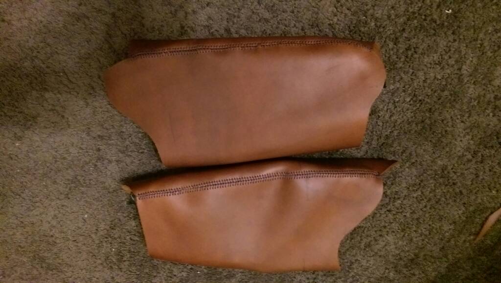

  5. Right.... stitching leather sucks balls, hairy infected ones...
    But you gotta do what you gotta do...

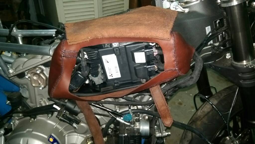

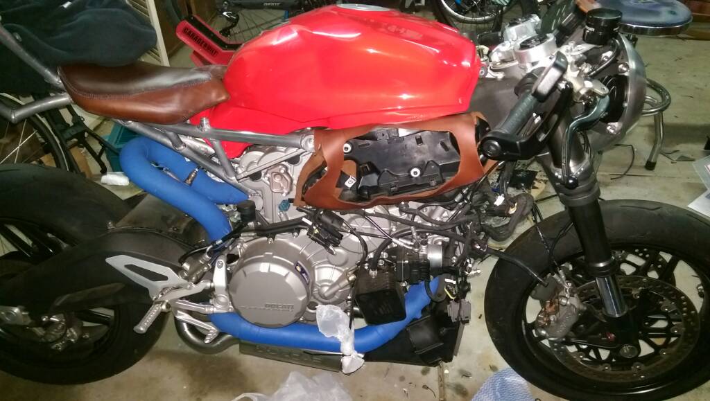

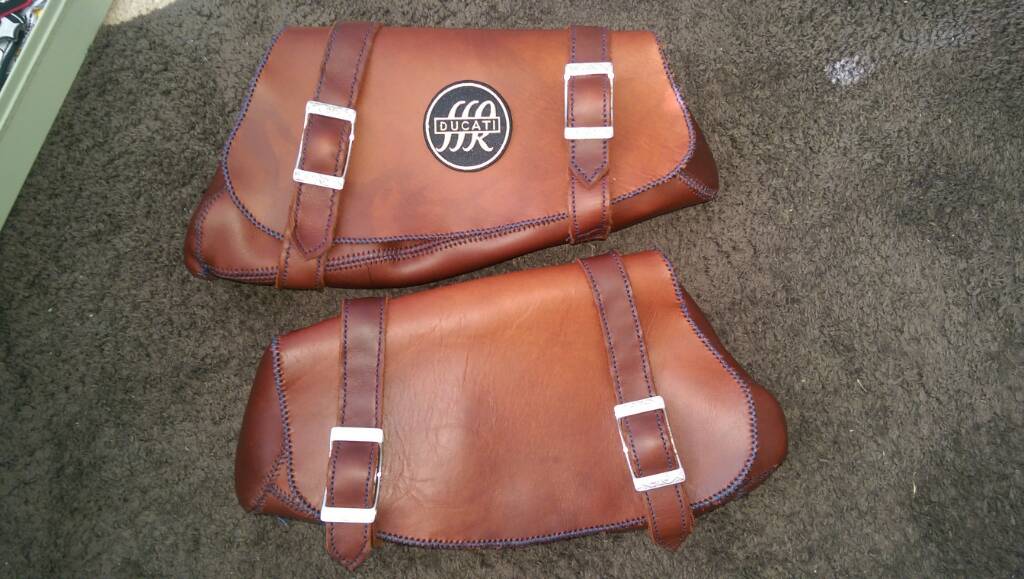

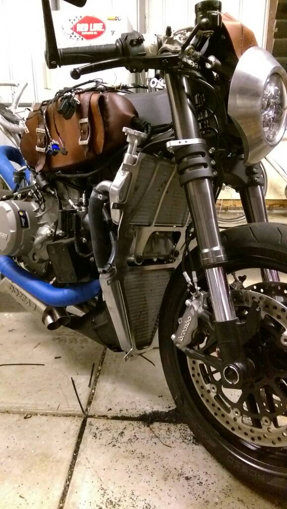

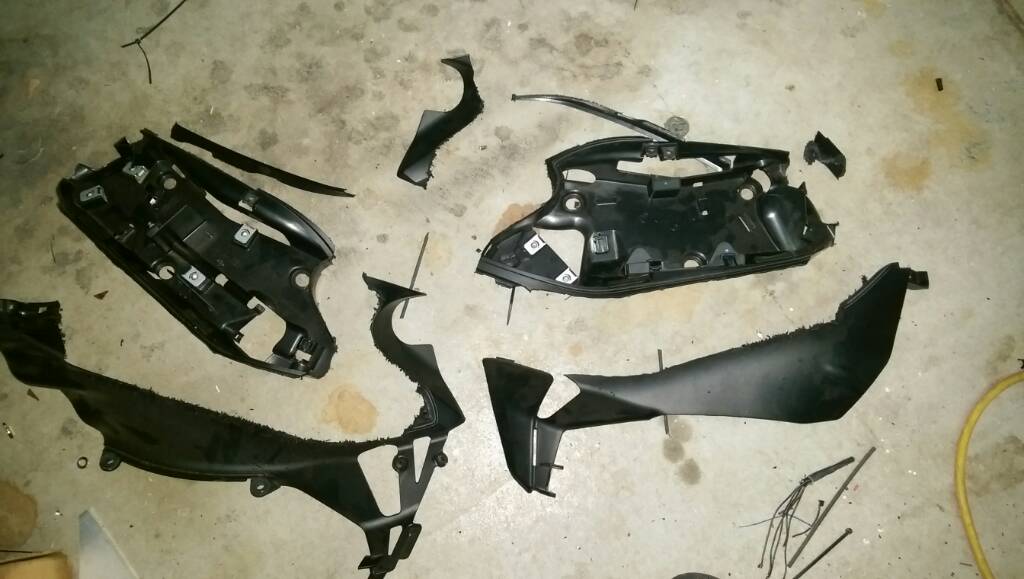

    The problem with most panigale naked builds is what to with the electrics... here is my solution... make some "saddle bags"
    Stock electrical trays with the extra bits cut off (only irreversible MOD on the whole build)
    Test fit
    Finished product
    Everything where you expect it to be
    ...always try to keep servicing in mind.

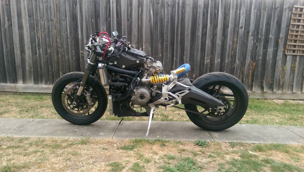

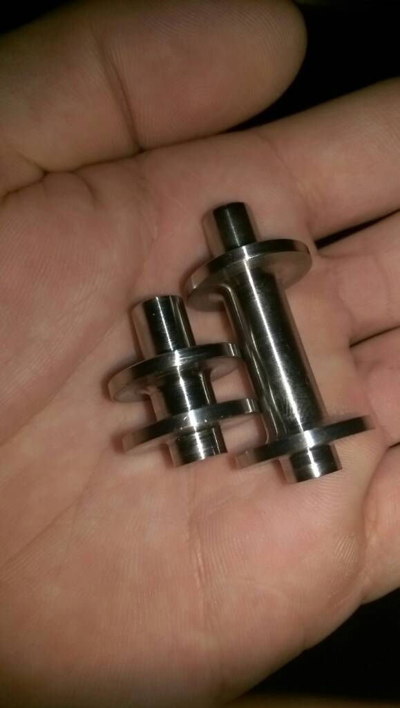

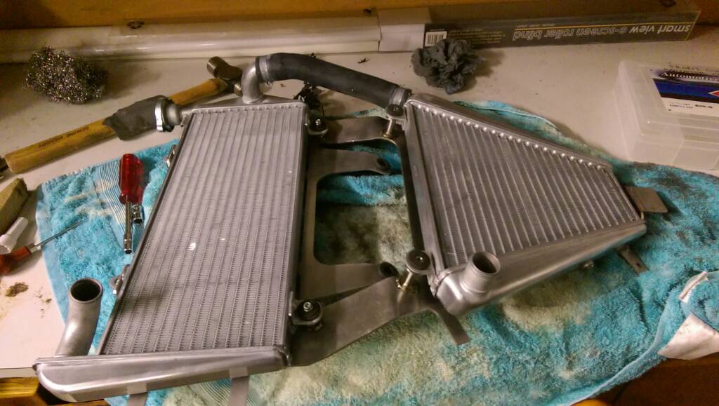

    CNC spacers for the radiator support
    Set-up and ready to go
    On the bike
    Total spend
    $2500
    Hrs
    Lost track... ~350
    Time to build
    8 months

  7. Don't know of his is a ridiculous comment to make or not, will you not get back pressure on that exhaust when riding?
  8. Perfectly valid question.... and yes... if I don't come up with some way to avoid it.

  16. Bracket holding a carbon wind deflector. Air will then flow around the exhaust opening, leaving the exhaust gases free to leave?
