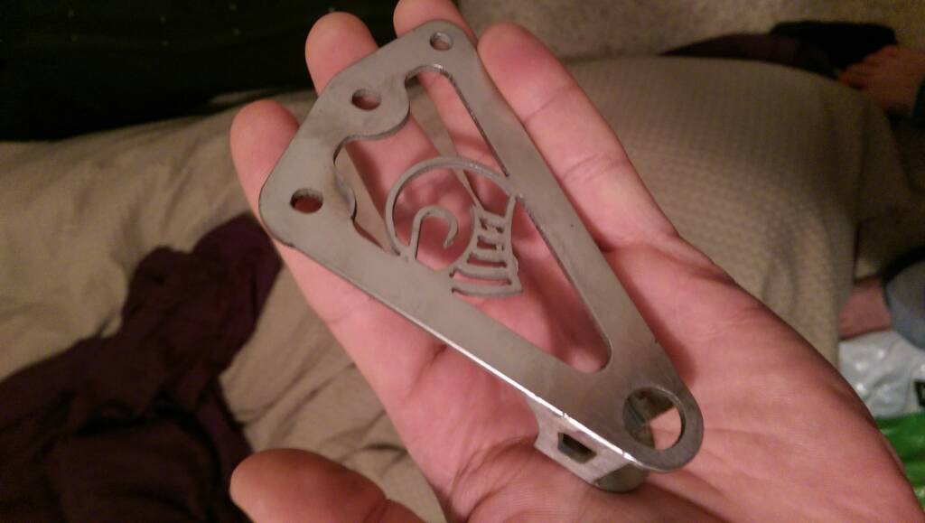

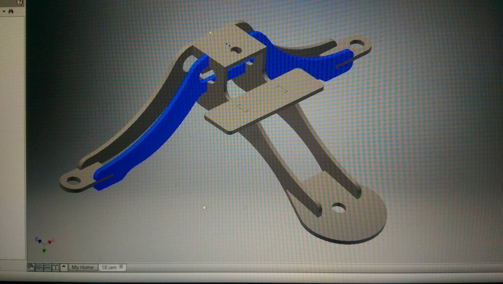

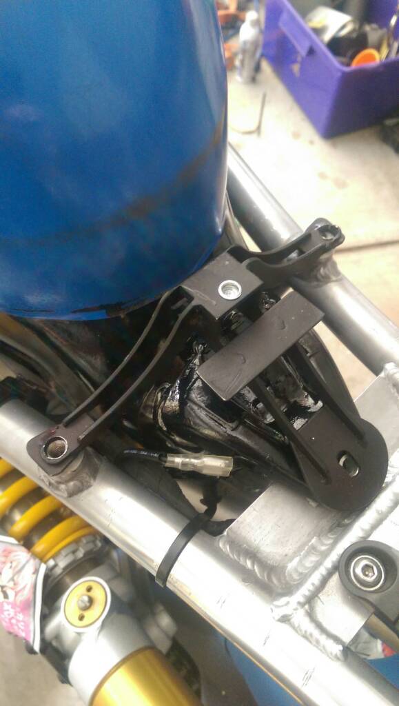

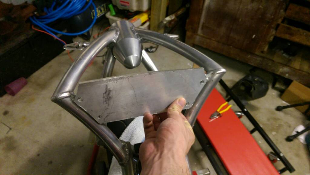

    CAD design... new seat bracket.
    Apart from having more padding the seat is an inch higher at the back and 1-3/4 higher at the front to stop me from sliding into the tank all the time.

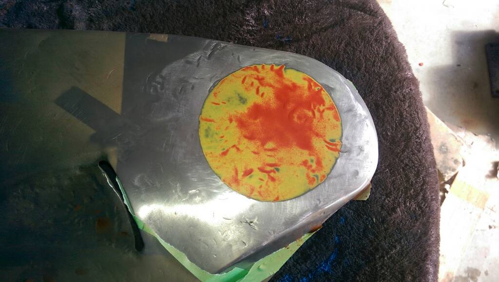

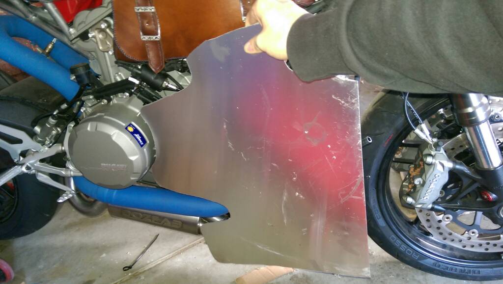

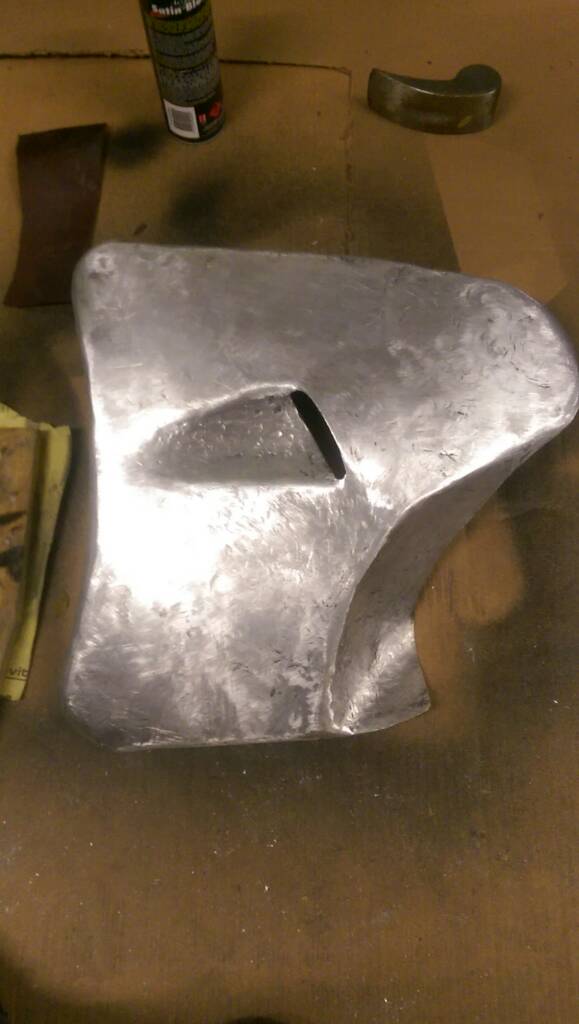

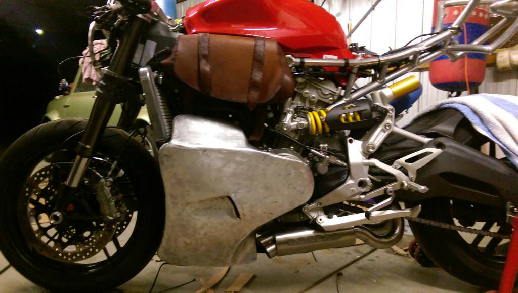

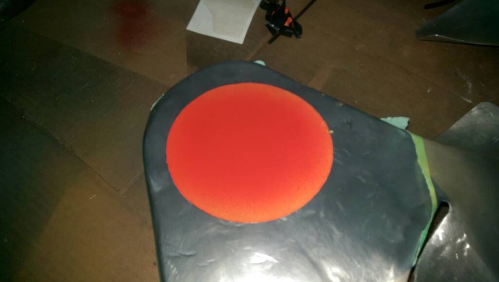

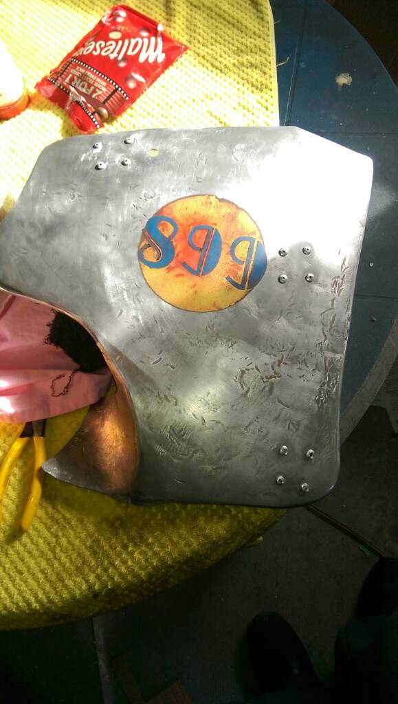

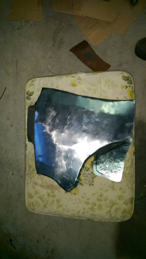

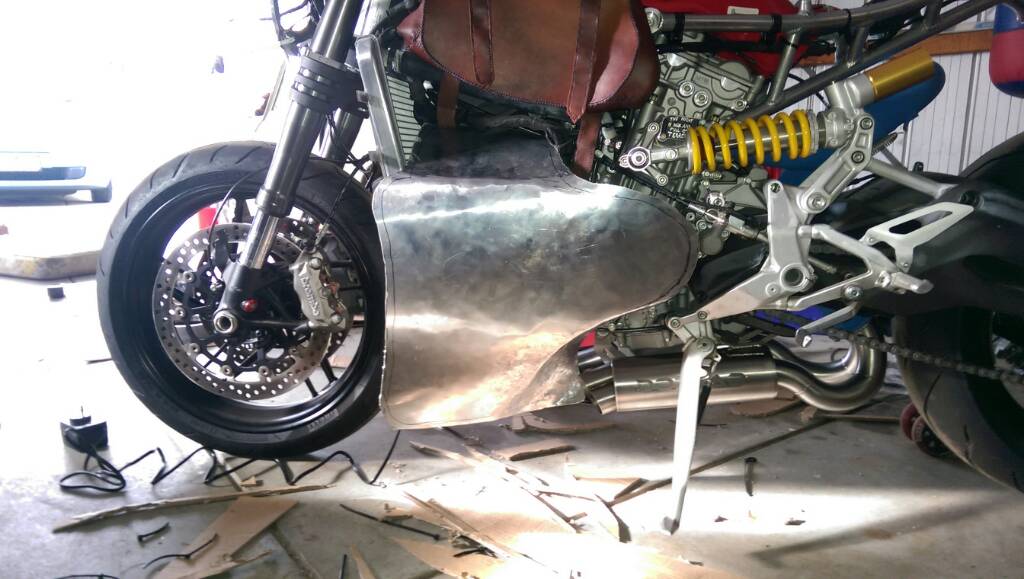

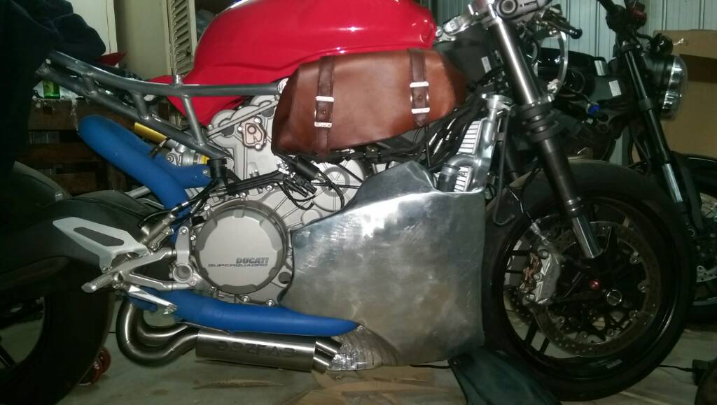

    Then I began work on the side panels. 1.6mm aluminium sheet. Beat into shape with a hammer, some dolly's and a couch cushion
    The other side
    After many hours of work
    Then paint time... I don't really care about paint as I wanted the bike to look like it was built 90 years ago, so it's all done in rattle cans
    Spray two colours
    Sand back
    Mask up
    Done
    That'll do for now

  5. Each to their own, not my cup of tea and I'm hardly in a position to criticise as most of that is out of my skill set. Is there a theme in mind, as it looks a little disjointed? The metal panelwork looks a little like something I made in 4th year metalwork.
    Not a dig at your work, I'm with El T though. But then I have a 999, what do I know about aesthetics?:nomouth:
  6. It is... now...
    Sent from my HTC_0P6B using Tapatalk
  7. There us a theme in mind, buts it's as disjointed and eclectic as you think it is. Which as far as I'm concerned is a perfect reflection of self
    The metal work is my first attempt, and will be redone during stage 2. Basically I'm not happy with it but it will do for now.

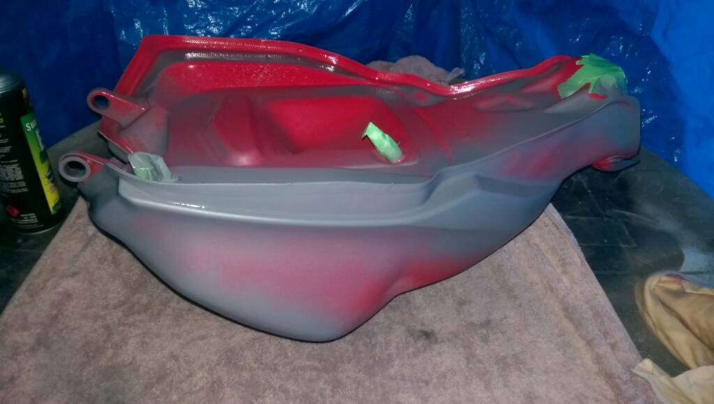

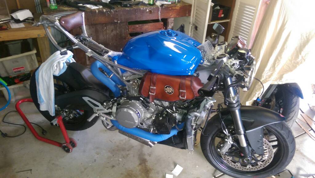

  8. Right... Tuesday update

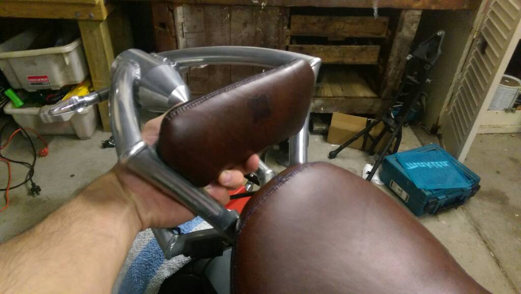

    Made myself a backrest...

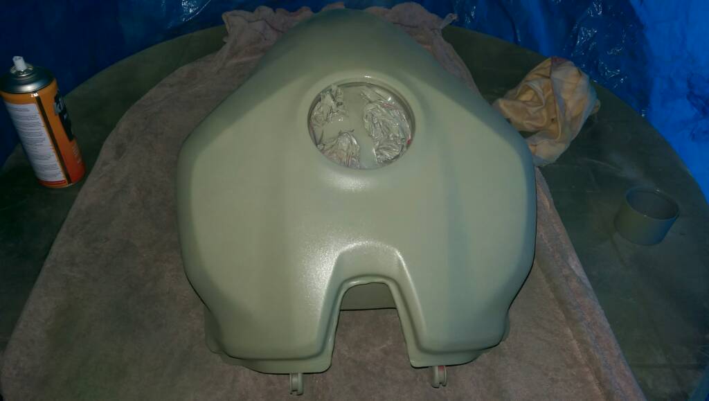

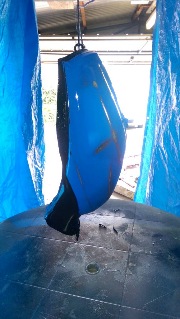

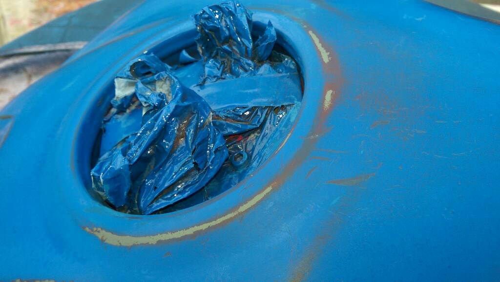

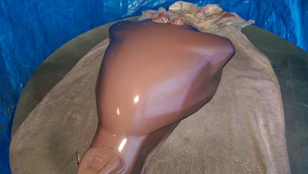

    And painted the tank

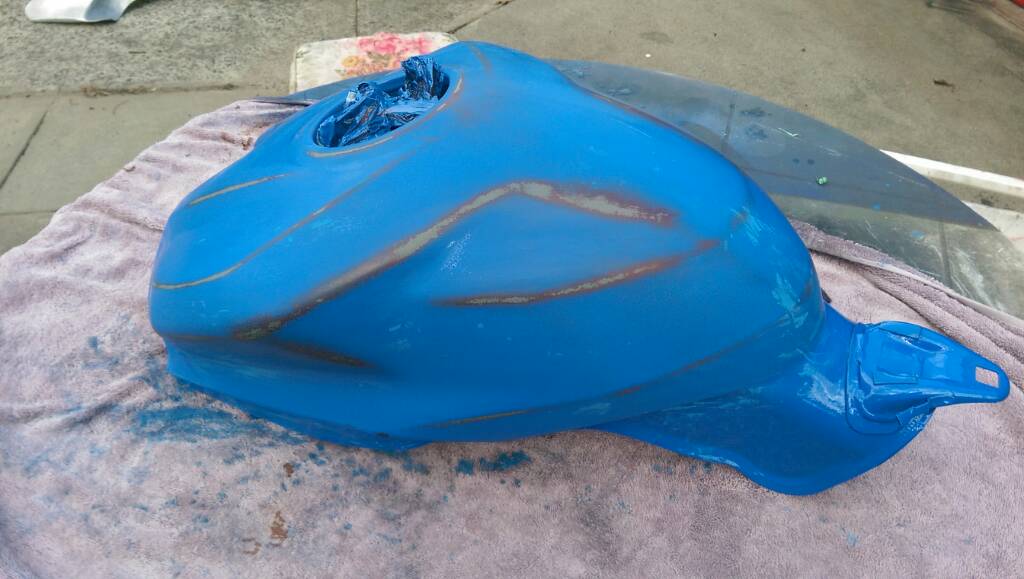

    3 different colours underneath...
    Finished with blue

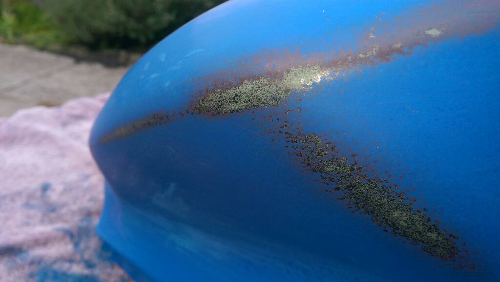

    Then sanded back to create a worn effect

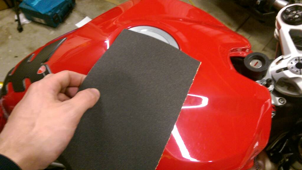

    Then black over the areas that I didn't want to stand out and a few coats of clear to finish off before hitting it with some fine sand paper just to take the shine off some areas

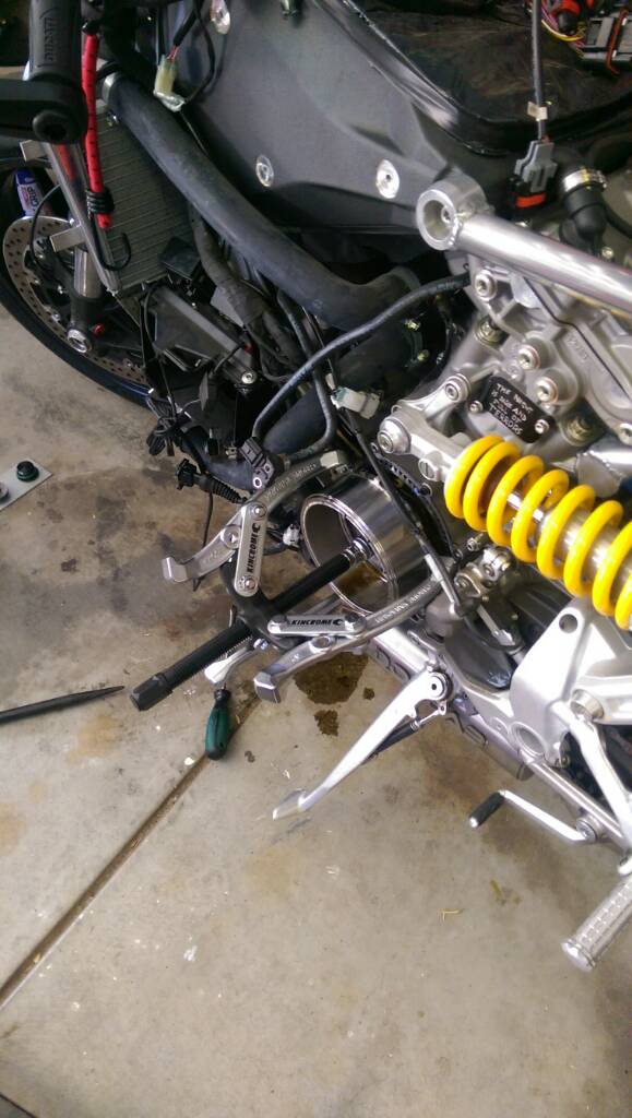

    Realized I missed posting a few "normal" mods earlier...

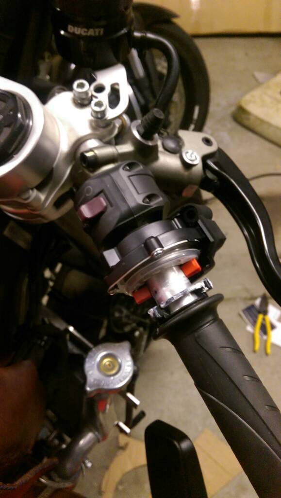

    Throttle spacer kit

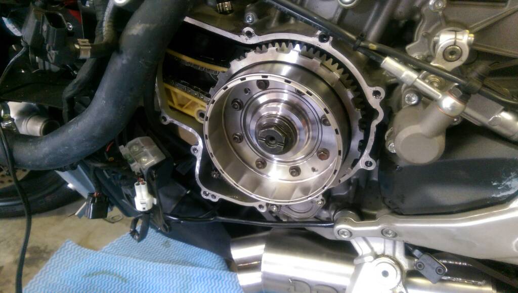

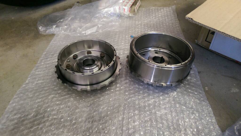

    Lightened generator kit went in
    New vs old

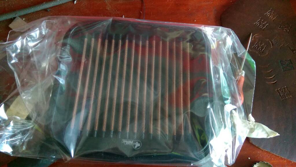

    Sprint filter ready to go with the upmap that I got from SIMMYTT... NFI how to tag people
    Total spend
    ~$4500 Aus
    Hrs
    500+
    Elapsed build time
    9 months
    Tomorrow's update will involve tentacles

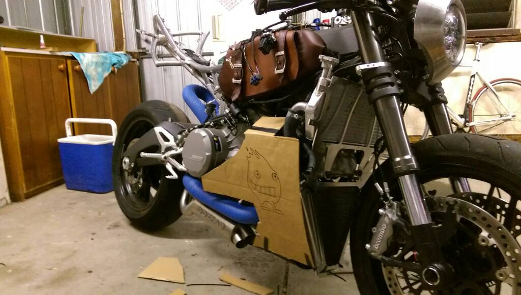

  20. I like the lower cardboard fairings instead of the metal ones :tearsofjoy:.
    Looks awesome, can't wait to see it fully finished!
