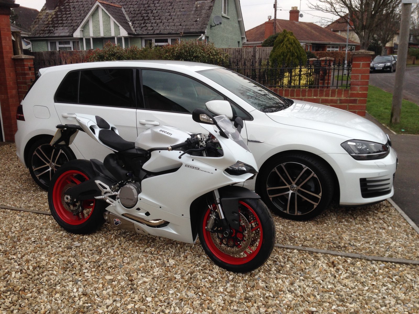

  1. Nice pair :Wideyed:,i have the same but in red
  2. The golf is a GTD. Actually well impressed with it. Did have a BMW 5 series M Sport but the benefit in kind tax was a joke. It's a nice little motor. It's no Ducati though!

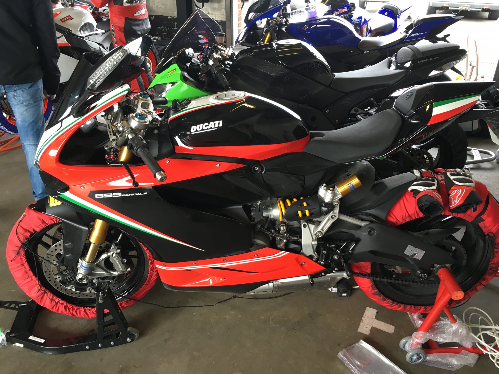

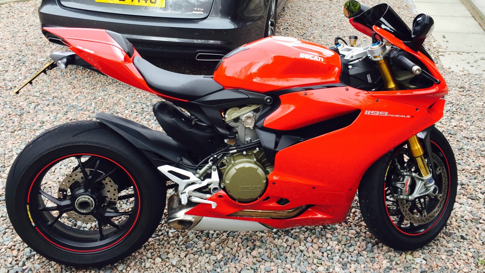

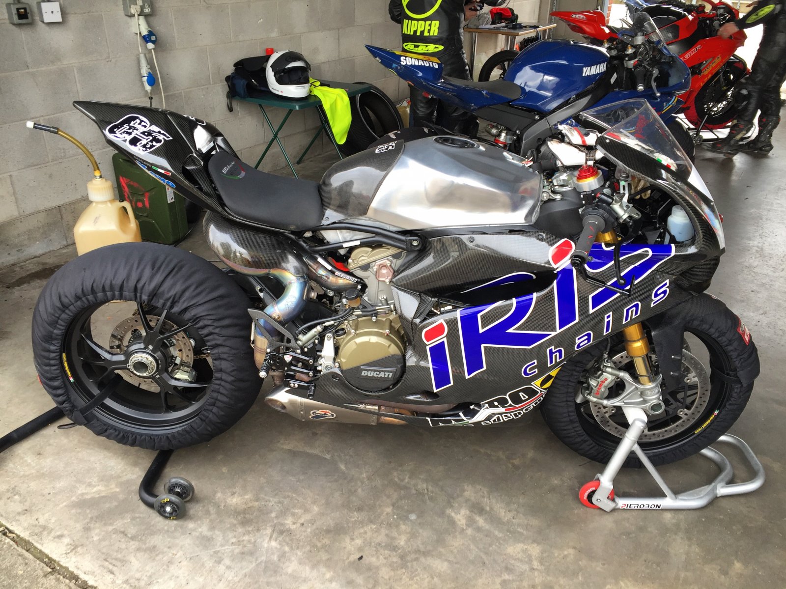

  5. my 889 at Snetterton

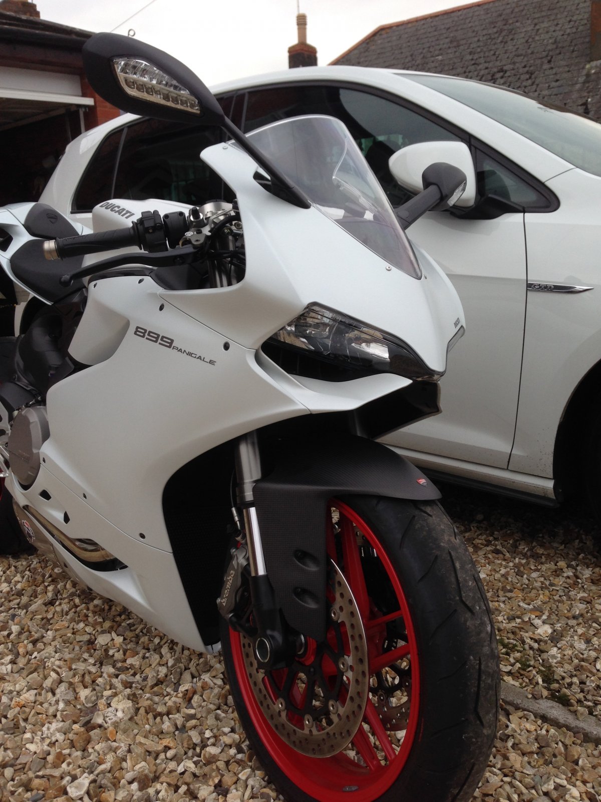

  6. If you don't mind me asking, which tyres do you find work best on track with the 899 ?
  7. To tell the truth its my first time wobbling round a track in nearly 10:screamcat: noise restriction a lot has changed.
    So i had on Pirelli Diablo Rosso Corsa which work well with the mix of weather condition at the time, but when gets abit warmer may opt for super corsa.
  8. Supercorsas for track
  9. I notice you have the Ohlins mechatronic forks on - how are you adjusted by them?

    Jan-April and Oct-Dec(ish): Decent road tyres work best as the track temperatures won't be high enough to warrant a 'compound' tyre. I've used Supercorsa SP's and Metzeler Interact K3's which have been perfect. They warm up quickly and are grippy and very forgiving. They won't have the all-out grip of a non road-legal 'racing' tyre though. You'll be using fairly high tyre pressures, probably 30PSI front and rear.
    April-October(ish): When the track temperatures are a little higher, i.e. 15 degrees plus you can then use a compound tyre to get more grip. So you'll be looking at Supercorsa SC2 rears and SC1 fronts/Metzeler K2 rear/K1 front. When temperatures are really hot you'll want to be using a softer rear and harder front, so SC1 rear and SC2 front. Monitoring and keeping constant pressures are more important here as they will fluctuate more. You'll want to be setting an initial pressure after they've been in the warmers, then check immediately after every session. You're looking at somewhere around 26PSI hot rear and 30PSI hot front.

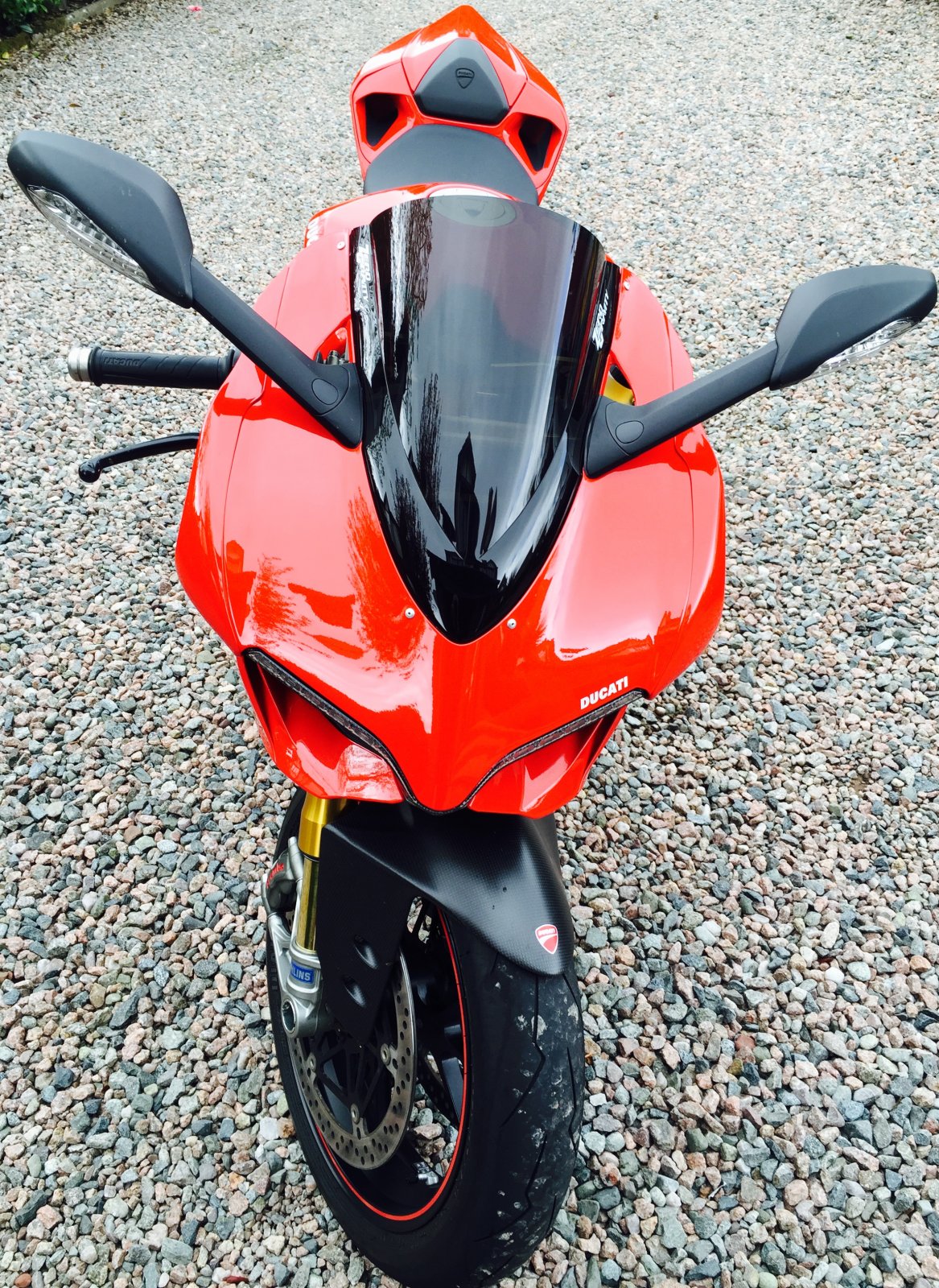

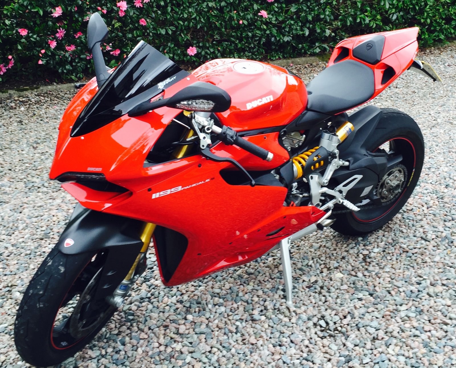

    I'm only familiar with Pirelli and Metzeler track tyres, I can't comment about Dunlop/Avon/Michelin etc etc...

  16. Almost the same here.... Just got the Golf GTE in March and pick up a 959 tomorrow. (BIK played a big part with my choice too... only 5%!). Will post a picture when I finally collect... it has been the longest 4 days in history!
