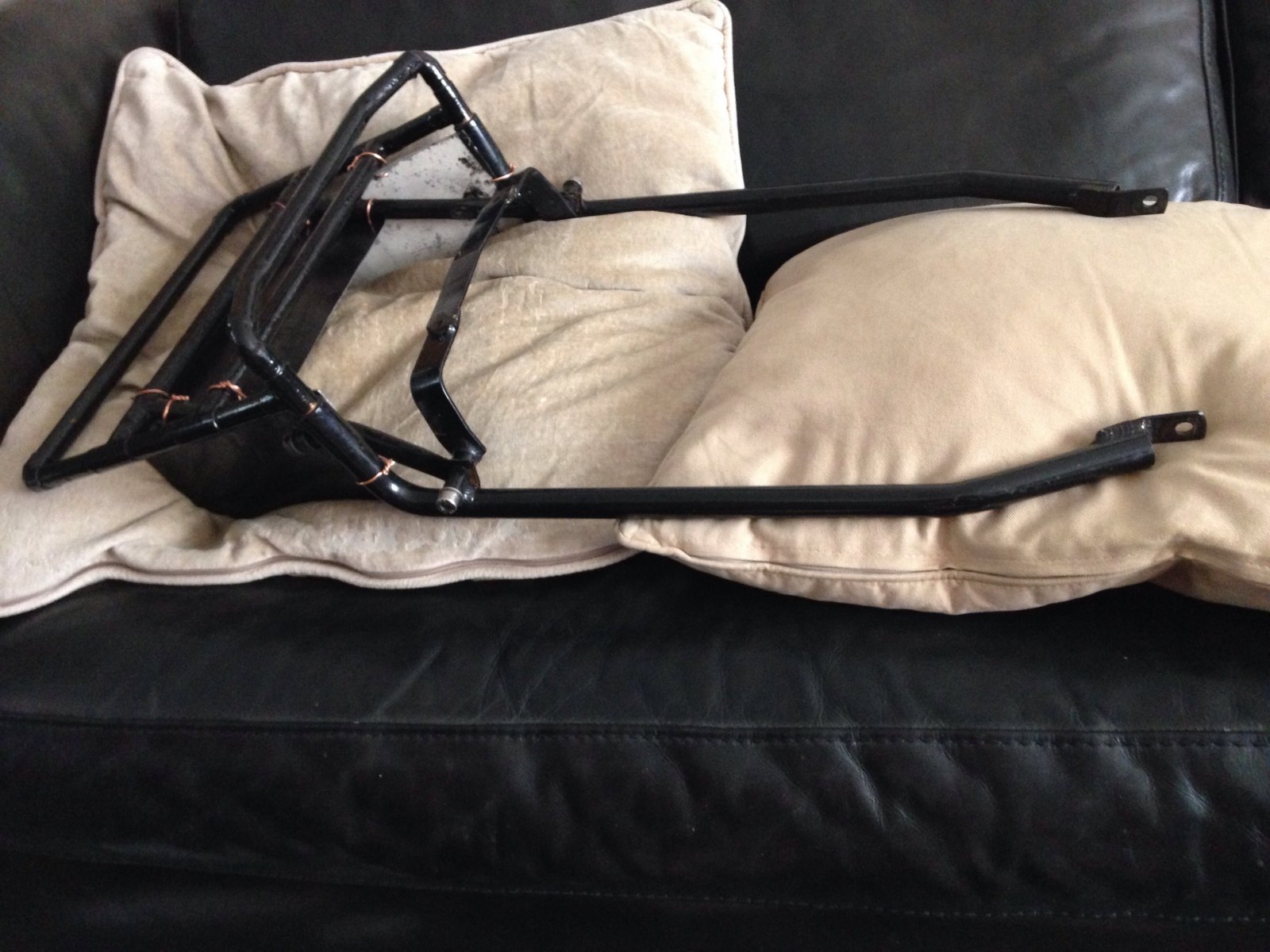

  4. Have a look at ventura kit. I got the siderails s/h for my 999bip and made a rack so that I can fit throwover panniers.

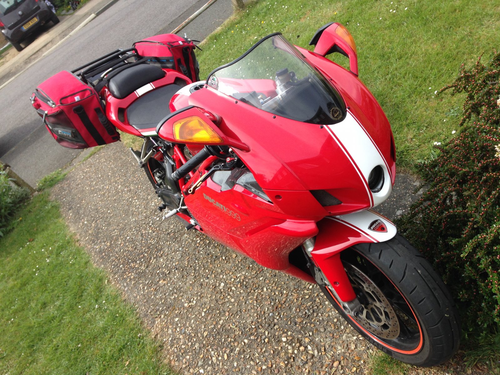

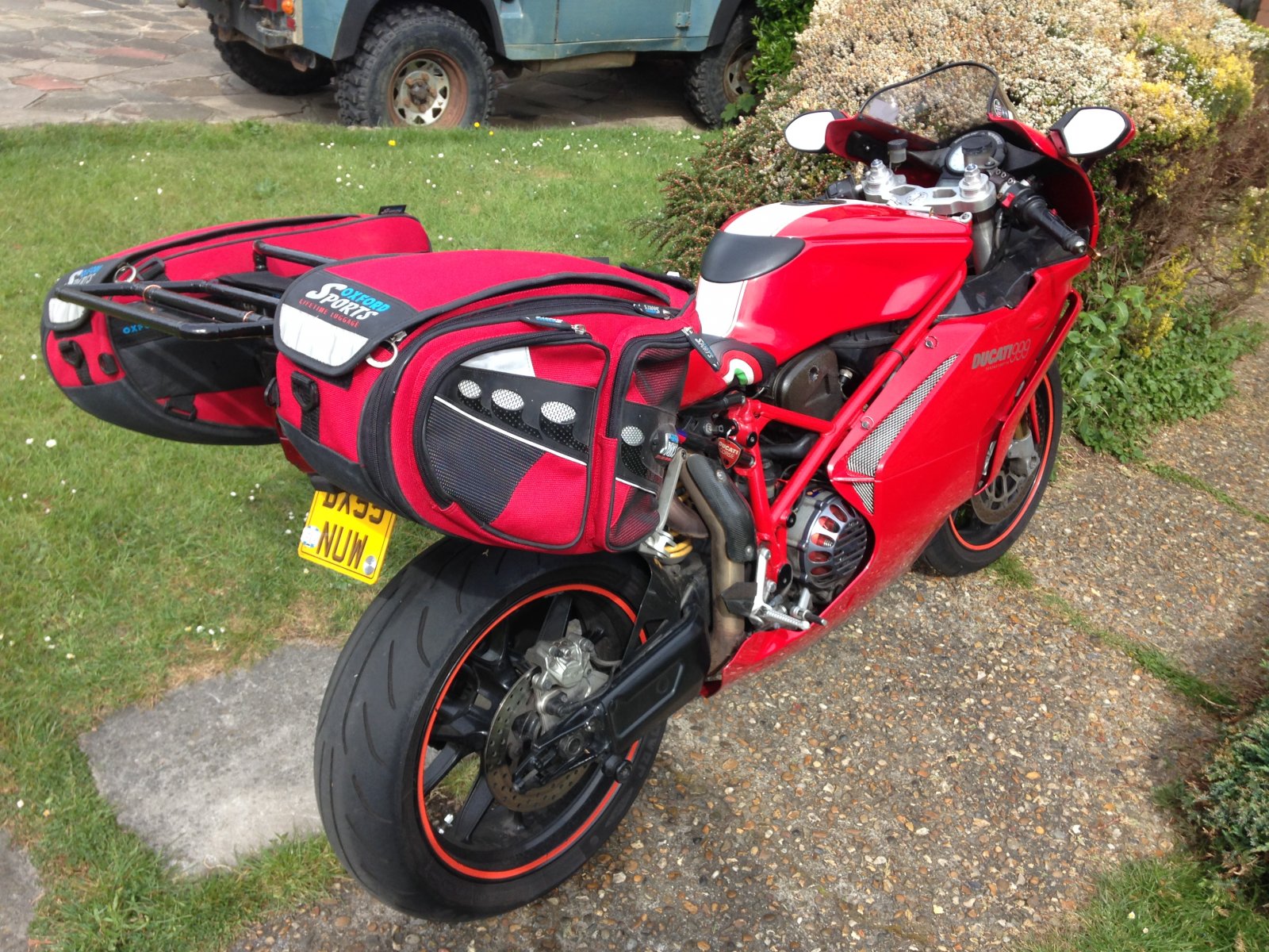

  7. image.jpg IMG_5550.JPG IMG_5551.JPG The side rails for my 999 fit to the pillion footrest rear bolt and a bracket that slides under the subframe and uses 2 bolts that secure rear bodywork. Without the rack I couldnt fit the panniers as the seat tapers at the back and they also needed to go further back.
    Rack is made from 15mm scrap copper. The fittings fit into the siderails perfectly.
  8. Nice machine and i think that those are exactly the same panniers that I'm aiming to fit to mine albeit in black, although I suspect it'll be a trickier task in my case!

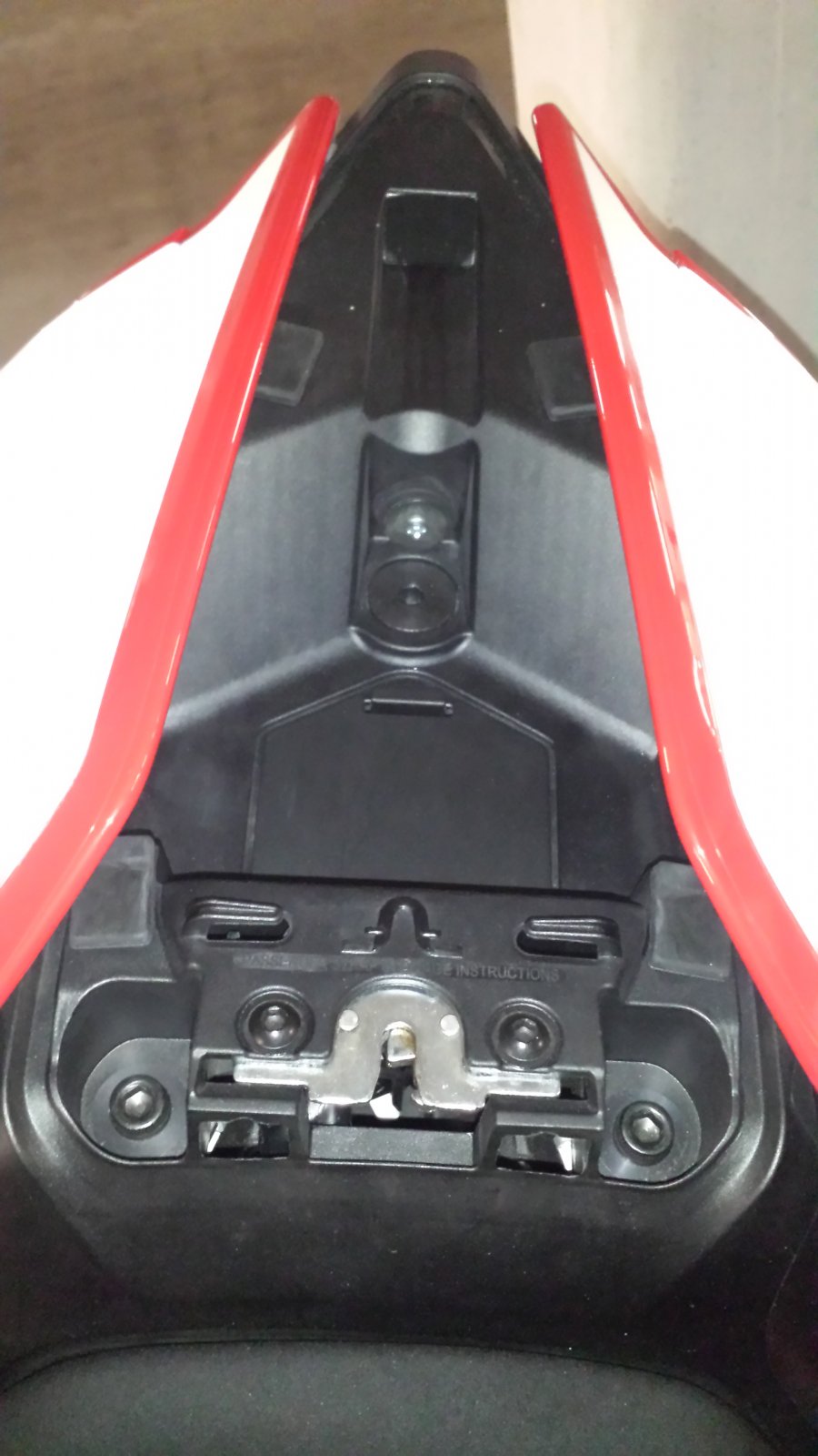

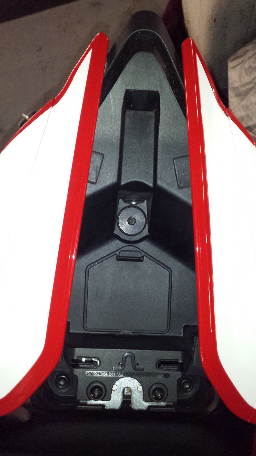

    So Emile's last post has motivated me to head on over to the top secret bunker location where I keep my bike and here are some snaps with the cowling removed. Upon closer inspection, I am now thinking that a 1299 seat might not fit as there is a considerable distance between the highest point of the exposed tail fairing and the bottom where the seat would connect up to the locking mechanism. I've never had a 1299 seat up close in the flesh but I can't imagine how it would be possible for it to slot in width wise even with the tail unit winglets removed...

  18. The 1299 pillion seat definitely will not fit on your or mine.
