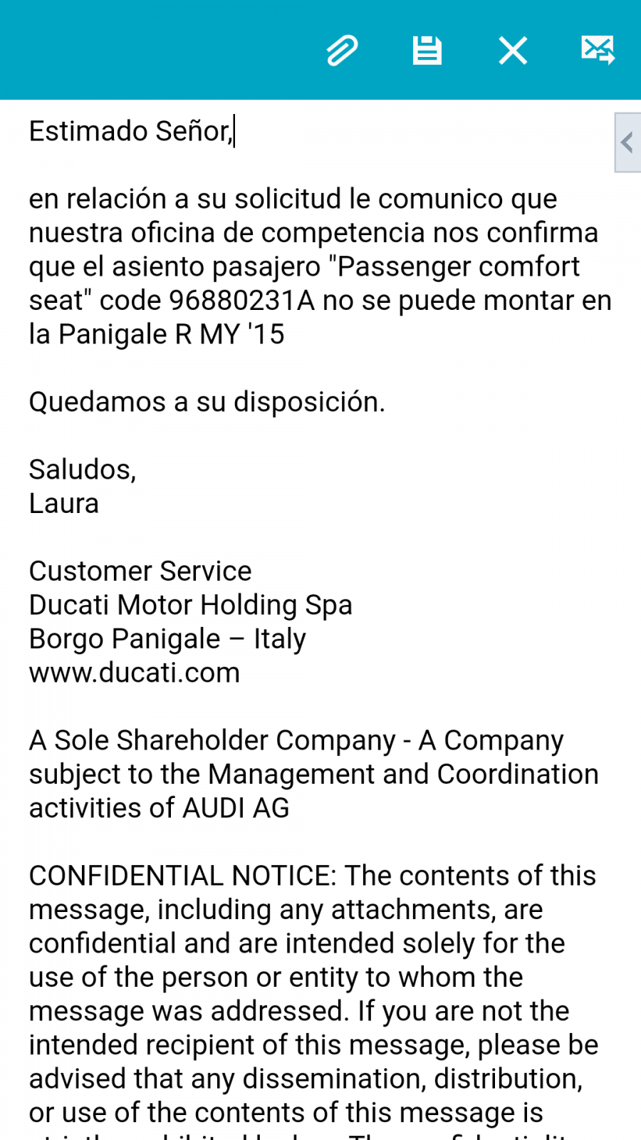

  5. So this is the latest... when I first spoke to Ducati Italy, they said that the 1299 Comfort seat 96880231A would fit a 2015 Panigale R hands down no questions asked... when I explained and pressed them a little further, they said they would check with some sort of Tech Team and get back to me... Today they've advised that a Panigale R 2015 is a single seater and that there isn't a pillion seat available for it. I've asked them if they've actually performed any checks other than reading some information off a computer screen but they wouldn't do anything other than relay the same answer to me. As one of you many good folk on this forum recently mentioned to me... "Ducati have just about as much an idea about their own bikes as the next man"... so on that note... I'll continue to delve deeper! Screenshot_2017-06-08-16-11-29[1].png

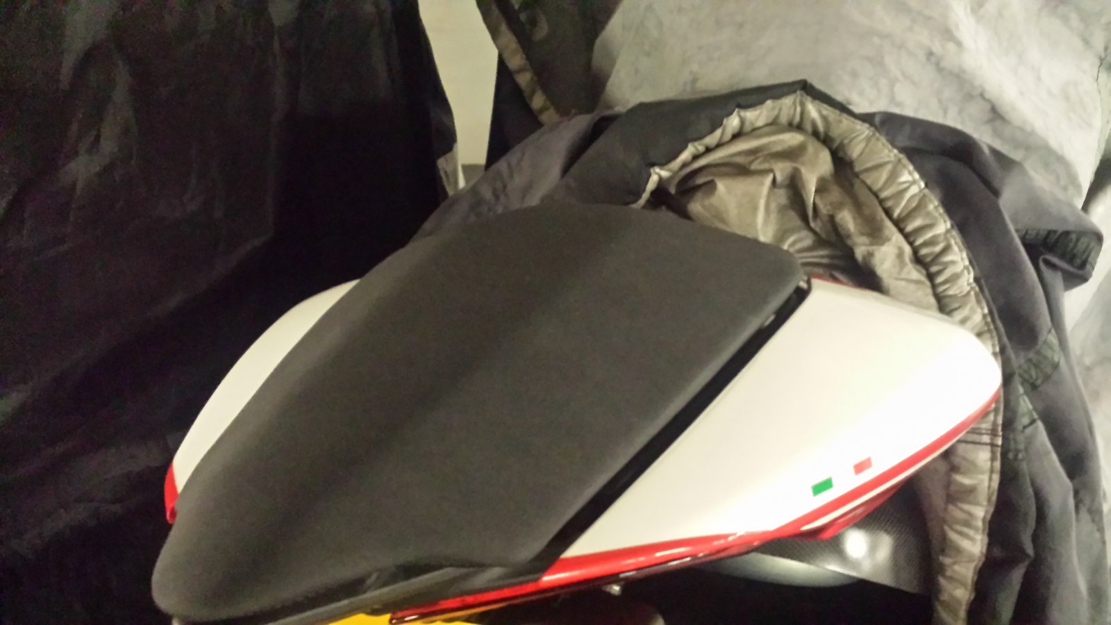

  6. The time has finally come to put an end to this pillion seat for a Panigale R 2015 conundrum... part number 595P2621A arrived today... and it fits!
    I'll leave figuring out what to do with the pillion pegs that I also received for another time... at least I can now secure the new Kriega luggage that I bought last week... phew!

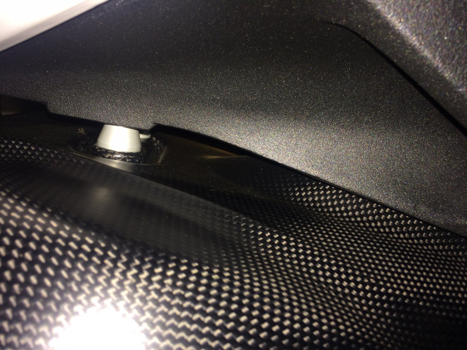

  12. image.jpeg I think maybe the spacers are not needed if you use the foot rests, so the gap between the headers and the heart shield should remain the same, this is guess work as I have never had the pillion pegs fitted.

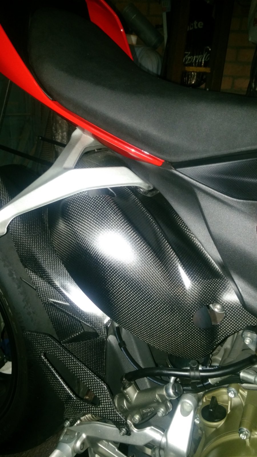

  16. I did it my self. The pegs are on the bike since Feb., I use them to hook a rear view cam watching for them blue lights
  18. Hey Emile, thanks for the photo as it's good to get an idea what it'll end up looking like. I take it the that the rear hanger assembly is really close to heat shield? Do you not think there would be a way of making it all fit without having to cut the heat shield?
  19. If your pegs are similar to mine and the heat shield is identical. I think if you don't cut a hole you will damage the shield .The other peg is just touching the shield .

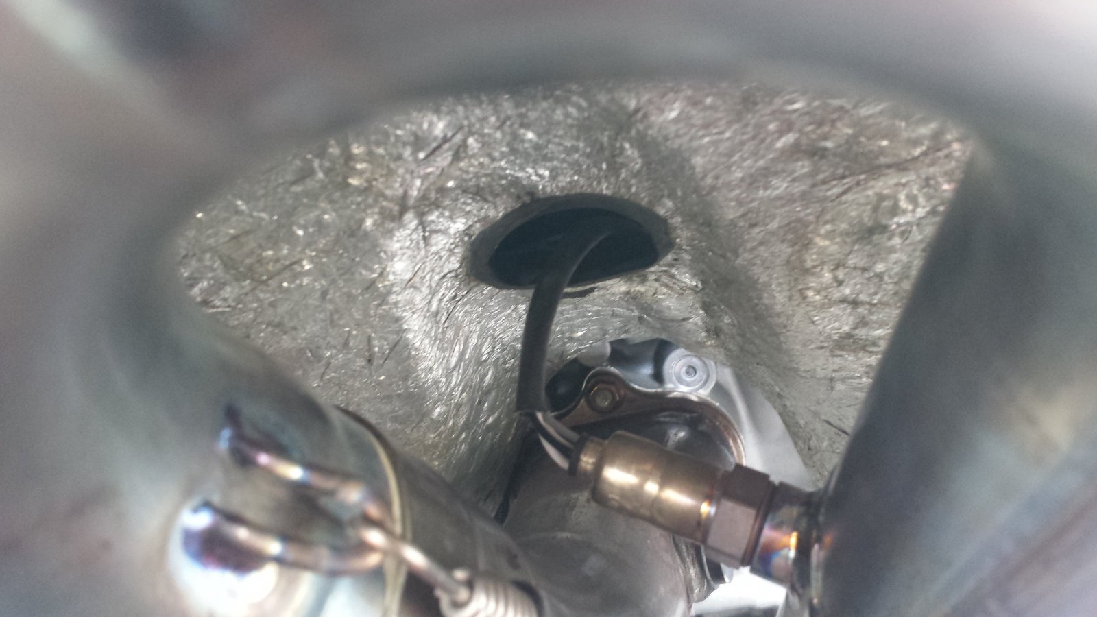

  20. Hey there! So I've been giving this whole removing the heat shield thing a go again today and I've had a good old look and I'm not seeing a 3rd bolt anywhere. When I've released the 2x "obvious" bolts the heat shield still doesn't want to come off as it appears to somehow be attached in an around that circular hole with the wire going through it that you can see in one of the pictures. Any ideas? Maybe for some reason it's been glued on around that area? HeatShield.jpg HeatShield2.jpg
