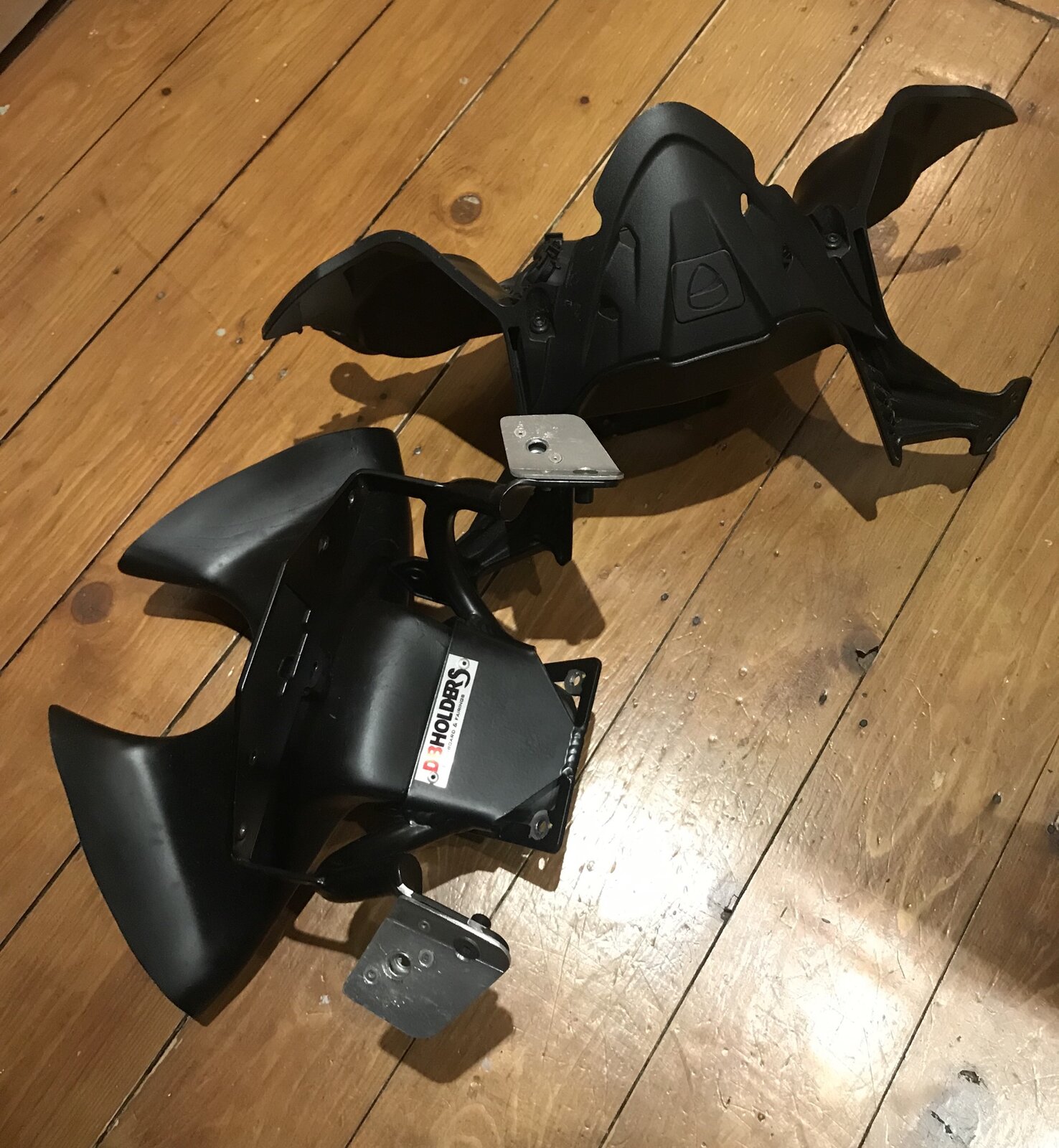

  1. I have one ready to go on. The OEM subframe is 1.24kg and the DB holders one is 0.70kg, so another half a kilo saved.

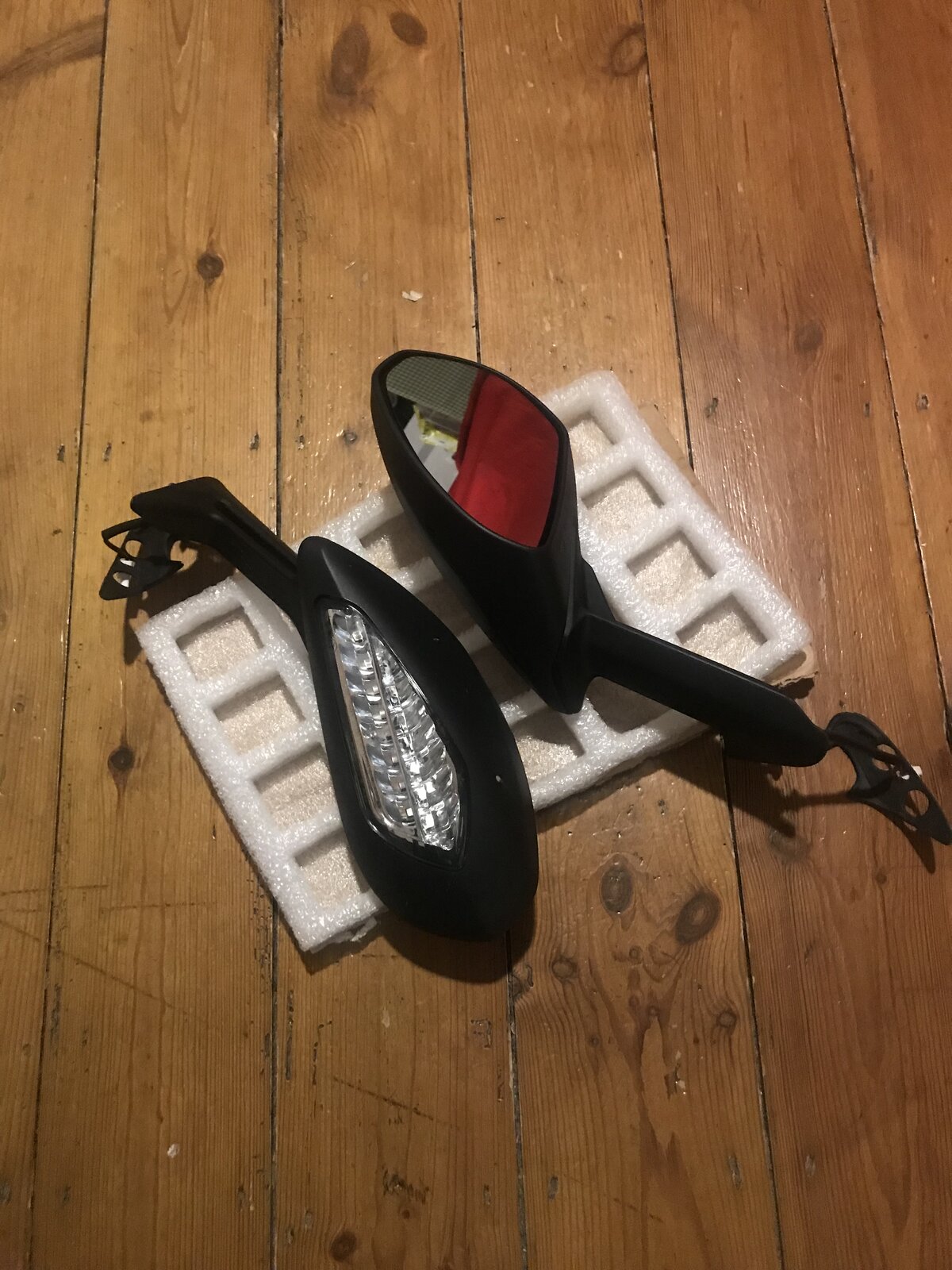

  9. Almost forgot the mirrors.... 720g

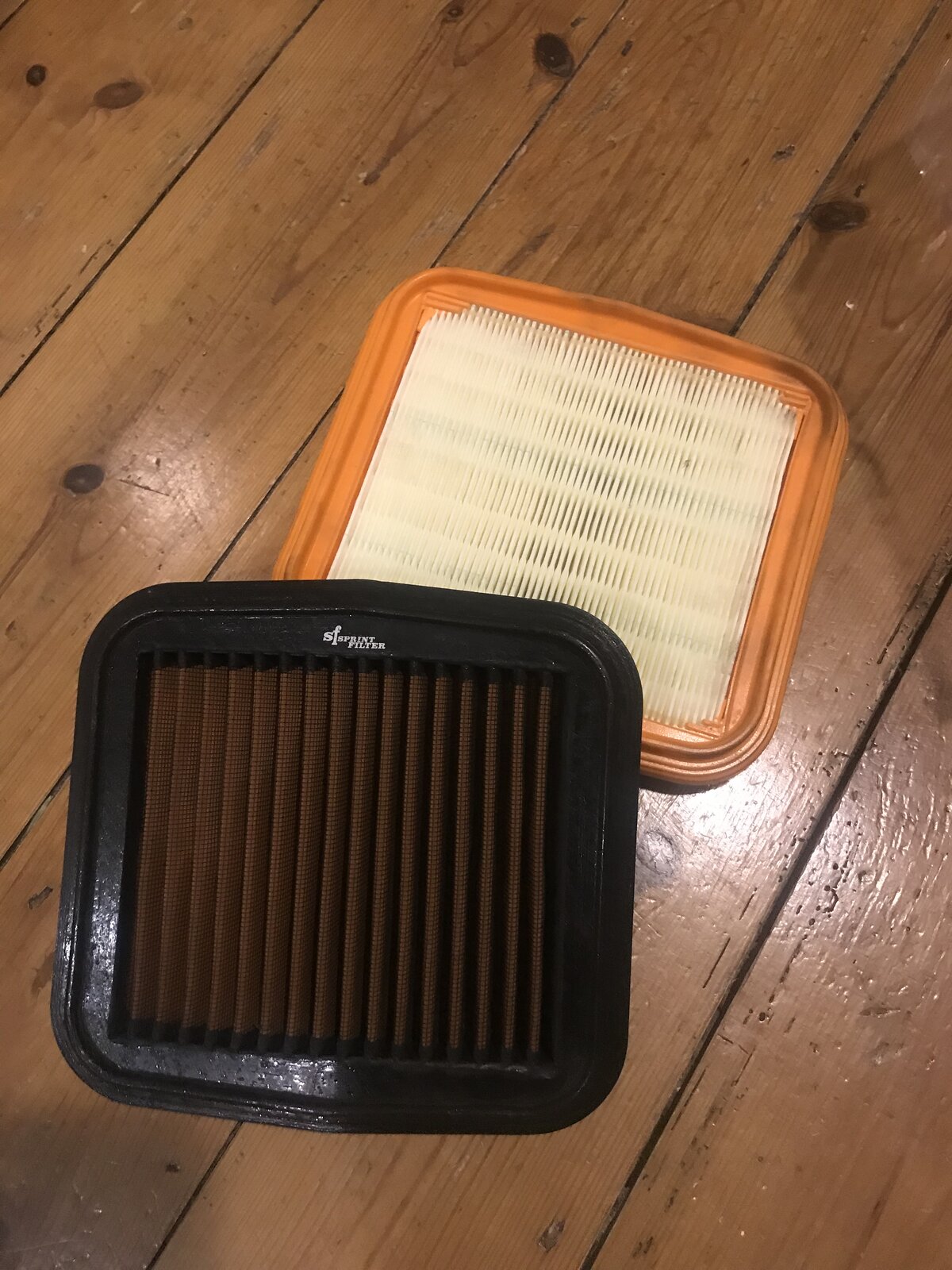

  10. Disaster! The Sprint P08 filter is 100g heavier than the OEM one!

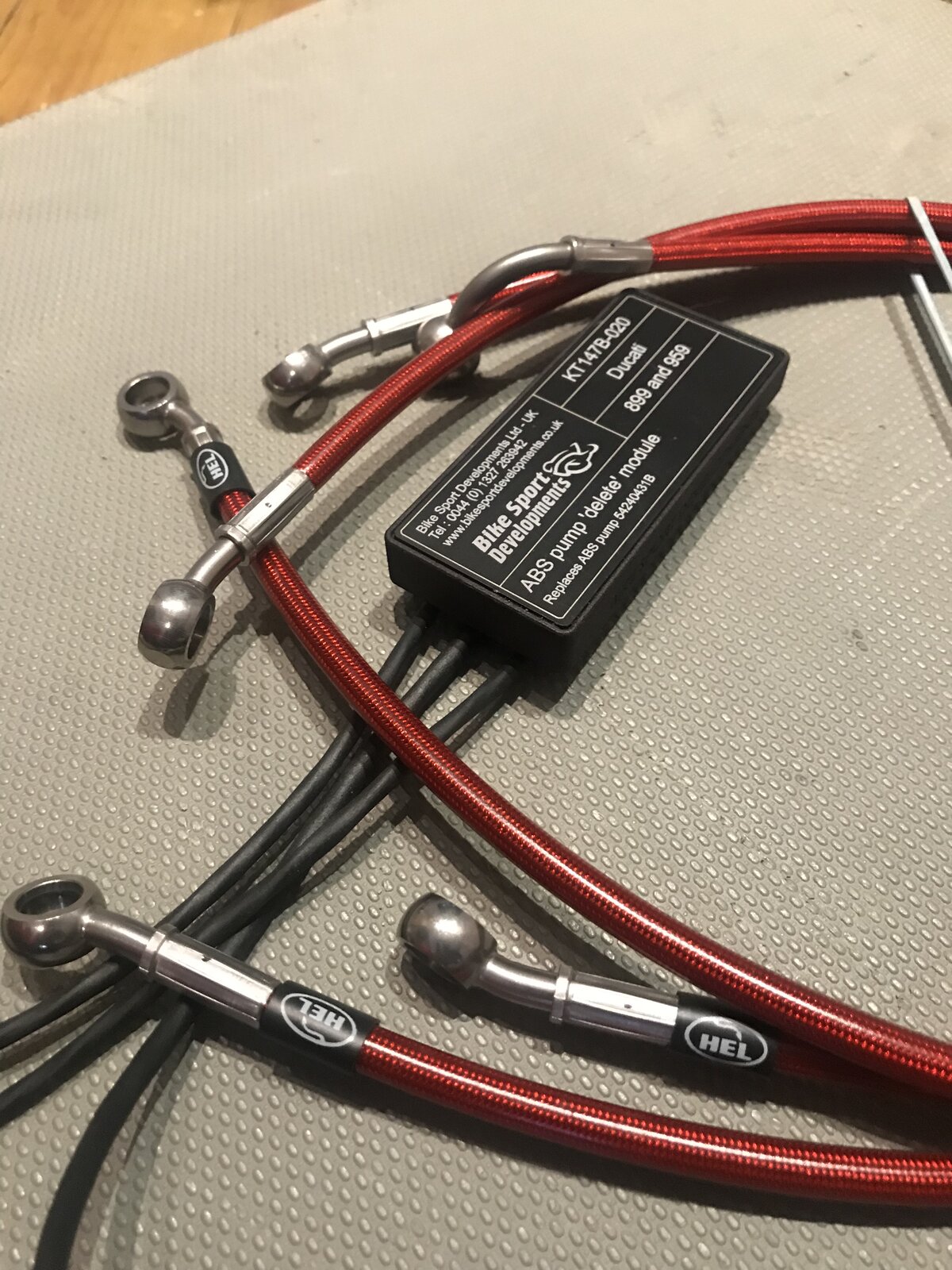

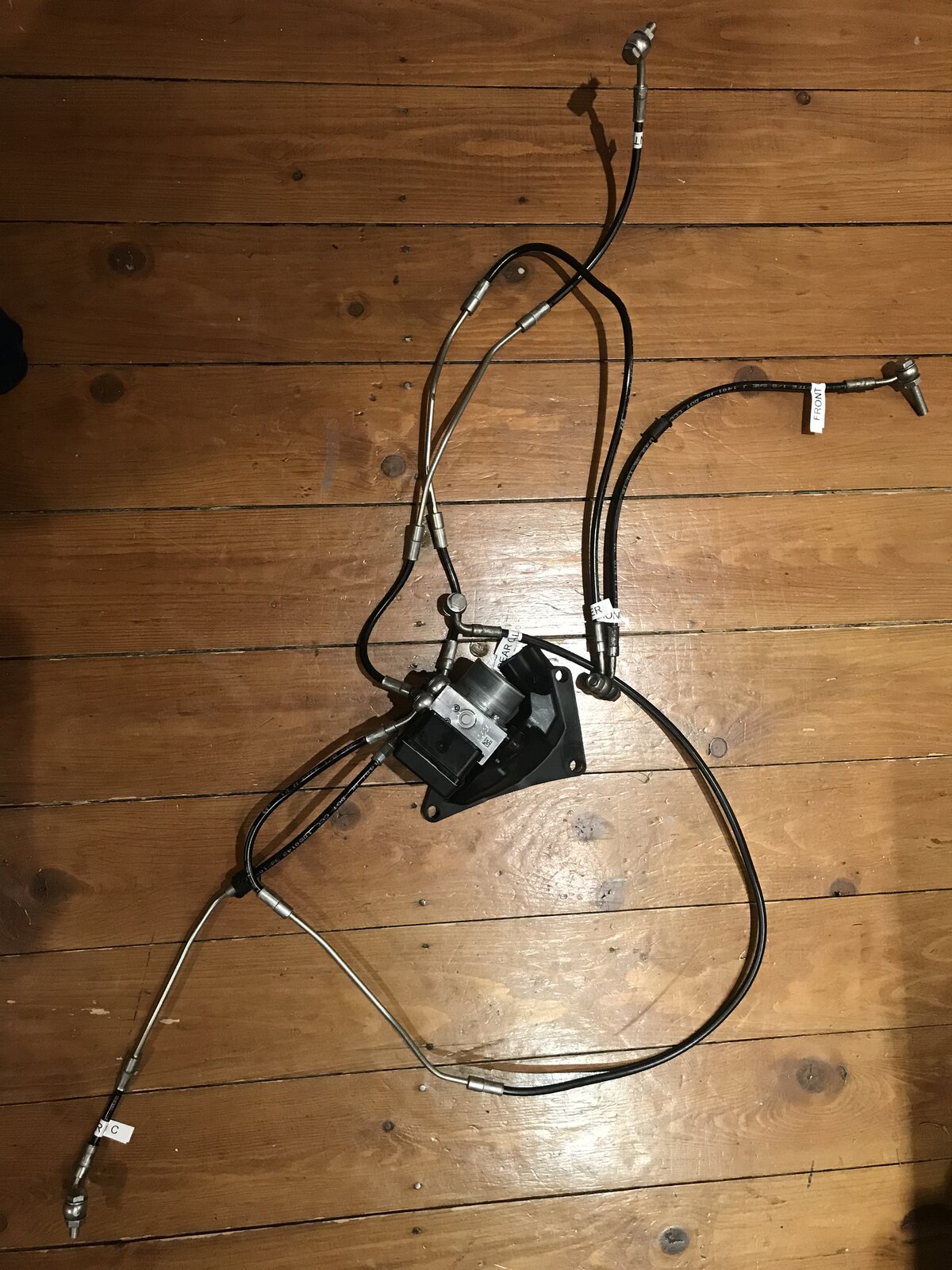

  15. Finally got around to stripping off and weighing the ABS unit/bracket/hoses. All in they weigh 1.42kg. The HEL lines and Bike Sport Developments module weigh 0.42kg, so another 1.0kg saved and hopefully better braking!
    CC571E50-E1DB-4E13-AED5-5E2CC50F27D0.jpeg 2BE832AF-3071-4E5E-96A7-ED93CAB33400.jpeg
  16. I'd hate to think how much those abs units are new from ducati when they start going wrong?
  17. Did you get the brake lines Custom made? Or are they same as 1199 non ABS?
  18. Just off the shelf race kit from HEL that I assume are exactly the same as for the 899/1199/1299. Just chose your colours and they make them up.

  20. I think that's a great mod and the bonus is a weight saving. What sort of cost for the the lines and delete module?
