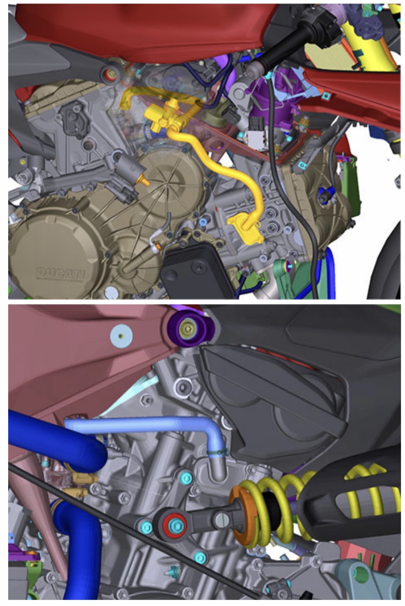

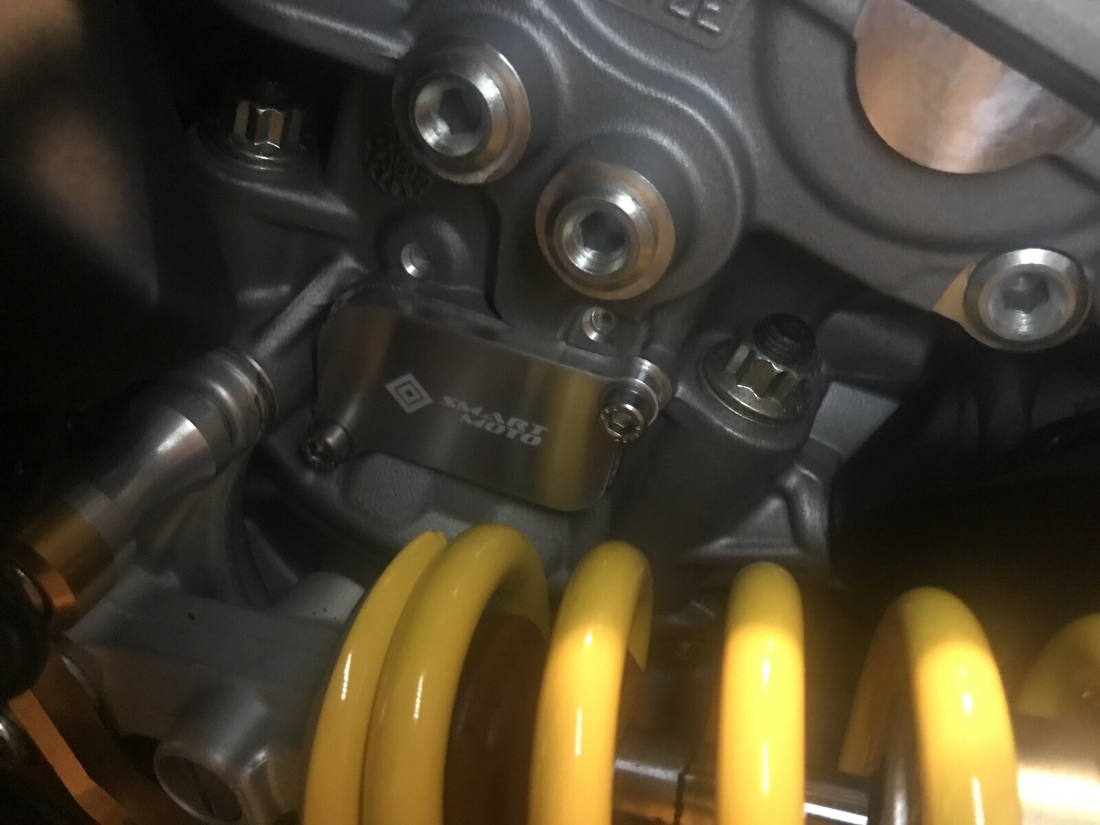

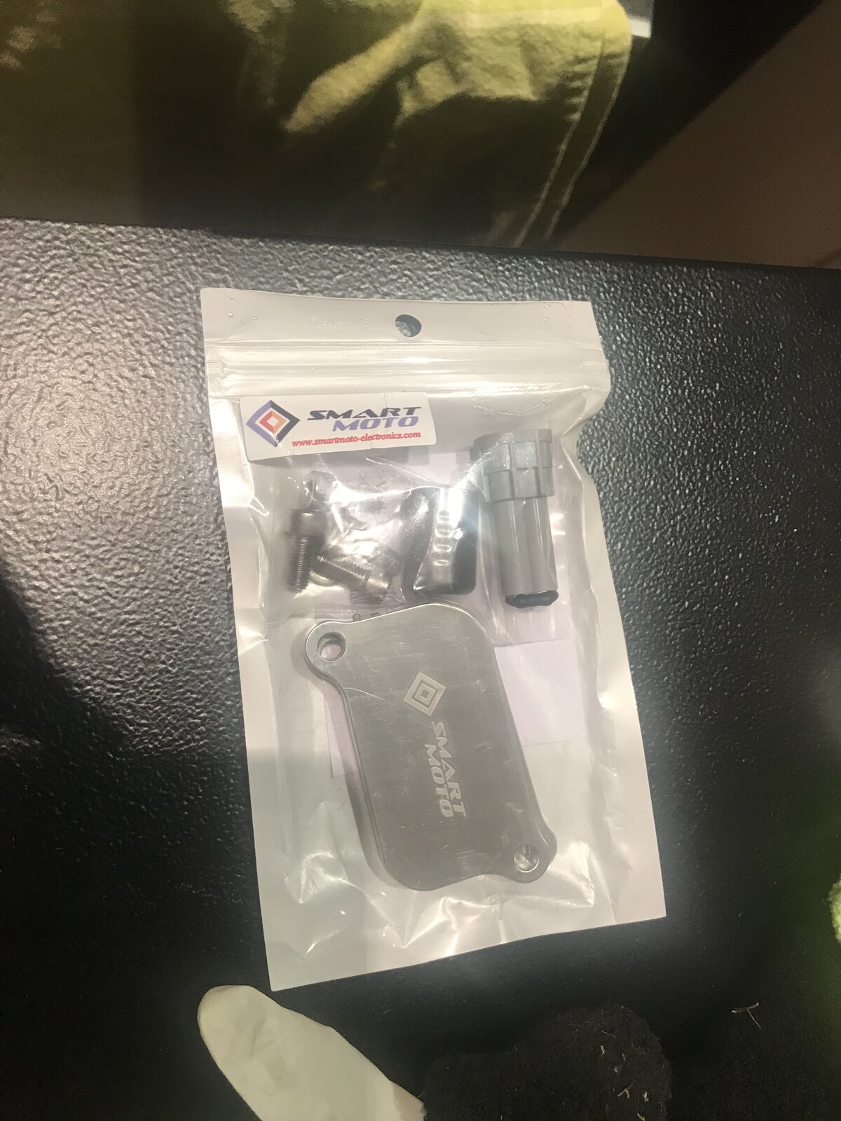

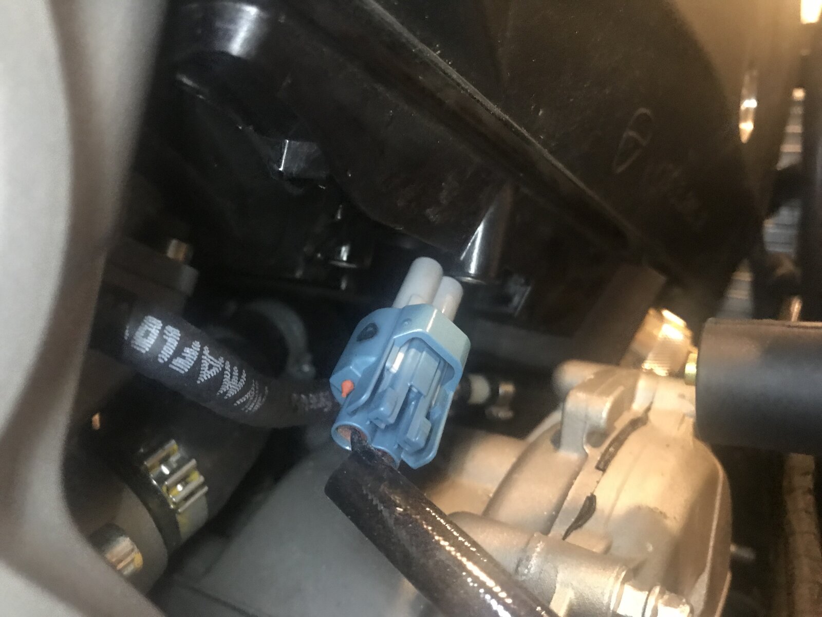

  5. Secondary Air System (or Air Injection System) swapped out tonight for a couple of blanking plates, a bung and plug-in. Old system 297g, new bits 61g, so a 236g saving and less interference from the emissions system.
    7F3EF0B6-AB5D-4377-9203-5990A07F3177.jpeg 0C1E9C68-9A3F-4AE1-9137-AC7767A6C0B9.jpeg
    (Oh, and this is by far the nastiest little jobs of all so far.... whatever bright spark decided how to mount the valve up under the air box needs some sort of award!!)

  6. Looks like the picture part was simple! Is the valve and connector under the airbox fixed to anything else?
  7. There is an air feed to each cylinder. The second is harder to get at unless you have taken the charcoal canister and ABS unit off... however the real problem is the valve/motor under the air box, because one of the bolts is behind the valve/motor and you just can’t get at it...
    It is mounted up under there.....

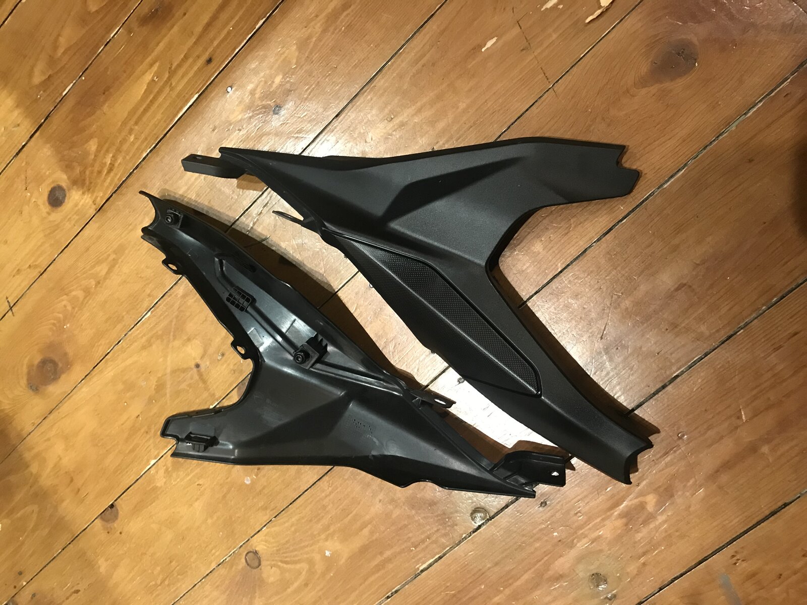

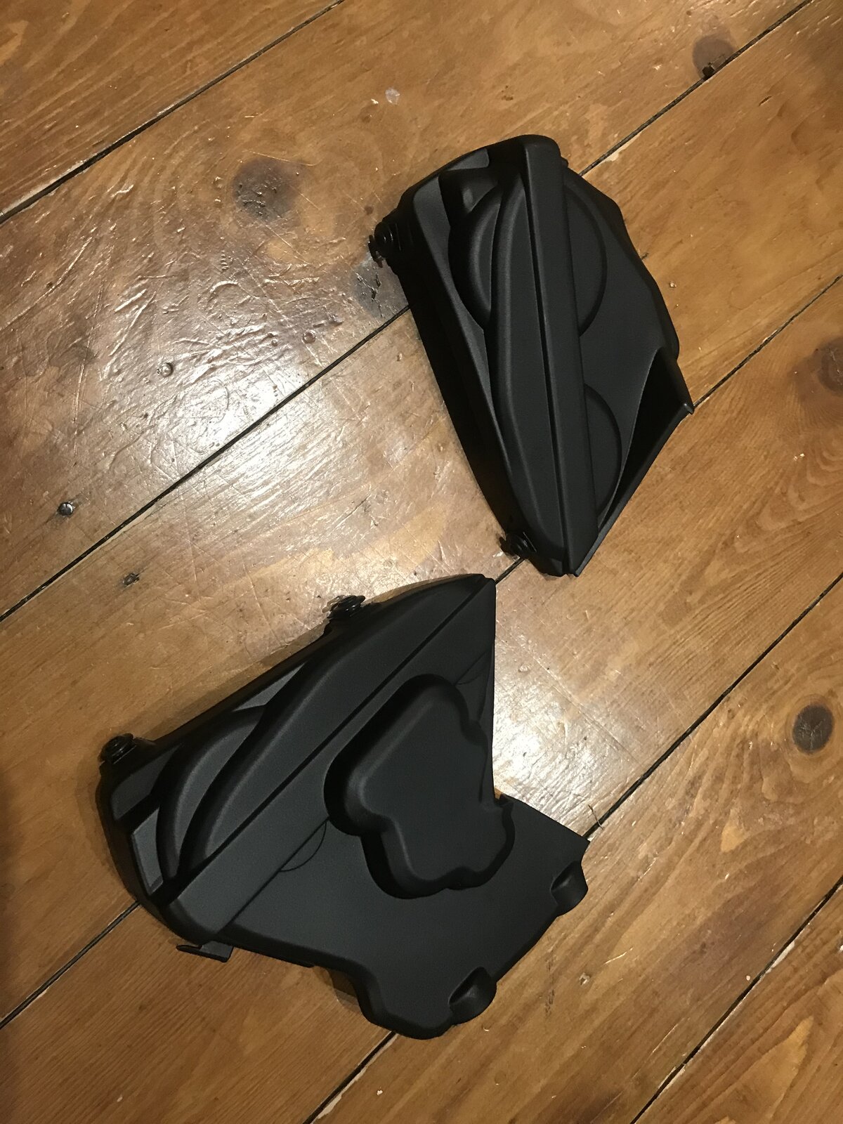

  13. It has been a slow week waiting for replacement banjo bolts (wrong thread for caliper) and for my tank and suspension to come back. However I have managed to weigh a couple of things that are easy weight removal, again at no cost....
    The plastic header covers are 190g:
    And the 899/959 plastic seat subframe covers are 300g:
    Another 0.5kg saving.

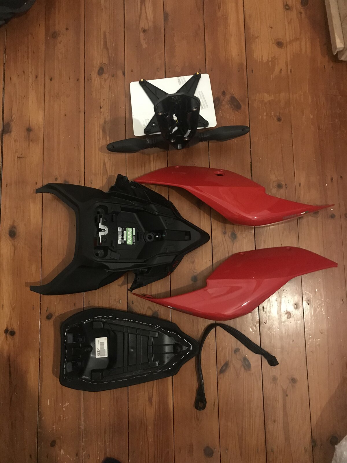

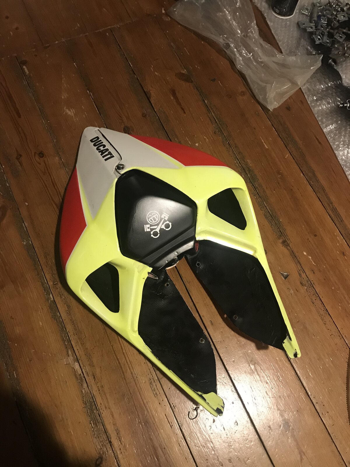

  14. Swapping out the OEM seat/light/tray/indicators/numberplate for a race rear fairing saves a surprising 2.2kg...

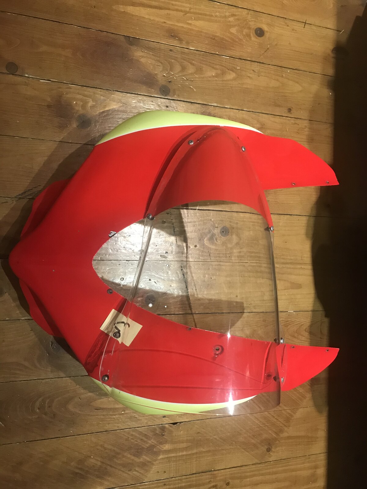

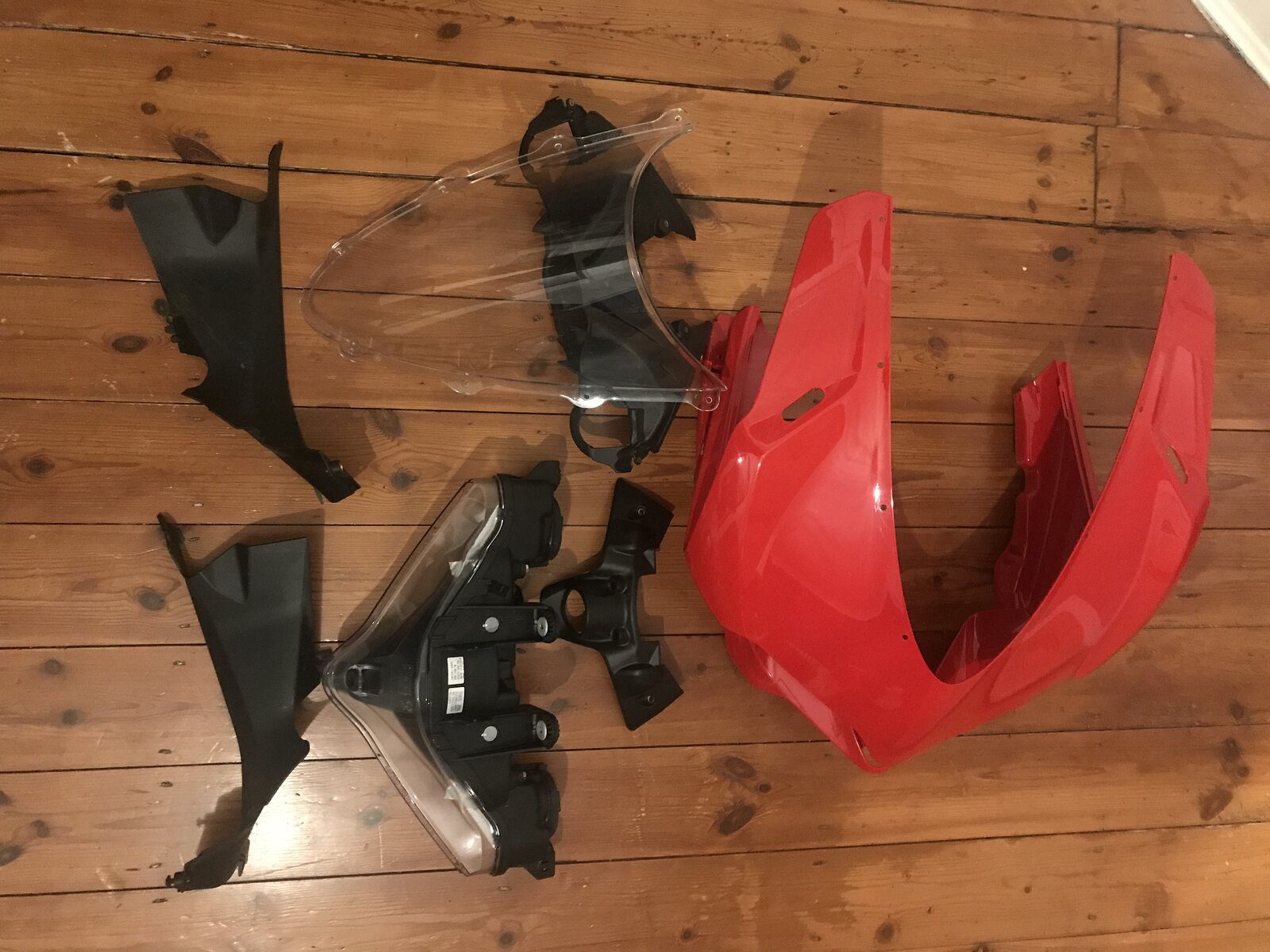

  15. Weighing more bodywork tonight.

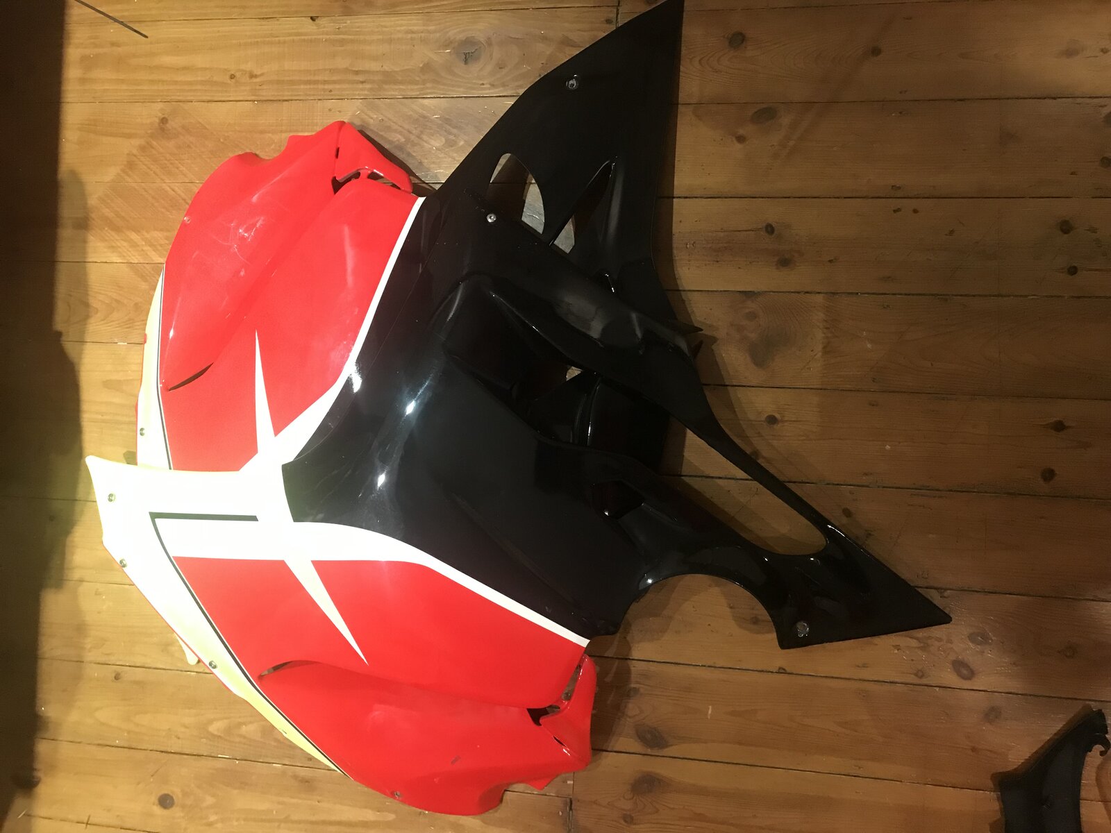

    OEM nose including light and air tube covers is 3.05kg and the race nose/screen is 0.88kg, so a 2.18kg saving:

  16. Its amazing how much a simple decamp of standard stuff can transform the weight :upyeah:

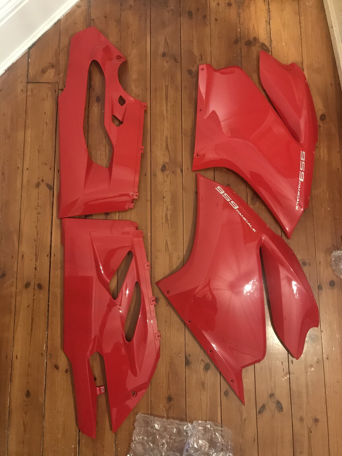

  17. Side panels (959) OEM with the sound deafening weigh 2.78kg. The race replacements (with fixings that I didn’t weigh on OEM) are 1.54kg, so another 1.24kg saving...

  18. Absolutely. 15kg so far with not a lot of spend (my fairings were second hand with a free front subframe (£450), so was the 1299 exhaust (£250) and I got discounts on quite a few of the other bits).
