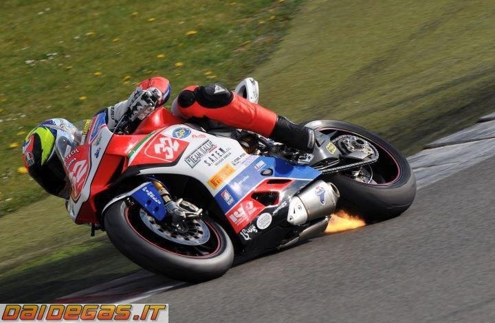

    Now that will dry the rain!!
    I must admit went for a quick ride the other day and I could hardly touch the tire on my return.
  3. We run 190 slicks on the BSB Panigales.....and dont have ANY traction control !
