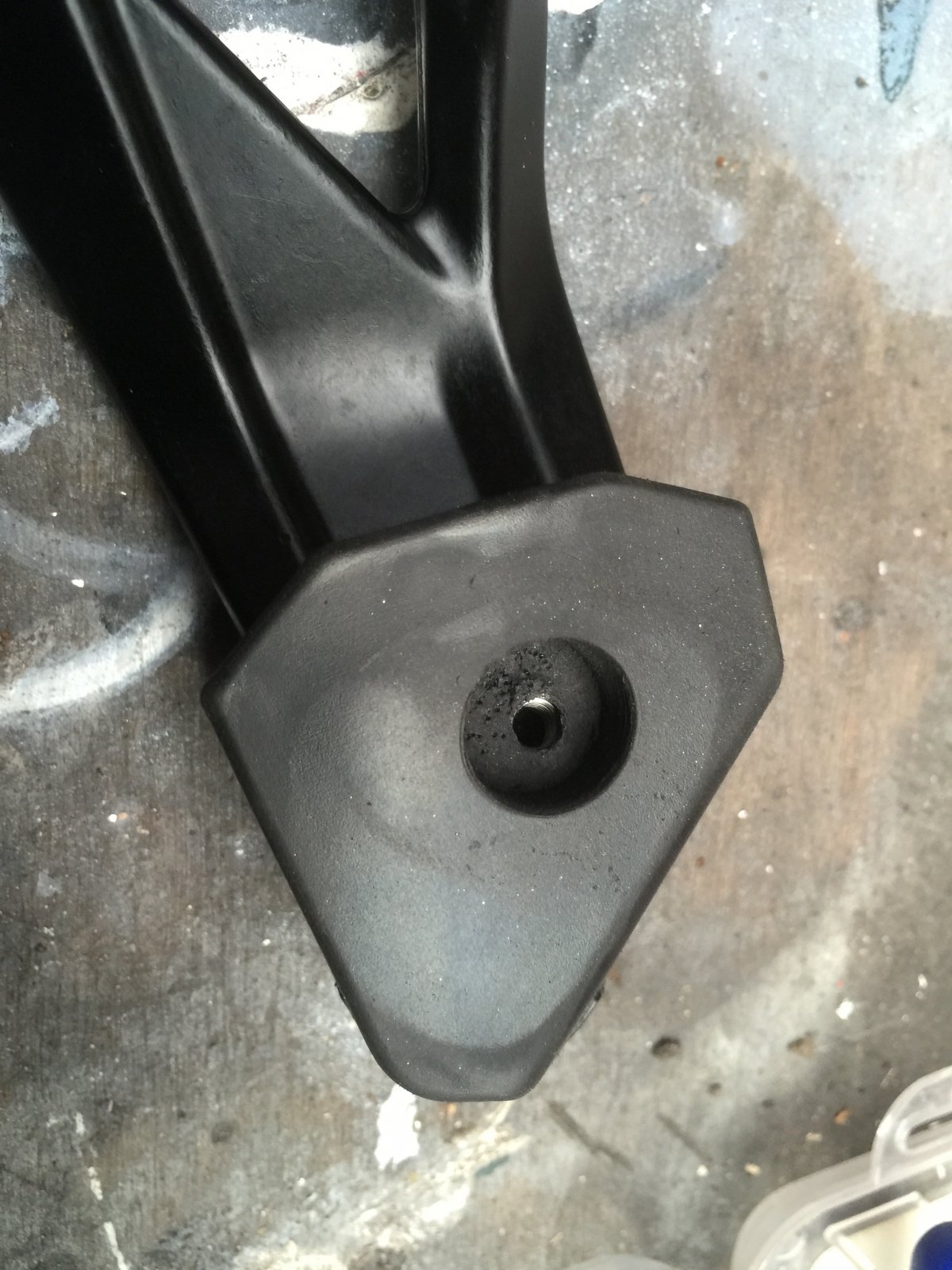

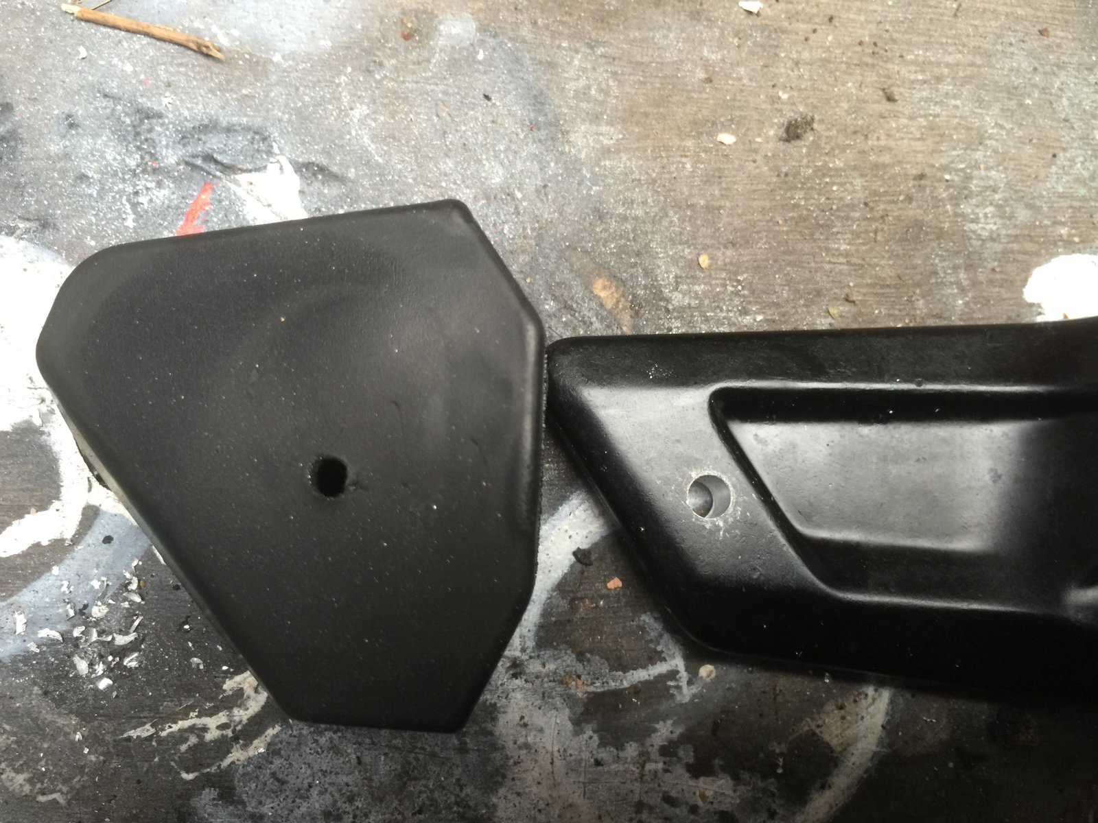

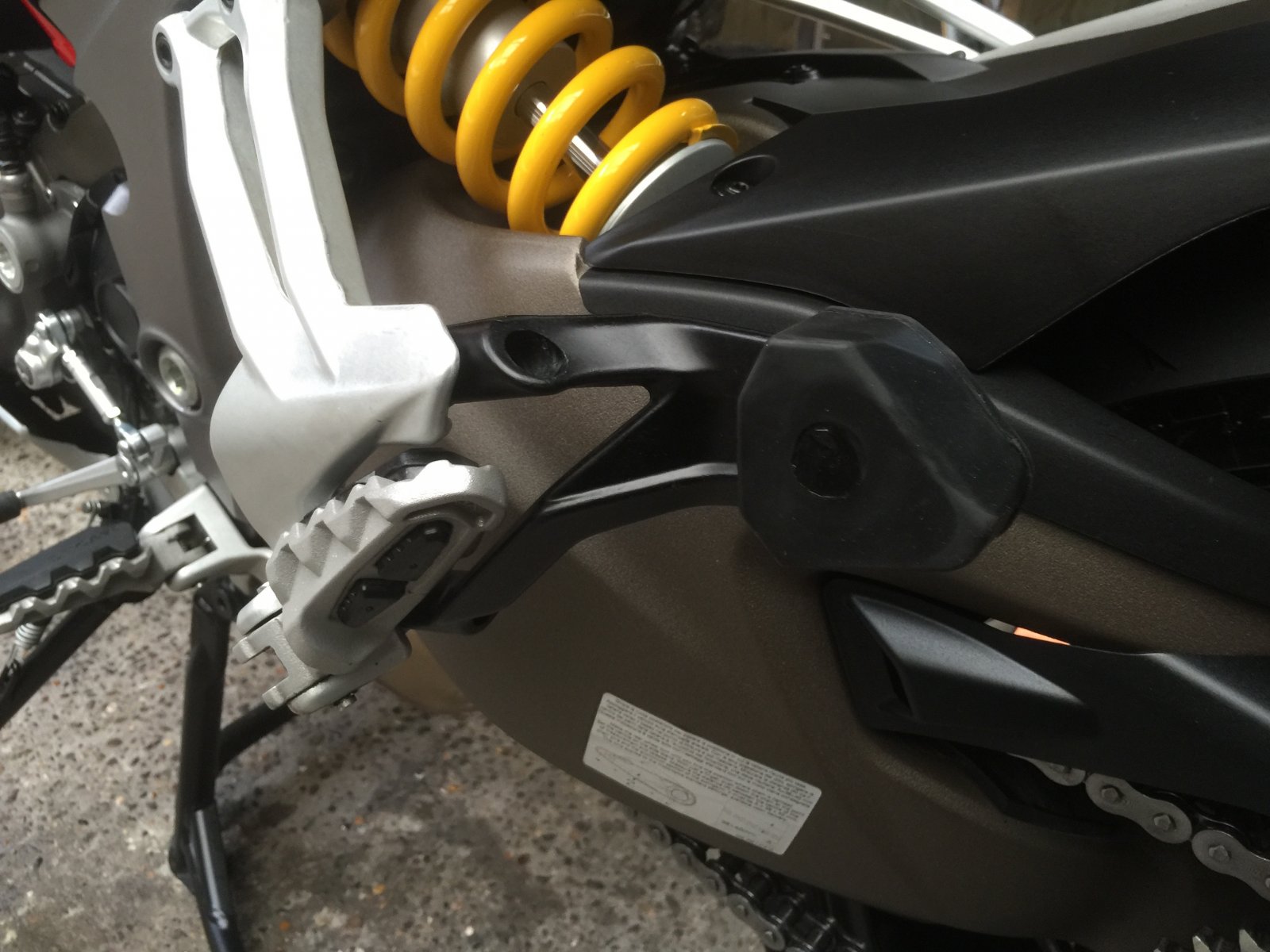

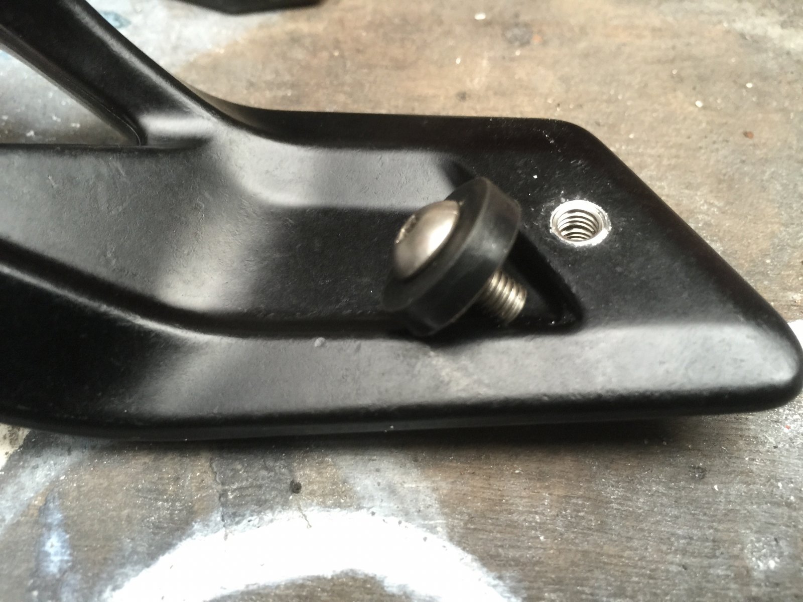

  2. Having lost one from my 2013 even though it was glued I decided to do something more permanent with the DVT
    Hole drilled but not all that way through.
    Thread cut, screw and hard rubber washer prepared
    Countersunk hole for screw head and washer'
    Screw in place
    Dab of black silicone to conceal screw
