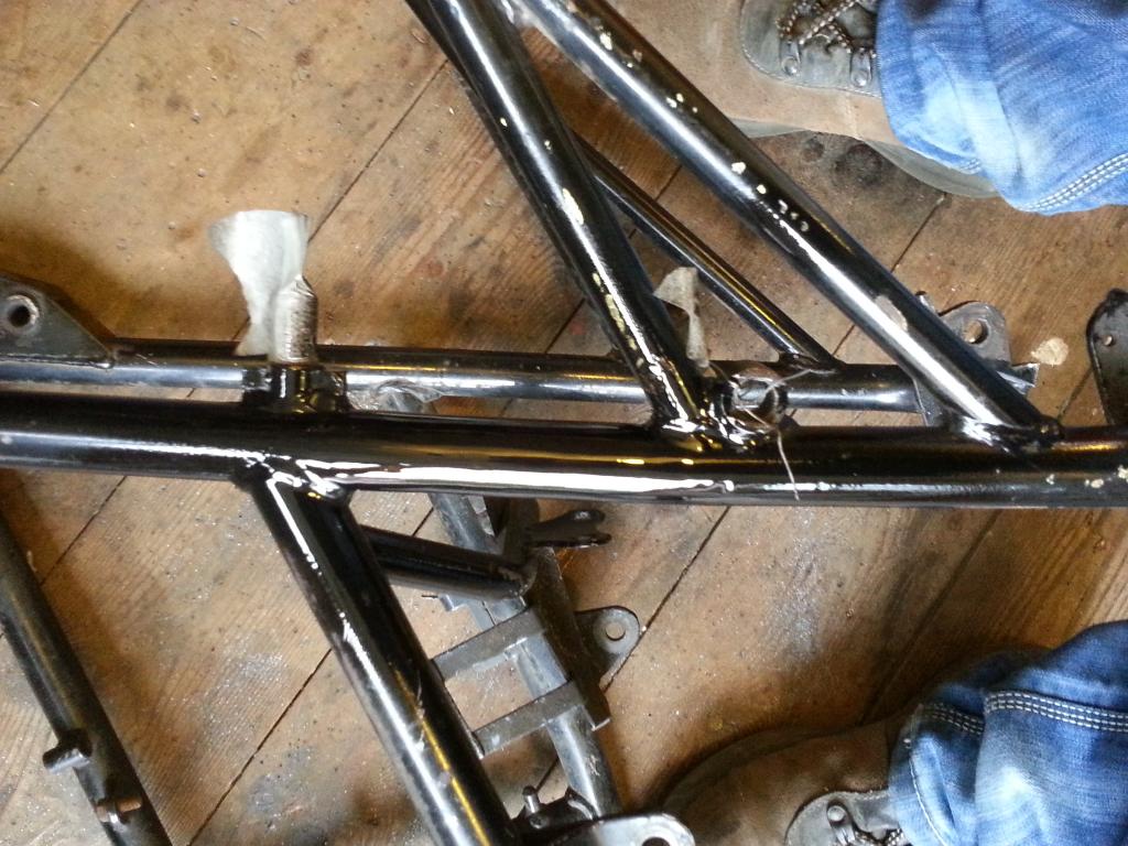

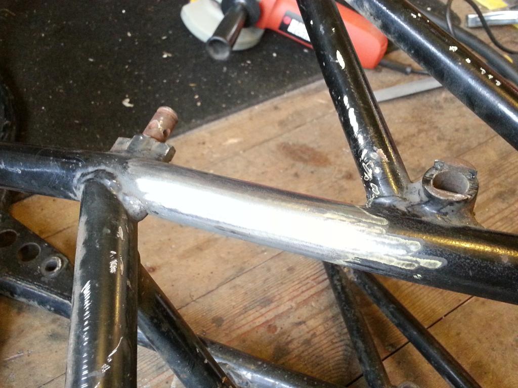

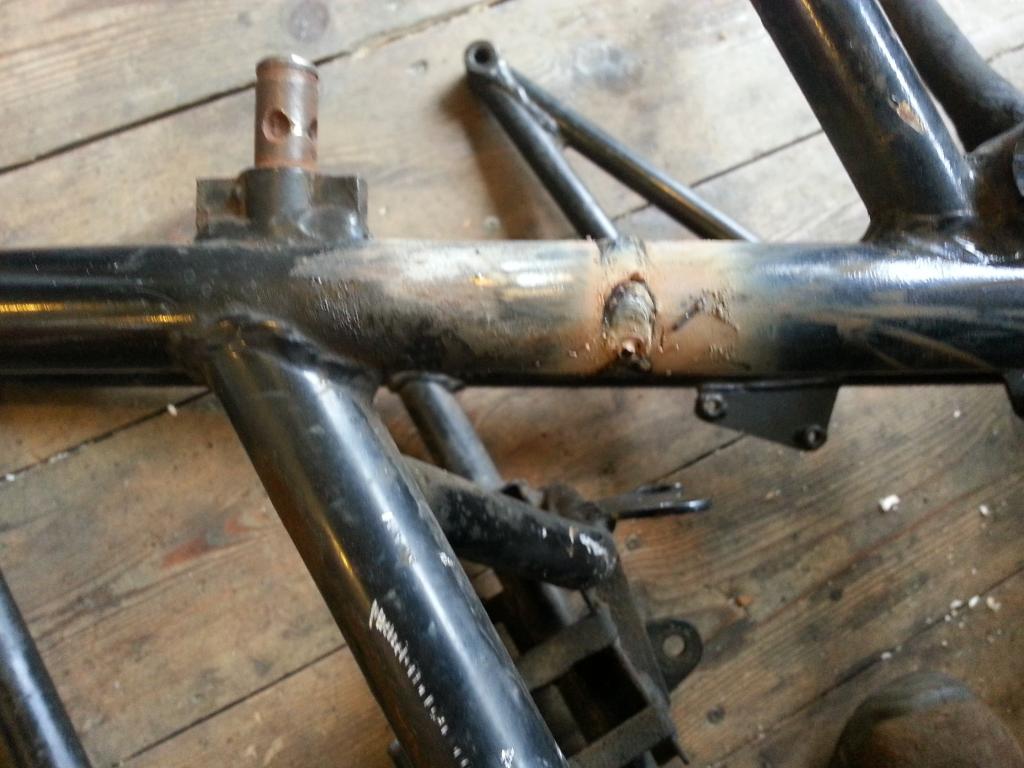

  2. Photos of Nuttynick's very effective frame repair operation. With the internal reinforcement it must be stronger now than it was in the first place.
  3. I'm not sure if I took any pictures of it before I cut the bent section off to replace it with the good section from the other frame? Any pictures of it powder coated? I just blew it over to keep the corrosion out. You even get a peek at my workshop boots :)
    #23 nuttynick, Aug 27, 2013

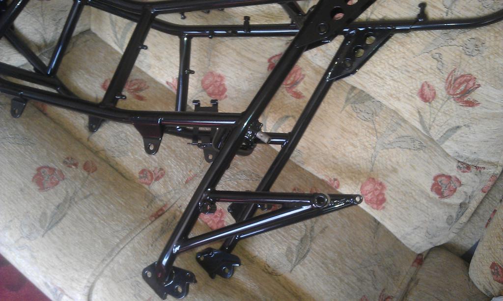

  4. Here's the frame you fixed, Nick, as it is now shown relaxing on the sofa. Sometimes I think I spoil these bikes ...

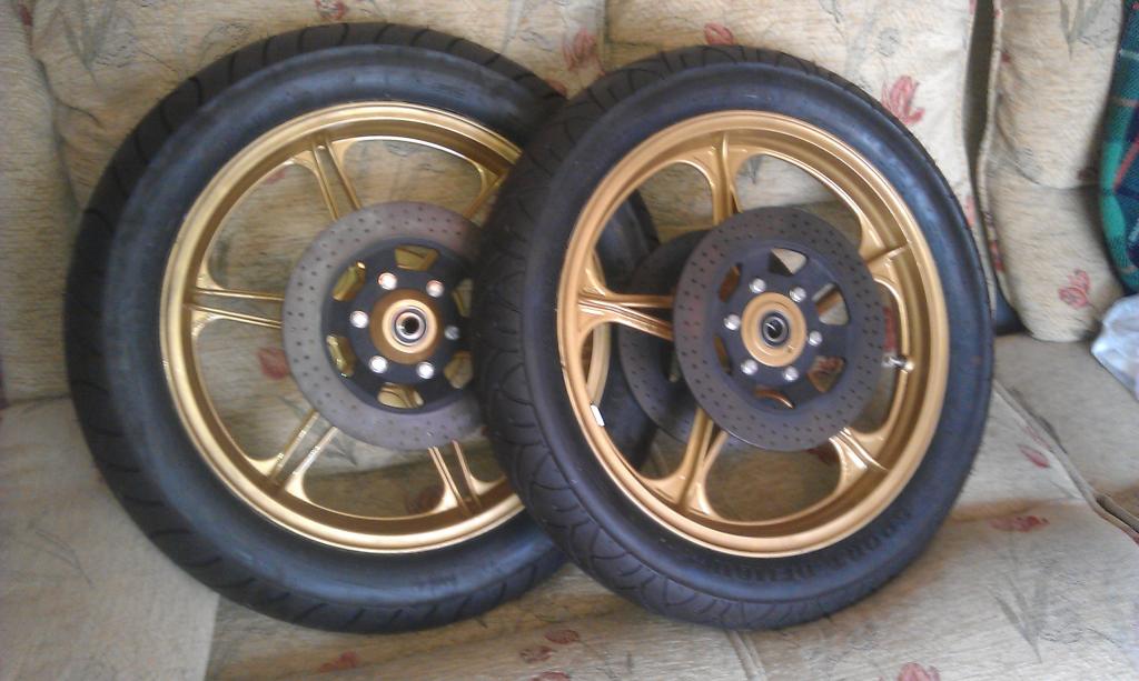

    ... and here is a pair of wheels. Well I say a pair, rear one is FPS and front one is OSCAM.

  7. I'm pleased with that! Hopefully when I chop the parts off the other chassis and re-weld that, it'll come out as nice.

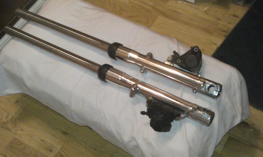

  11. This pair of 35mm front forks (now):
    ...are the same ones as in this photo from last year:

  14. I managed to find a guy who wanted to swap an FPS front wheel which he had for an OSCAM which he needed. So we did the swap, and we both ended up with pairs of the correct wheels for our bikes. Then I had another wheel to powder coat, replace wheel bearings, sort out and fit brake discs, and fit new tyre. All done.

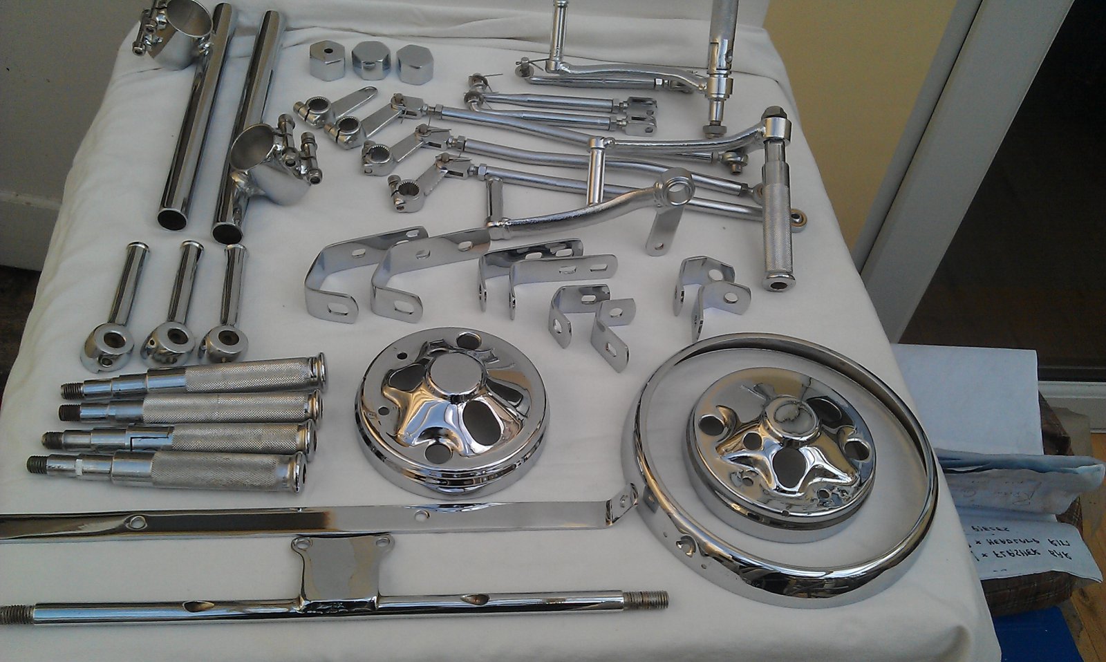

  15. Footrests and gear/brake levers tend to get scraped and bent over the years. The Pantah ones are all chromed steel, as are the clipon handlebars, fairing brackets, etc. I have got 6 footrests, 3 gearlevers and 3 brake levers (for three bikes) welded up, machined, straightened and polished. 65 bits are now with the chromers, who should have them finished in a couple of weeks. Then I'll find out if their work is as good as they claim it is.
    Chrome plating by DMF based in SE London, electroplating refurbish service including, metal polishing, nickel, chrome, copper and gold. We specialise in car and motorcycle parts and can refinish onto diecast, brass, steel, copper and stainless steel.A1 Chrome plating, chroming at its best, full chrome restoration service.
    #36 Pete1950, Mar 13, 2015

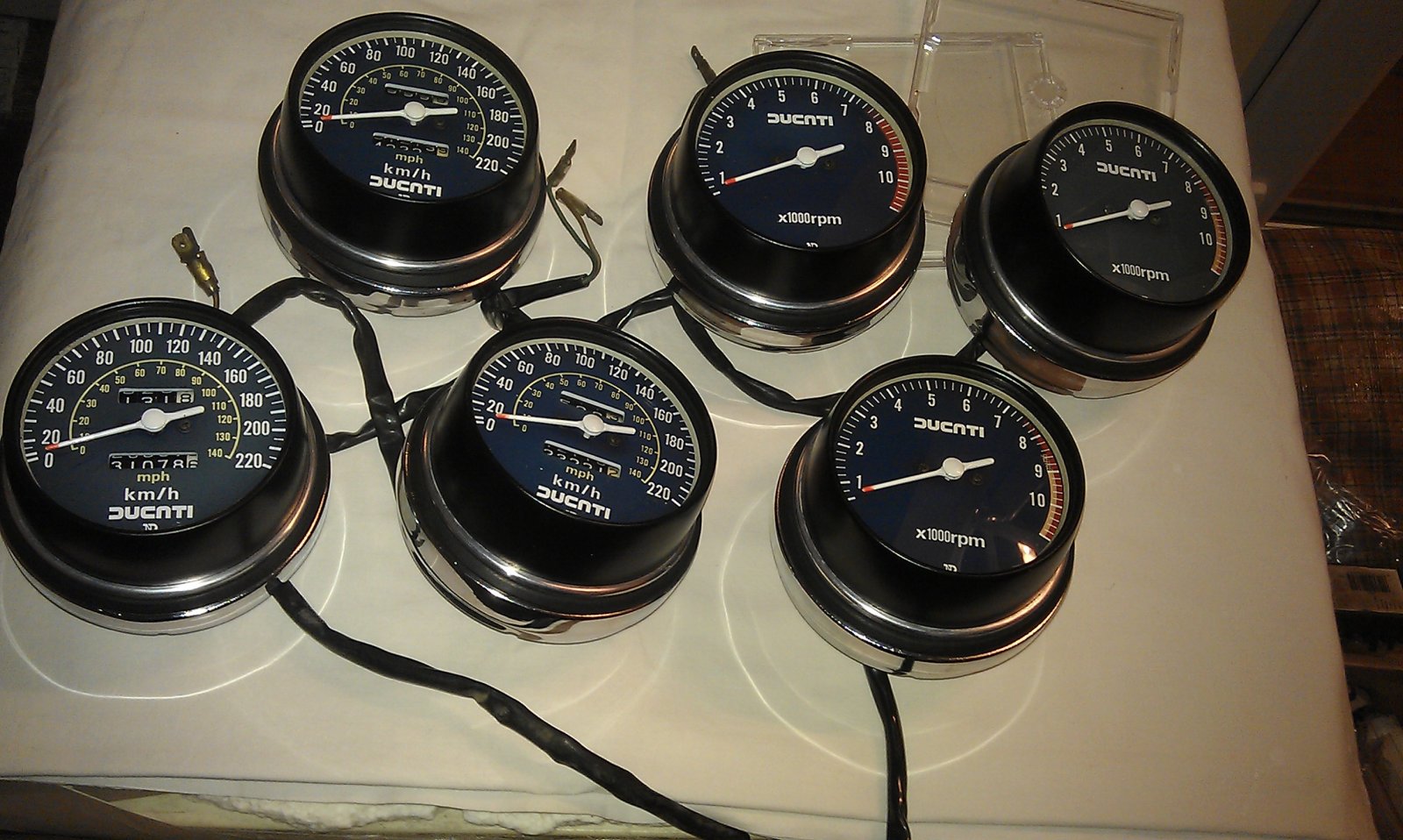

  18. I have been restoring six Pantah clocks (3 x speedo, 3 x revs) which are 1980 Nippon Denso items similar to MHR clocks. Now finished them, and looking pretty smart I think.
