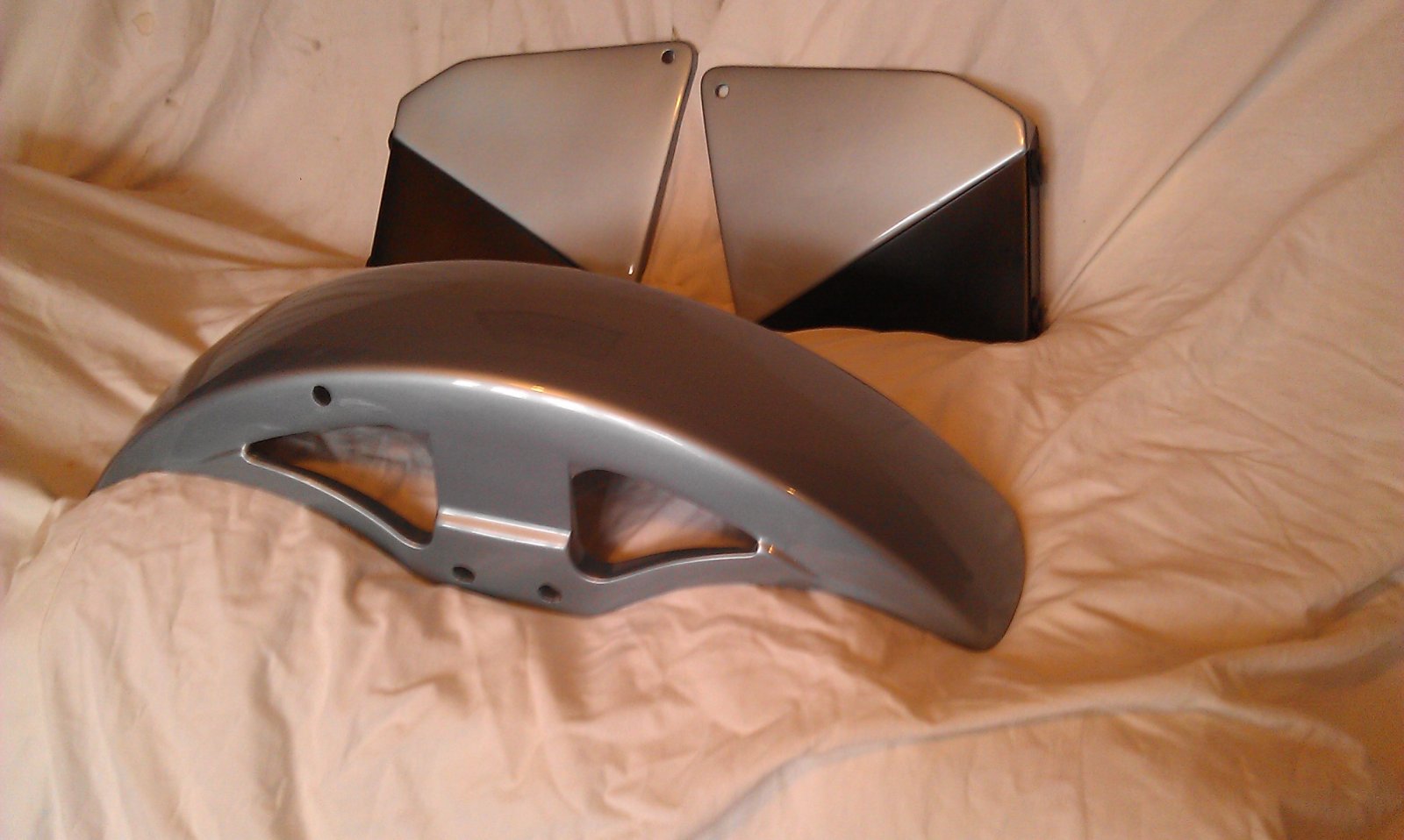

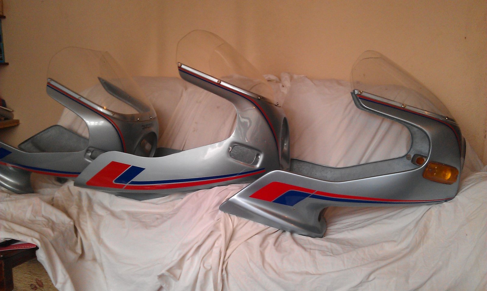

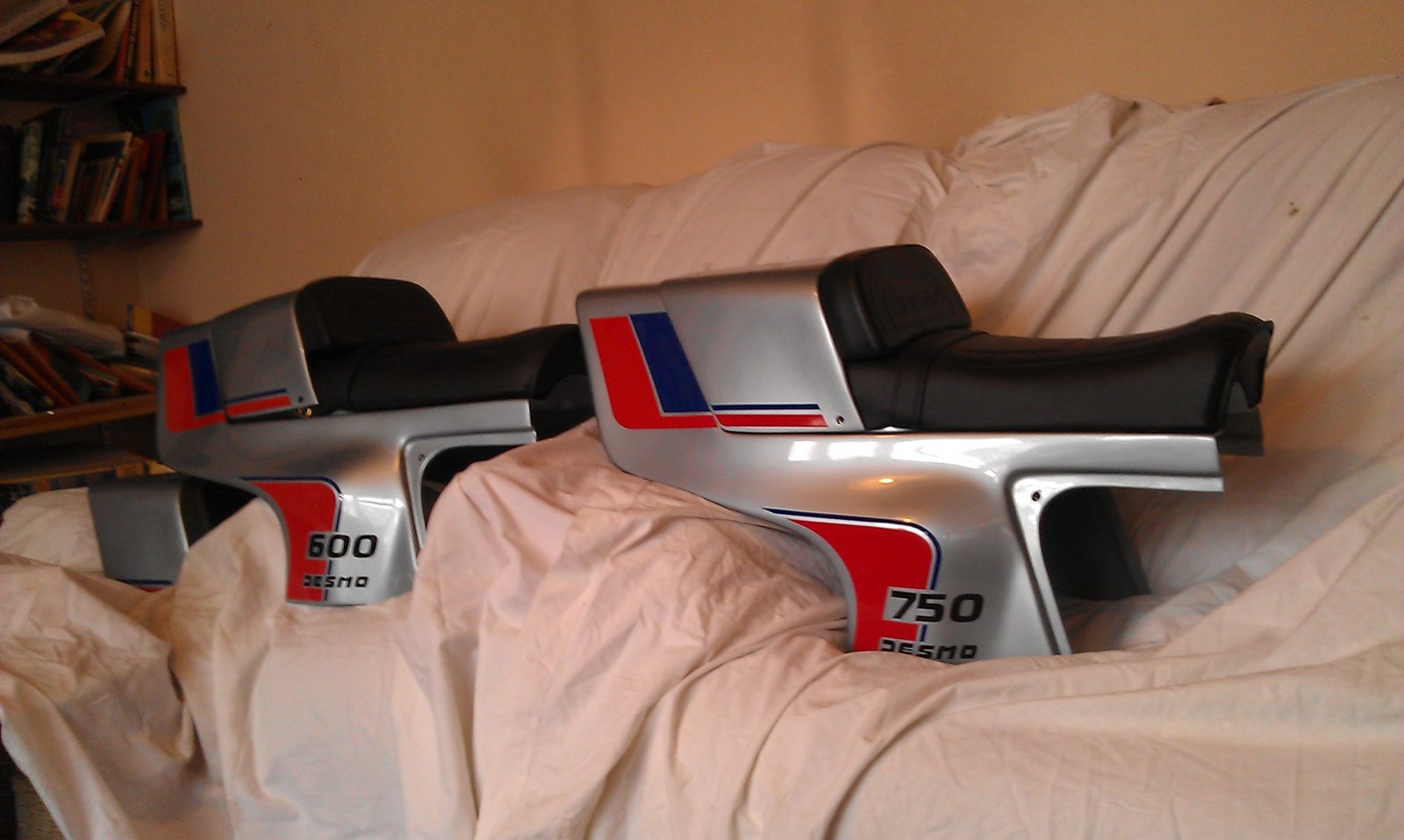

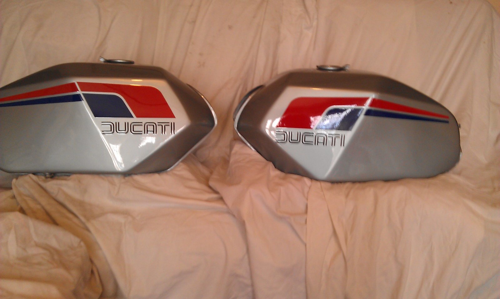

  1. I have completed the painting of bodywork now, so I have three sets of fairings, tanks, seats, side panels and mudguards with high quality paint and good decals, and the seats re-upholstered. Here's a selection of them:

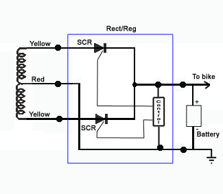

  15. The 3 wire alternators are not actually 3-phase, they are single-phase with a centre tapped winding.
    This picture will give you an idea of the set up and how it worked.

  19. I wish I could decipher this. As it is, it makes about as much sense as sheet music. Actually, a little less.
    That's quite sad. Electricity is just one of those things I have never mastered. Poor teaching, I call it.
  20. I'll try to explain. The centre tap connection (red wire) is connected to ground, so that makes the negative connection. The 2 yellow wires are connected to the SCRs (Silicon Controlled Rectifiers). These act like diode and only let the current flow in a positive direction. So the battery only gets a positive voltage from the regulator. The SCRs are like diodes that can be switched on and off. The control circuit is connected to these and maintains the voltage to the battery by switching the SCRs on or off as required to maintain the correct voltage.
