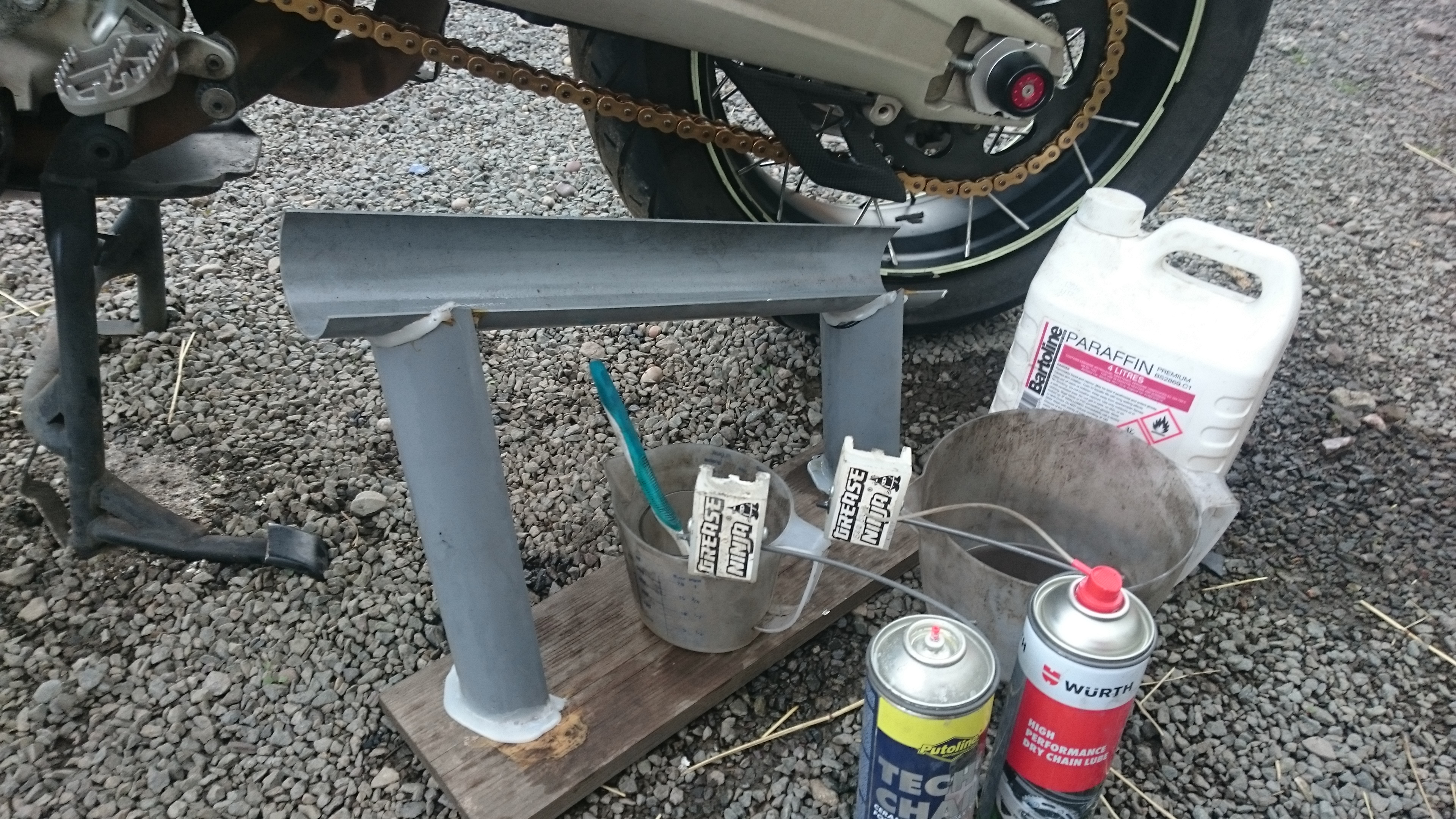

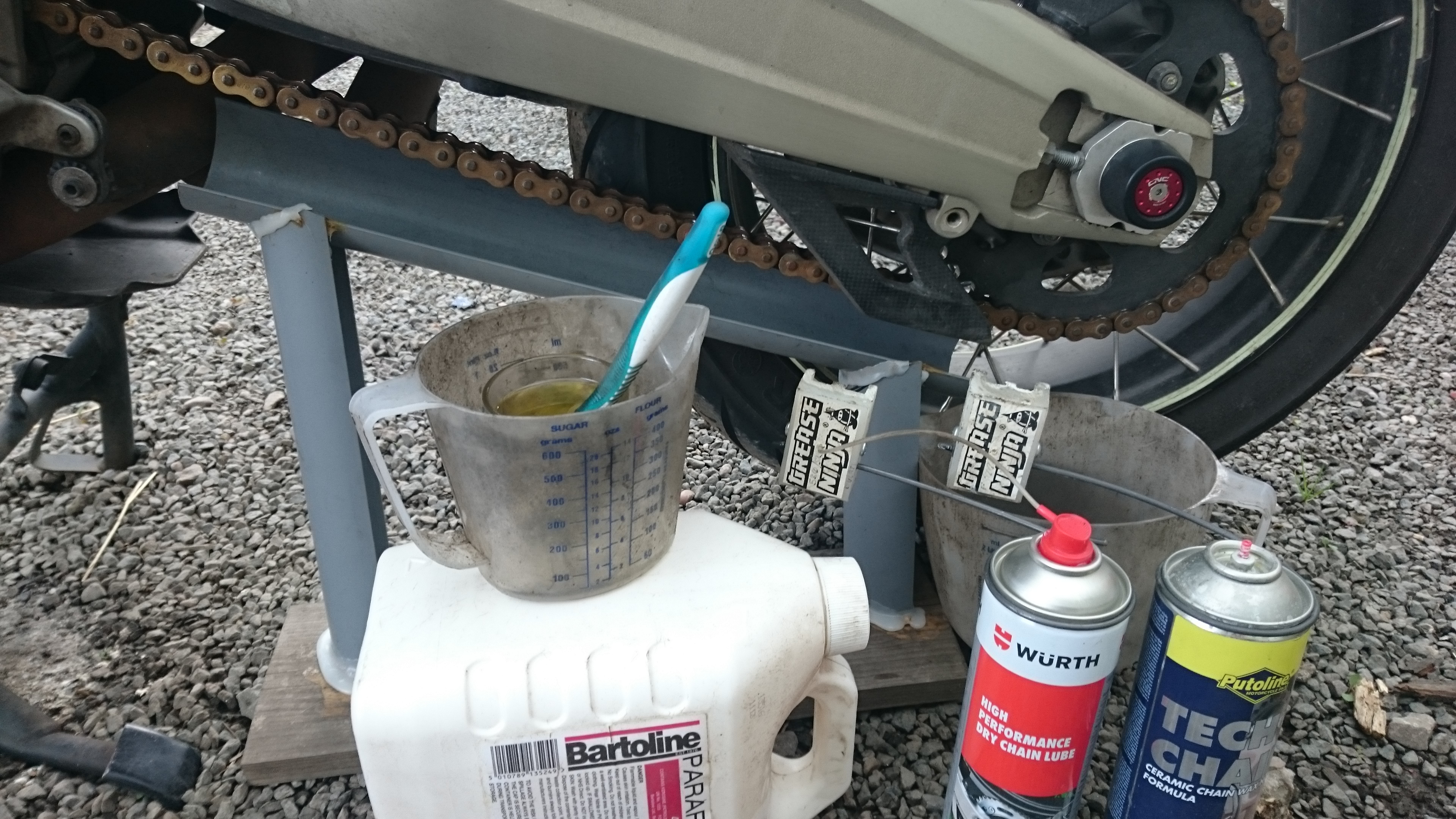

  6. You should get a patent on that rig and take it on Dragons Den:astonished:

    Got to rig up a trough like GunZenBoomz now.
