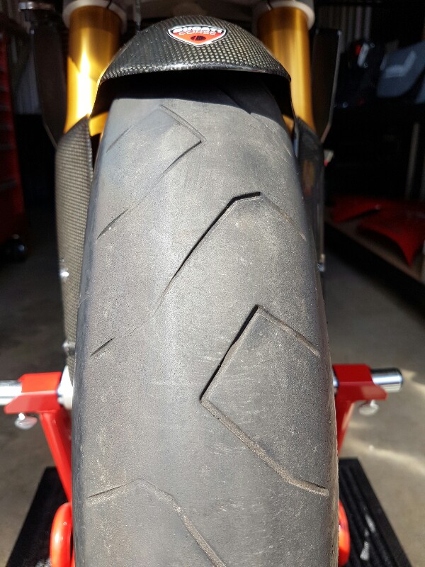

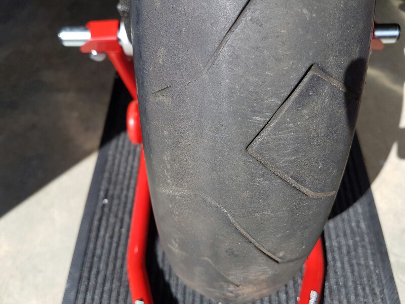

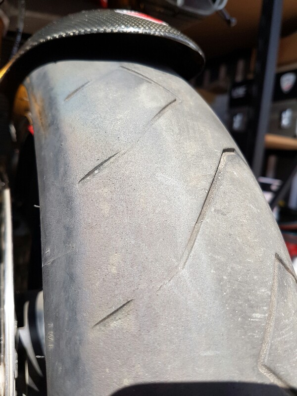

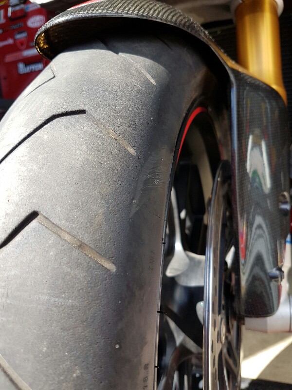

  12. Hi, I was going to start a new thread but I figured here would be as good a place as any.
    As the discussion goes(or went), I also have recently noticed the same abnormal wear on the right side of my front tyre. Tyre is a Pirelli Dragon and although the bike has not been ridden for some time I do remember the bike was very....ummm....unstable.
    I am in the process of getting the bike back on the road and have just purchased new Ohlins forks and offset triple clamps, which are not yet fitted.
    Could this be just a road camber issue or maybe something geometry related.
    Attached a couple of photo's ( I am a terrible photographer ) anybody have any ideas ? The right hand side of the tire has a definite "flat" band about 2" wide around the whole tyre. 20160925_141544-600x800.jpg 20160925_141554-600x800.jpg 20160925_141607-600x800.jpg 20160925_141635-800x600.jpg
  13. I've had the same issue with every Pirelli tyre I've used. The reason I think is the tread design as mine 'stepped' really badly after 700 miles and had a 'channel' in it off centre to the right like yours.
    To further qualify, this happened on my 848 from new with SuperCorsa's, it happened on my Daytona with the same tyre and then also with a replacement 'Diablo 3' at the time despite my suspension being re-valved and set up for me... and it happened on my 899 with the standard Diablo Corsa front Tyre.
    I'm 88kg, not particularly hard on the front, and infact in sorted it's self out a bit after a day usage on track. I always keep an eye on pressures but the guy in the tyre place said 'listen it's a pirelli thing, they all do it but they are good tyres'....
    I've just switched to Dunlop Sportsmart 2'a as I had them on the 848 and my Daytona and did Scotland tours with no issues.
    I'm not slagging Pirelli off, they have good grip and feel but I do think they wear differently to others
  14. Always go through 2 rears to 1 front.
  15. Thanks Phil, To be completely honest the tire is still the one that was on the bike when I bought it and I have never had the bike set up in any way. The roads here in Australia do have a lot of camber, so like you said it might just be a Pirelli thing...with a few "other" variables as well...:expressionless:
  16. Its a Pirelli thing. Some Metzelers do it too. Something to do with the tyre construction.
