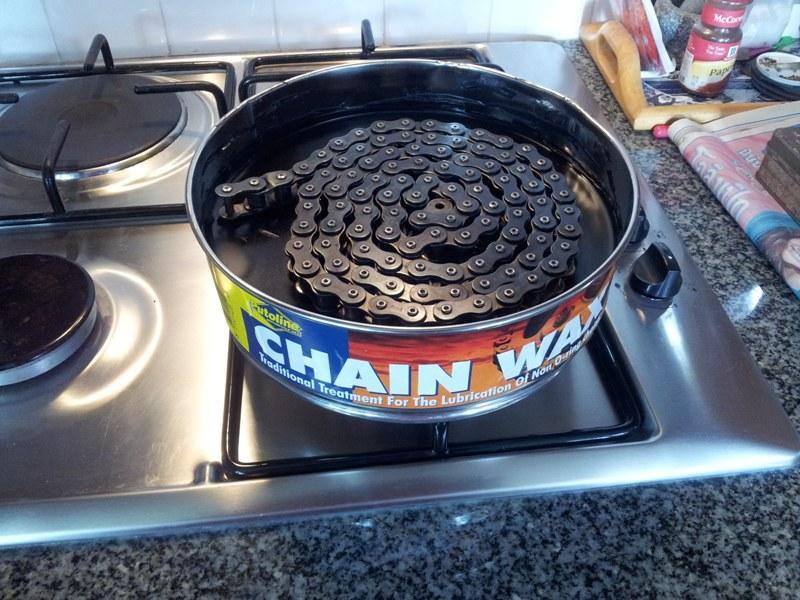

  5. I remember back in the day a product called Linklife, or something like that. It was essentially a circular biscuit tin half full of a solidified graphite grease that you laid your curled up chain on top and then heated it up on a small camping Gaz stove, melting the grease. The chain would disappear into the grease and after a prescribed time you hooked the chain out and hung it over the tin to catch the liquid grease runoff. When “dry” put it back on the bike. :joy:

    Back in the day of non sealed chains and split links. The advent of o-ring chains and more powerful bikes necessitating a pressed/peened link has done away with that ritual.
    I remember getting bollocking for doing my chain with that stuff on my mum's Aga...

  11. That was before the days of modern o and x ring chains i believe. That from memory was how you revived the chain.
    I remember it well. Got a bollocking for covering the kitchen in it.
  13. And look out if you forgot to put a nail through the hole in the handle when picking it up. Don’t ask how I know :pensive:
