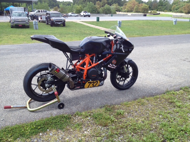

    Here is my "outside of the box" KTM 690 Duke with a couple of mods. Ay or Nay sez you? KTM withHonda.JPG

  7. I ride ot, not look at it ;)
    Yep like that Grady, from that angle, reckon a T9 or similar lined fairing would make it look better :)

    The KTM weighs 290lbs, has a hair under 80 hp and is the easiest bike to ride that I have ever ridden. Here is a pic of the front fairing and an example of how it is to ride. All SVs behind. KTM T8.JPG

  12. How easy was that KTM to do? Is it just change wheels, forks and add some bodywork to make it a race rep tool?
  13. Not to Be picky but the brakes aren't panigale judging by the pic. They look like m4 monoblocks as fitted to 848 evo 1098 etc. Not the newer m50 calipers. Lovely bike btw.
  14. Stock wheels, KTM Powerparts WP racing forks and shock, custom made sub frame (dropped 20 lbs using tubing from a Ducati crate!) Toss the airbox for a K&N, cam, pipe, ecu remap, custom fairing bracket incorporating an Ohlins steering damper, 848 race tail and fairing as mentioned, KTM EJC belly pan, clip ons and slicks.
    Bike started as a 2013 KTM Duke690.
    Front geometry is off a ways for road racing but the light weight compensates for it somewhat. Considering a Framecrafters GP build this winter to lose more weight and fix the engine position and geometry. Project is already out of hand so why stop?
