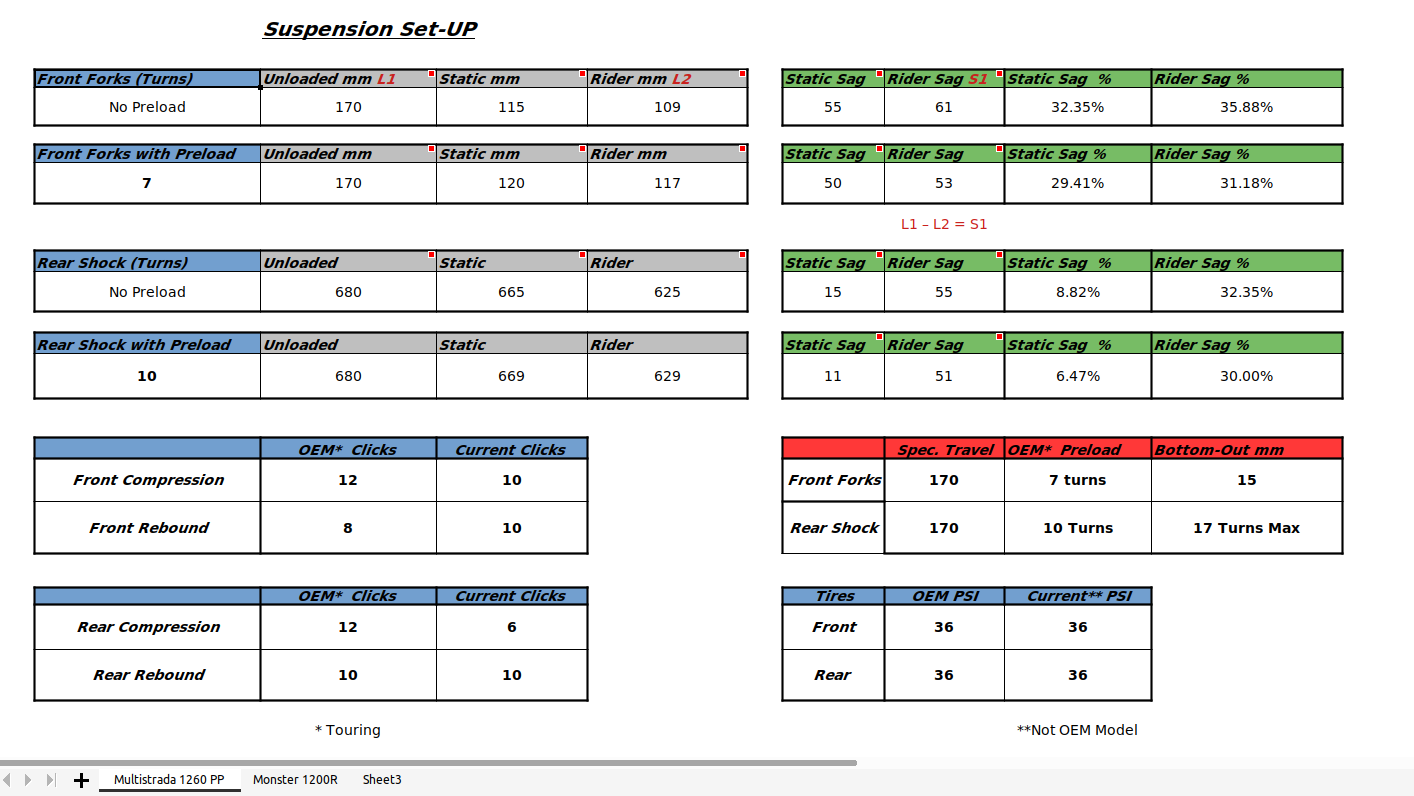

    More importantly: What's your Rider SAG percentages fore and aft?
    The fore-aft balance should be close to equal although some, myself included prefer having a bit more SAG up front producing a slight forward pitch.
    Although this chart and settings thereof are on a manual Ohlins suspension set-up for my Multistrada 1260 Pikes Peak, you may find it useful.

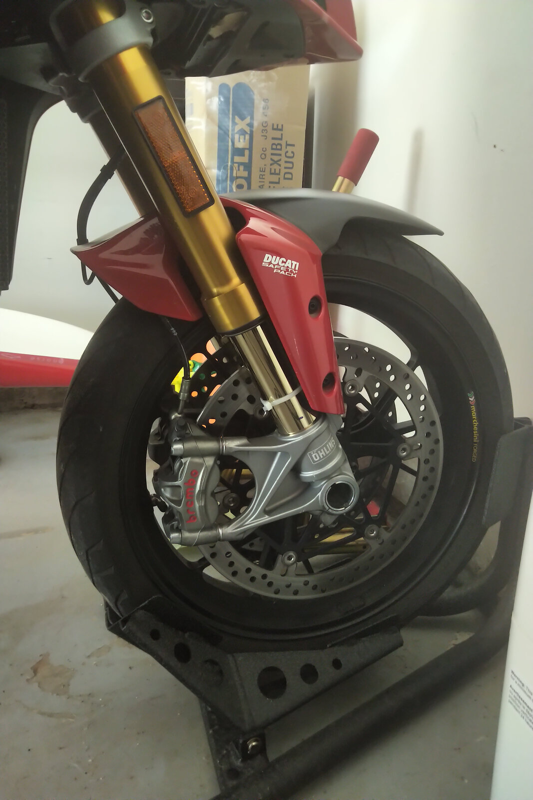

    FYI: I'm 177 lbs / 80 Kg in full leather gear (160 lbs / 72.5 Kg without). No pillion, All twisty back roads riding. Angel GT tires.
    As you can see, I'm using 3/4 of the fork travel measured to the bottom-out mark above the fork casting and that's while riding on smooth roads without pushing it. If riding more aggressively or on rougher roads, the zip-tie drops another half inch. In an emergency stop, my zip-tie drops to just above the bottom-out mark.
