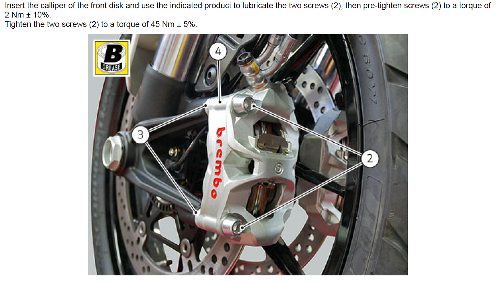

  2. I managed to find a '22 MTS V4/V4S workshop manual online. Here's what it says for caliper bolt torque:

  3. Here's a few off the top of head, that I've used on all my Multistrada's, think they came from a 1200DVT workshop manual, nothing's fallen off yet.
    Front Caliper Bolts 45nm
    Front Axle nut 63nm
    Axle pinch bolts, PP Ohlins, 19nm
    Fr. Disc bolts. 30nm
    Rear wheel nut 230nm
    Rear Hub pinch bolts 35nm
    Rear Caliper Bolts 25nm

  4. There is a process for doing up the front brake caliper bolts:
    o Refit callipers with spacers, torque to 2 Nm
    o Pull the brake lever many times
    o Hold brake lever to the bars and torque to 45 Nm
    • Useful Useful x 3
  5. That's great, thanks all. The calipers and bolts are the same as the V4S but the fork lowers are different (Ohlins). Is it still 45nm?
    Being a Ducati newbie - where do you normally get the work shop manual from? Do I need to contact my dealer?
