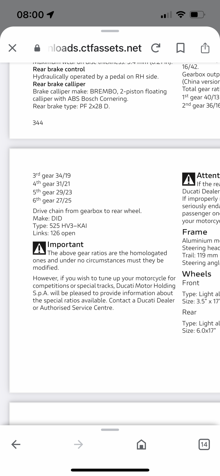

  17. Anyone know the spec for the drive chain? i.e. gauge and number of links.
    • Useful Useful x 2
  19. Hmm, I want to replace the standard chain with an RK ZXW in black but can’t find one that’s 126 links.
