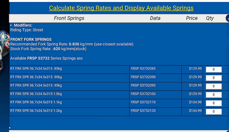

  1. RT - Digital Product Search
    [​IMG][​IMG]

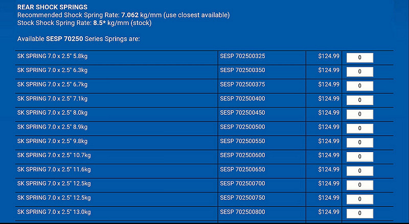

    It's a starting point anyway. Give some of the UK suspension people a call, some are unhelpful wankers who can't be arsed to look stuff up in detail if needed but others better on the right day. They'll tell you what Öhlins K-Tech whatever recommended plus the choices mentioned by @Desmoquattro . They all give slightly different numbers and some moan about the RaceTech numbers but they're all in the right ball park.
    You should be OK on you're own from here.

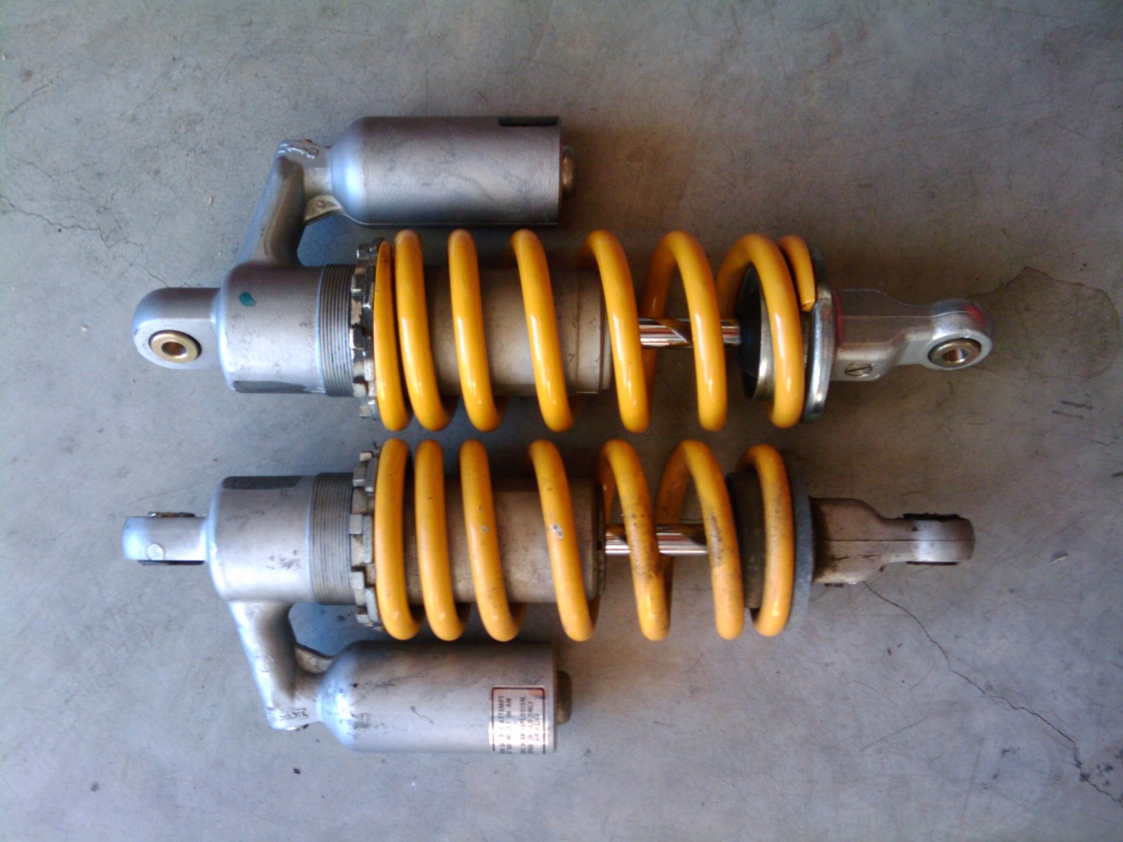

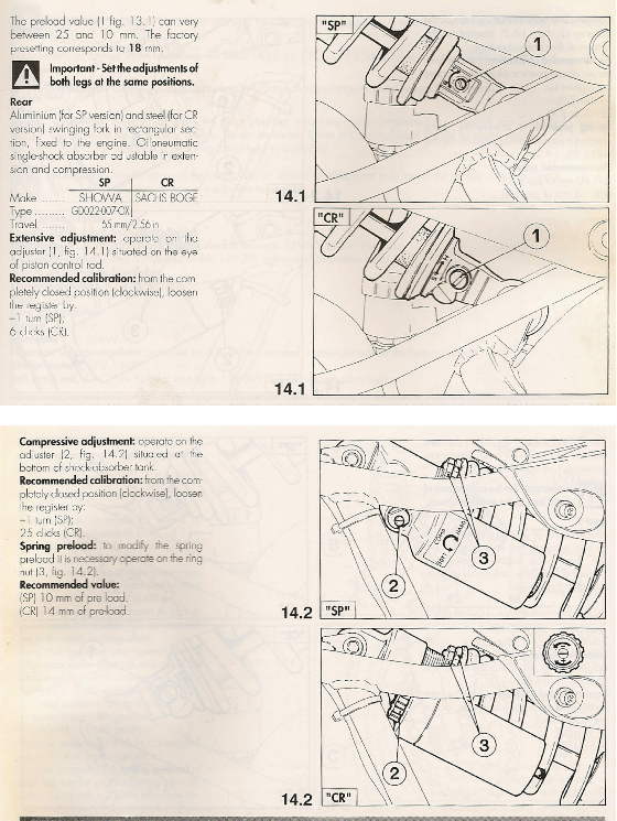

  2. See pics.....
    The one with the pair of shocks shows Showas..........the shorter one is from a carbed SS and the longer one is from an IE.
    The other photo shows a Sachs Boge shock......I never checked the length so it could have come from either a carbed or IE bike as it was fitted to both models at various stages.
    Also see the text and images........It is fairly obvious which shock should fit which swingarm.

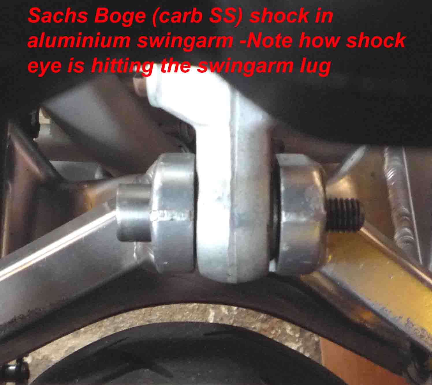

    If you have a Sachs Boge shock in an aluminium swingarm, makes sure the eye of the shock cannot hit the mounting lugs on the swingarm as you twist it.

    Your pic of the three shocks seems to show that the Sachs shock has a different twist to it compared to the Showas. Compare the bottom mountings of the topmost Showa and the Sachs (which are lying in the same position) and you can see that the bottom mounting eyes are oriented differently?

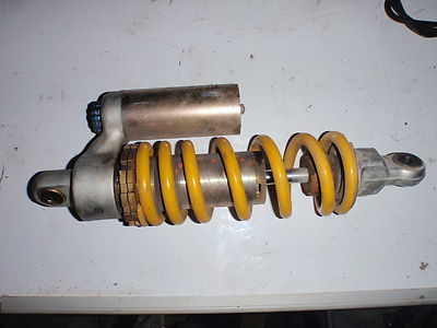

  4. The Sachs Boge shock has the blue adjuster and a 'can' for a reservoir.
    The Showa shock has a reservoir which is part of the shock body casting.

    But if you have an aluminium swingarm you should check which shock is fitted as the Showa shocks have smaller diameter bottom mounting eyes which can hit the swingarm lugs if the shock twists on it's bearings (which it should do BTW).........a big bump and hard suspension could result in a broken swingarm lug....see photo.
    A steel swingarm should be OK with either shock fitted.
    Both the carbed SS shocks have 65mm travel.
    IIRC the IE have 71mm travel or 76mm travel, so as long as you get one of these you should be OK.

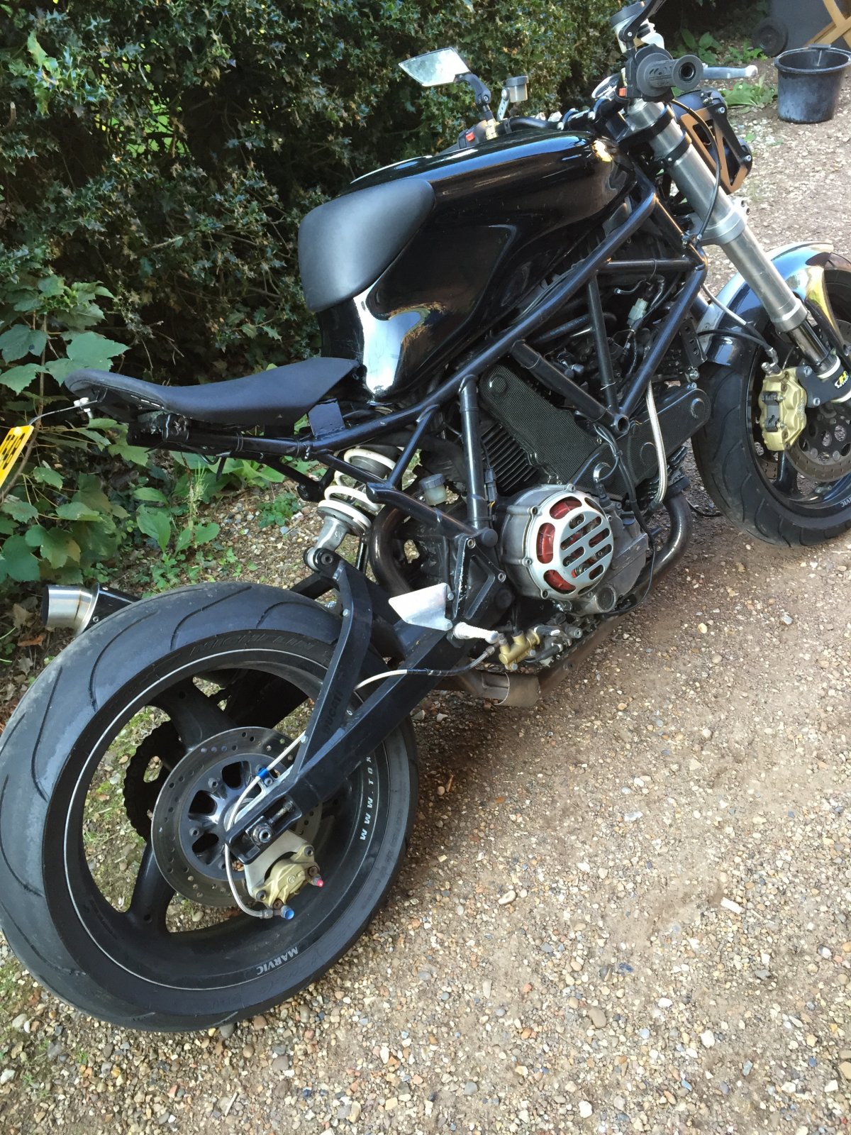

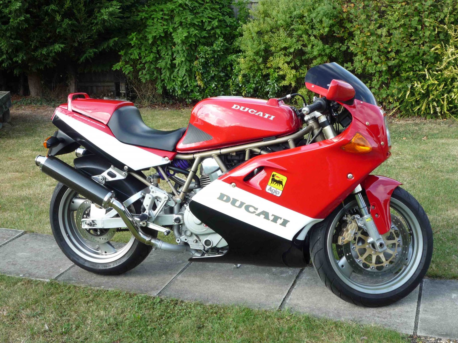

  15. .....and mine is powder or plasti-coated.
  16. Oh....and the shape.............see mine below...........If yours is coated, I guess steel.
    Don't even ask about the purple spring...........;)

  17. The two arms in those pics of yours look different. Is that intentional?
    Noted what you said about the adjuster blocks and on that basis I presume, in the absence of access to either the bike or a magnet at the moment, that mine is aluminium

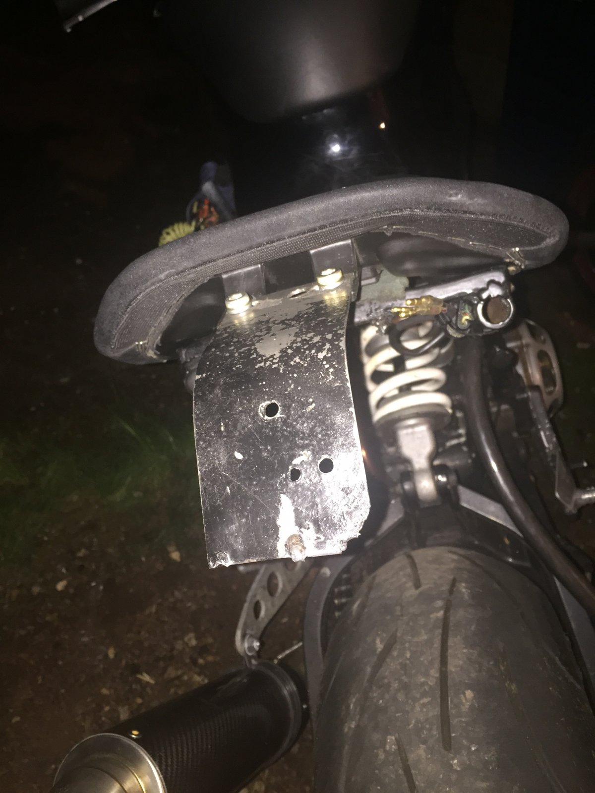

    #38 Zhed46, Oct 5, 2015
  18. It's aluminium, with the deeper brace (better brace).
    It also looks as though the shock mounting lugs have been reduced and rounded off........
    .........I can't say whether that's an OEM modification or owner modified, but it might have been done so a Sachs Boge shock could be fitted.
  19. Piccie of the shock mount
