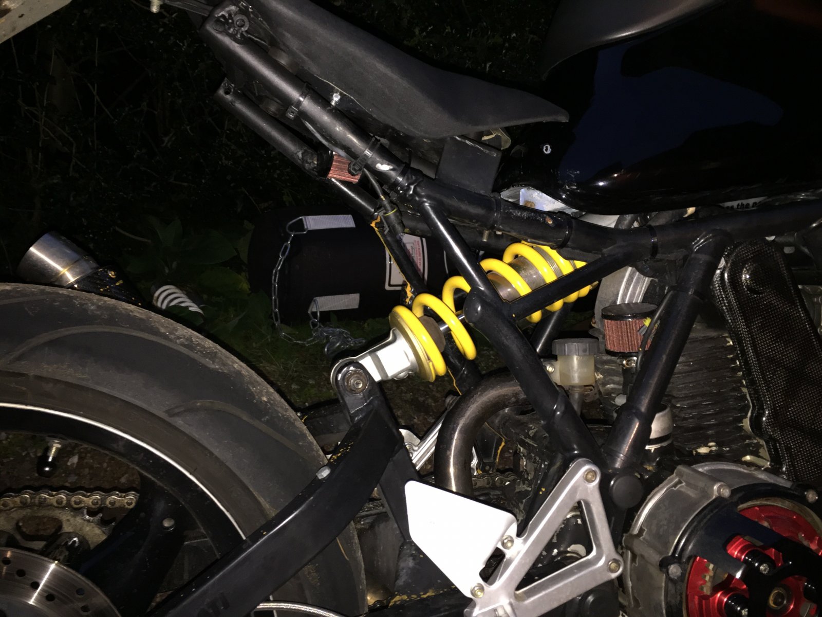

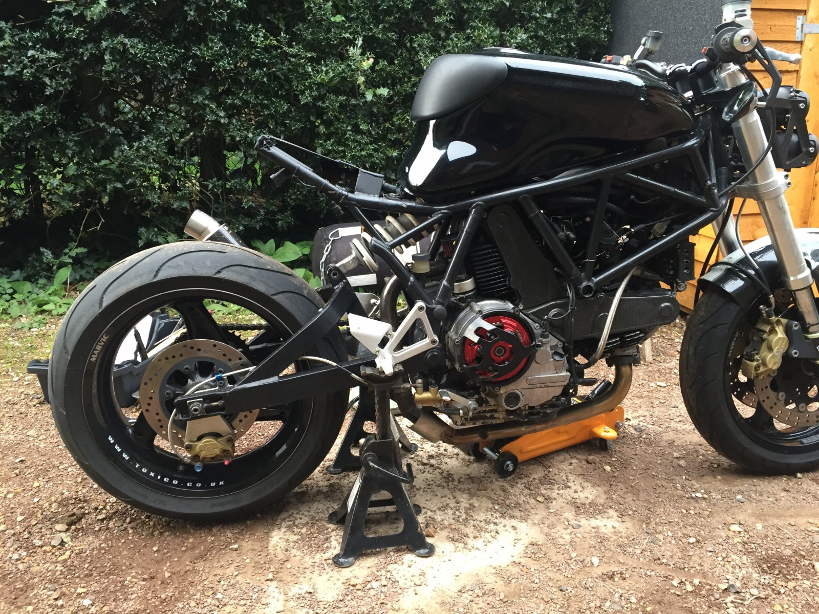

  7. Shock arrived and it's pretty much mint. All fitted ok, although the 900 looked a bit precarious perched on the axle stands I used to prop it up.
    I put it on standard settings before fitting and a long test ride on bumpy and rutted roads showed that while it could never be described as plush, and it's still a little on the firm side for me, it's not a rock hard, spine jarring nightmare like the one I took off.
    Thanks for all your help guys

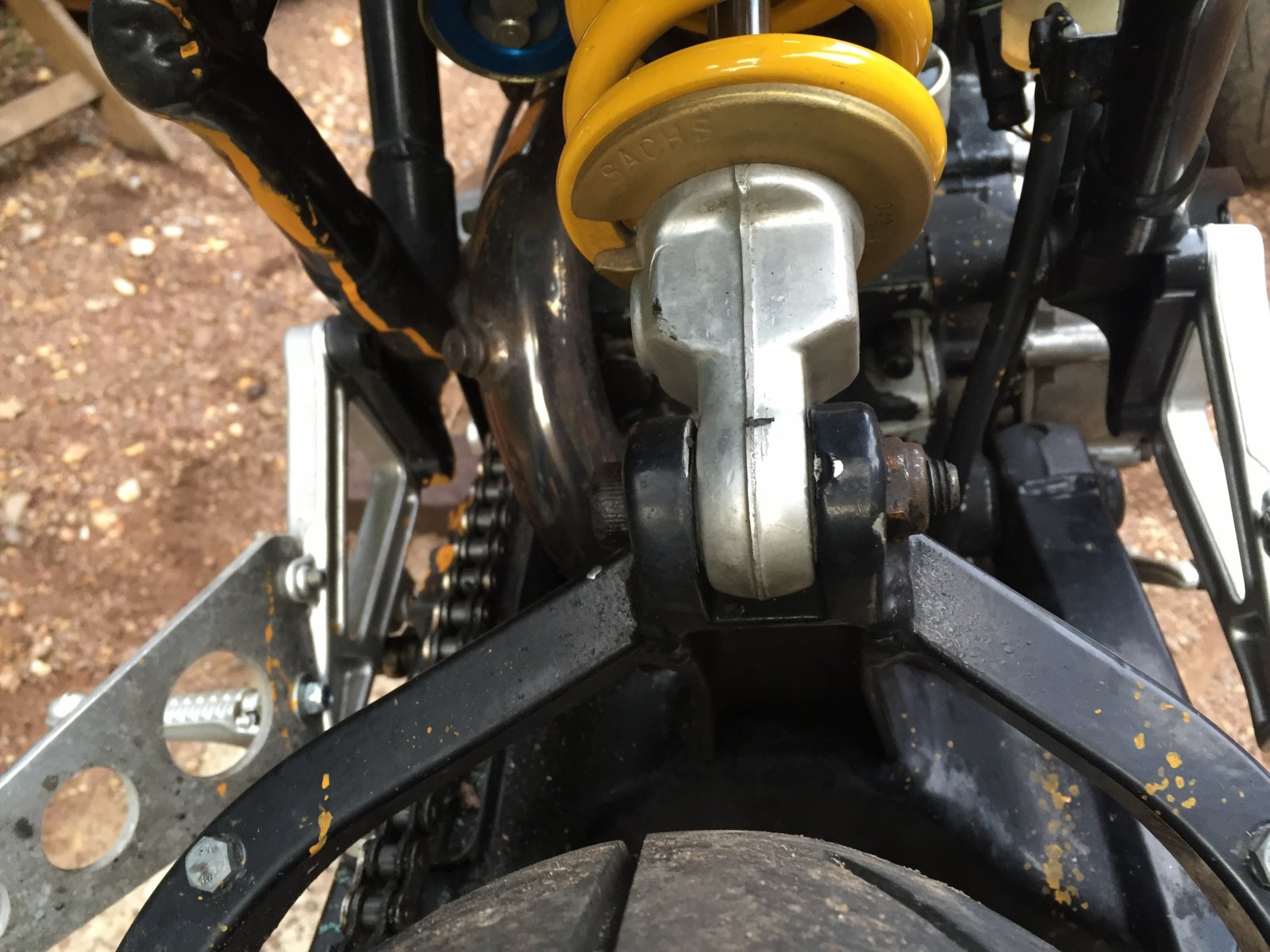

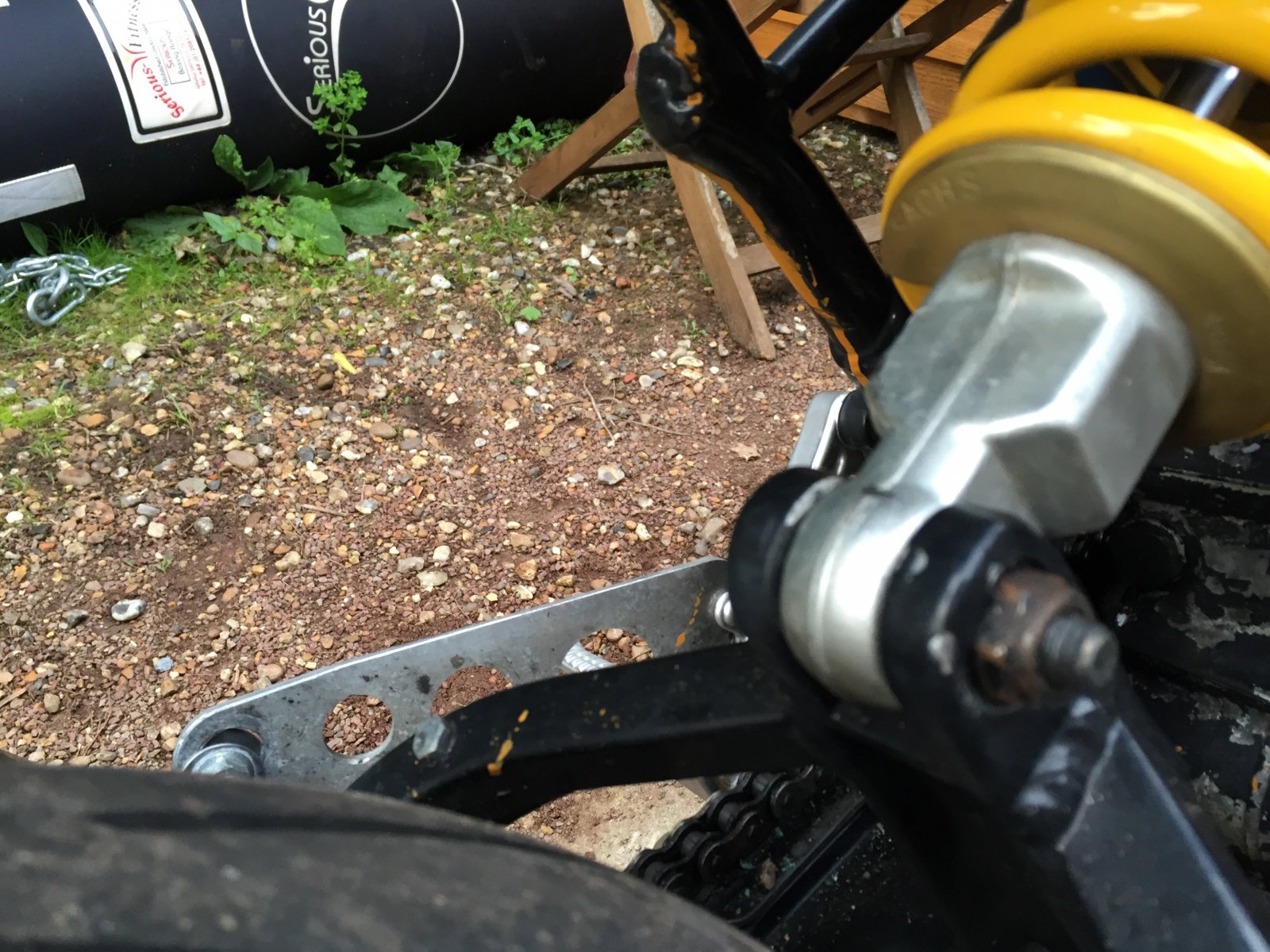

  8. If you grab hold of it and turn it anti clockwise and clockwise, does the alloy eye of the shock hit the swingarm lugs......?
  9. No. I tried that as soon as I fitted it and there is enough clearance to get my thumbnail between the shock alloy outer eye and the swingarm lug. It seems like the shock is fitted with a pretty thick bush (70s stylee)
  10. if you mean a bush as in metalastic bush ie rubber and metal
    it should be a spherical bearing like in a rose joint or rod end
    and a top hat spacer either side
  11. I was typing one handed in a hurry and couldn't think of the proper term. But yes, it's the latter.
