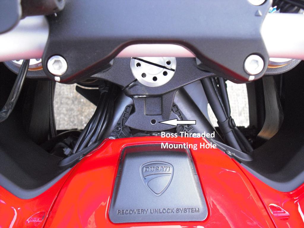

  9. An update on this thread now I'm back home and on the laptop. Bike is at my supplying dealer which is M&S Motorcycles in Newcastle Upon Tyne who are as always first class.
    While I was in M&S Motorcyles I looked at various used and new Multi's from 2010 with 27k to new 0 mile examples, none show evidence of any type of threadlock. The Diavel by the way has "Hands Free" locking but has a "Lug" cast onto the underside of the top yoke.
    Just in case anyone hasn't followed the previous threads or may have been distracted by the "Trolling" from certain people here is a full explanation with pictures.

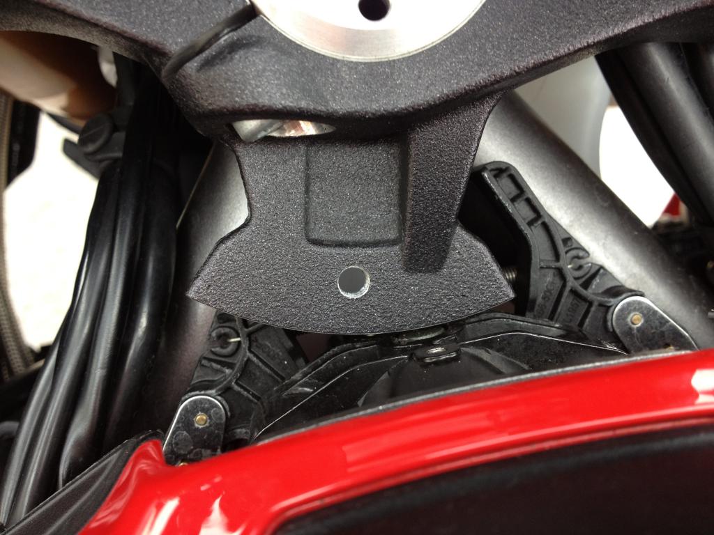

    The first image shows a view looking down at the tank, the small hole highlighted is the threaded hole where the metal boss is screwed into from underneath.
    The second image is a closer view of the threaded hole, when the boss is in place this hole just looks like it has a silver rivet in place.

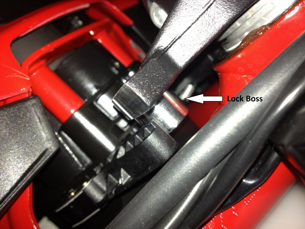

    The third image shows the actual metal boss as viewed from the side.

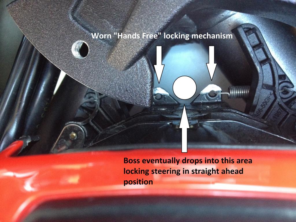

    The last image shows the wear on the "Hands Free" locking mechanism. This can obviously only be viewed when rhe bars are turned either direction. It also shows the position that the "boss" dropped into to lock the steering.
    Some people on here mentioned the feeling of flat tyre or head bearings, yes I did feel that when I slowed to filter through traffic in a traffic jam, remember these bars are big and wide with a lot of leverage. If I had just been merily barreling away down the motorway and had to take avasive action or take a slip road then you wouldn't have made it.
    The if's, where's and whyfores don't matter, it happened, end of.
    You can check this by using your fingers "just" but you cannot get a tool underneath to check if it's tightened correctly or to re tighten it.

  16. +1, after 17k miles mine doesn't appear to be going anywhere, but a) what a crap design and b) it is a lot smaller and less accessible than it appears in the photos. Feel like wrapping insulating tape around it now!
  17. Or top yoke off, drill it and put a grub screw in to secure it, or more simple thread lock but the top yoke would still need removing as access as you have seen is near impossible.
    See what Ducati come back with, I'll keep people informed.
  18. Centre punch the thread.
