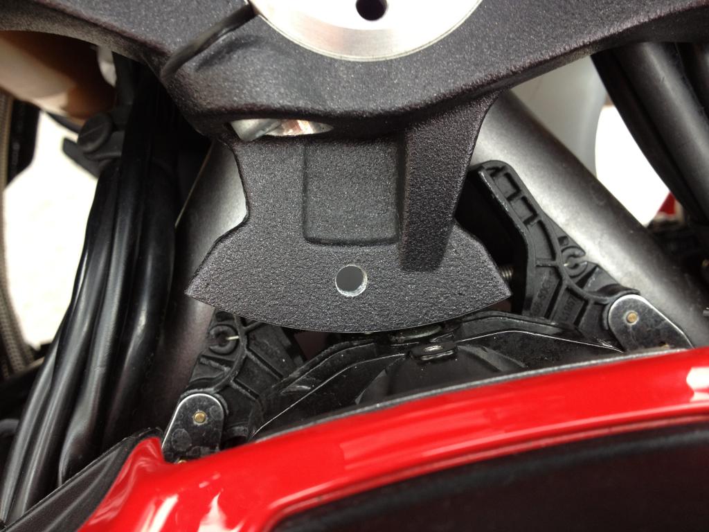

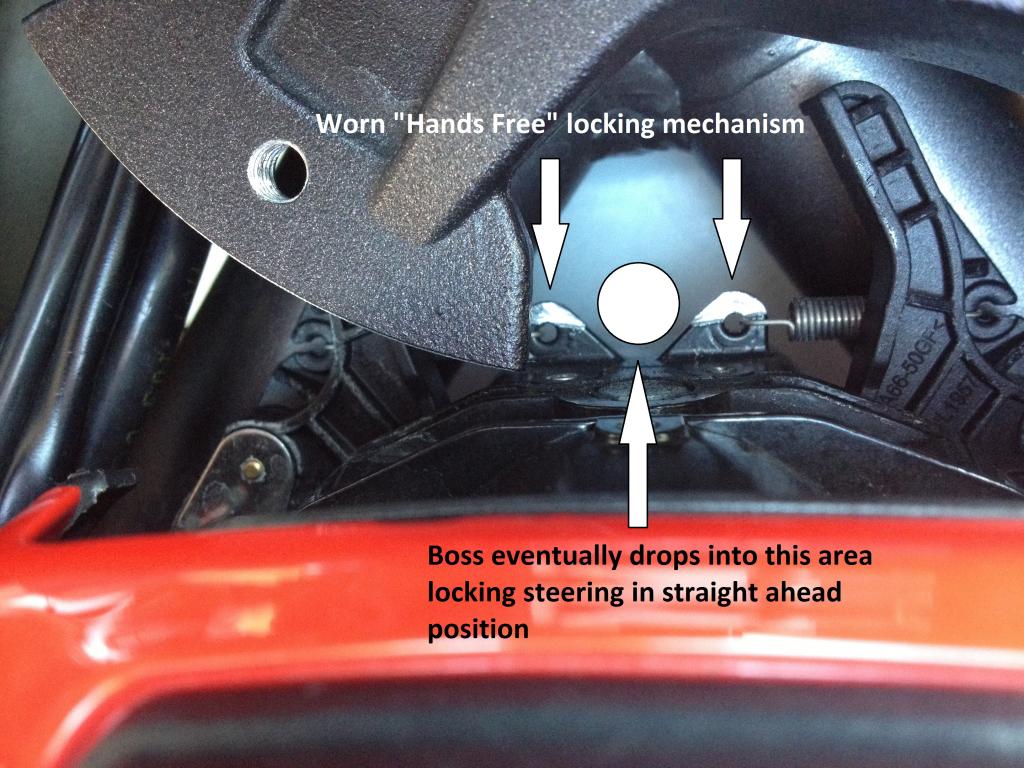

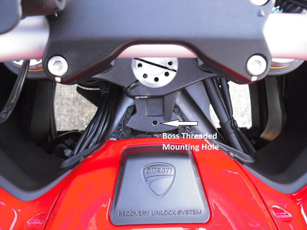

  4. Depends what you mean by "Pre Ride Checks", tyre pressure and chain tension get done once a week, bike gets washed after pretty much every run out, which means getting up close and personal as your washing and drying, oils and fluids and a good once over. I didn't notice anything untoward when I left the house and I did 100 straight line motorway miles which would not have highlighted the concern. It's only when after those miles I went to filter through stationary traffic which meant a bit of swerving that I noticed pretty quickly. I've just returned from a 2500 mile round trip to Italy and nothing fell off or broke. Like I mentioned in my above picture filled explanation, all I do every day is mechanical and electrical engineering activities so if anything is out of place I will usually find it, and I found it immediatley after I got the symptoms of flat tyre / head bearings. A quick visual for future reference would be that the thread is pretty much flush with the top yoke, if any threads are showing then the bolt is on it's way out. But it's not an indication that the bolt is tightened to the correct torque, so be aware.
  5. Just looked in the parts manual and it lists the part as a "pin" and the part number is 821.1.329.1B
    It's item 33 on the below parts breakdown.

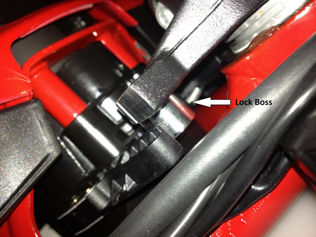

  9. A quick update regarding my issue.
    Popped into M&S Motorcycles this afternoon to drop off the red key and was informed that the "Pin" is supposed to be threadlocked.
    So, missed operation on my bike maybe.
    Unless you have a mirror on a stick and a torch it would be difficult to tell, next time i'm in M&S I will take my mirror and torch and inspect a few to see if indeed the threadlock is visible.

  10. Thanks for all the information Stu and for putting on such clear labelled photos :upyeah: Good for those of us that don't know what end you should hold a screwdriver!
    It will be interesting to find out if Ducati send out a service bulletin or just leave it as a freak incident.
  11. Great warning post Stu. I'll definitely be checking mine as should everybody else. Appreciate the forensic pics too, really helps.

    Given the amount of cable drag on this bike going lock to lock you'd be hard pressed to notice this during a straightish journey. It might have started to feel like headstock bearings before it finally "set you straight". Don't forget the bars hardly move once you are above 30MPH. The wear shown in the photo could easily of occurred during one journey, so a pre-ride check may not have noticed anything. Very scary and yes I agree not designed with failure in mind.

    Note if you fit the Ohlins steering damper you can't even see this bolt!
