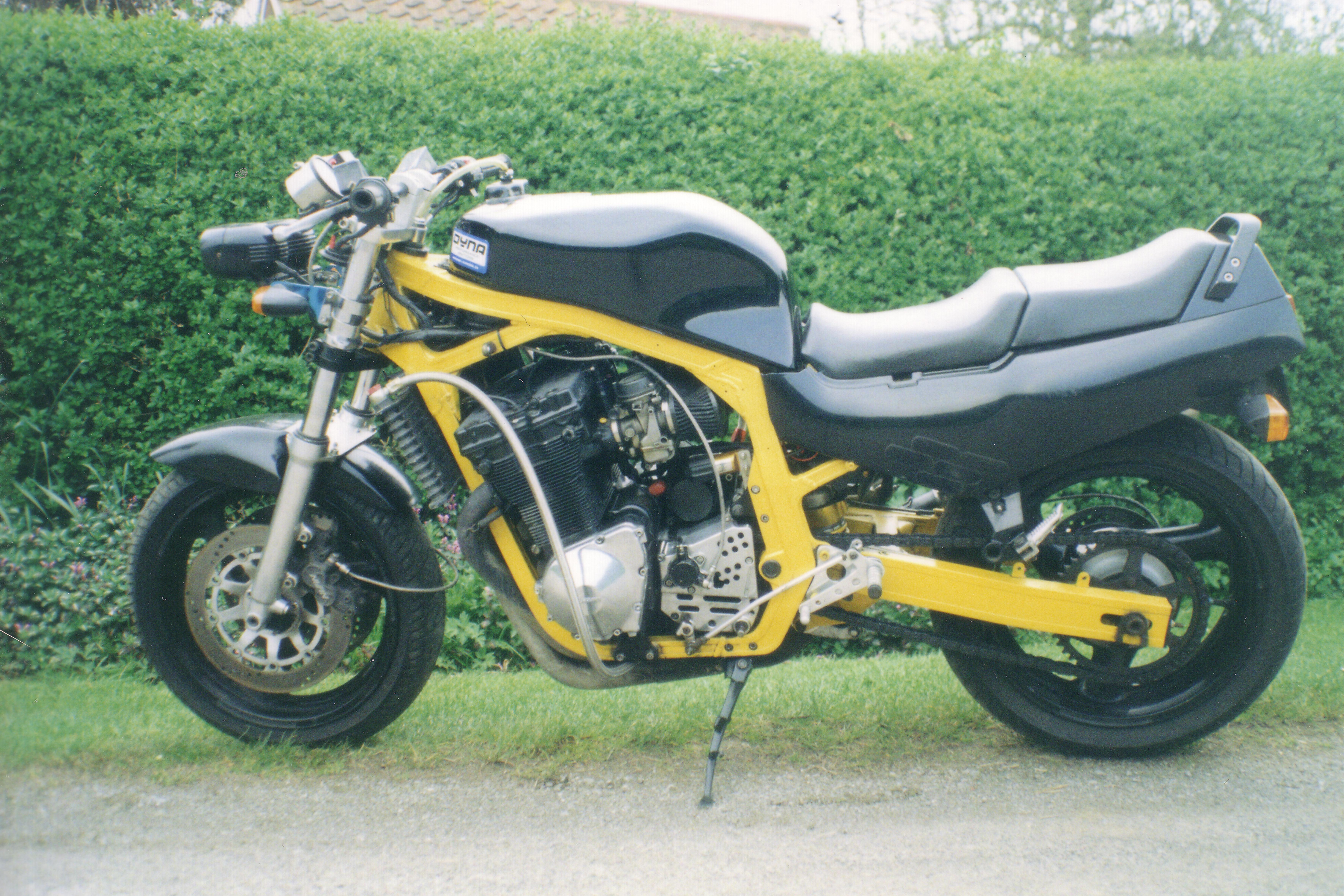

  4. Again - I thought that but so Chris the mechanic at LouigiMoto's tells me that's a no....the main reason (his words) is that the air need to be "Shaped" to be dragged into the throttle body's smoothly, hence the rolled edges...
    Goes against the grain of what I thought as years ago my old GSX-r 7-11 had K&N's bolted straight on to the slingshot carbs...which gives me a reason to post a pic of the old barge - quite possibly the most frightening thing ive ever ridden to this day...

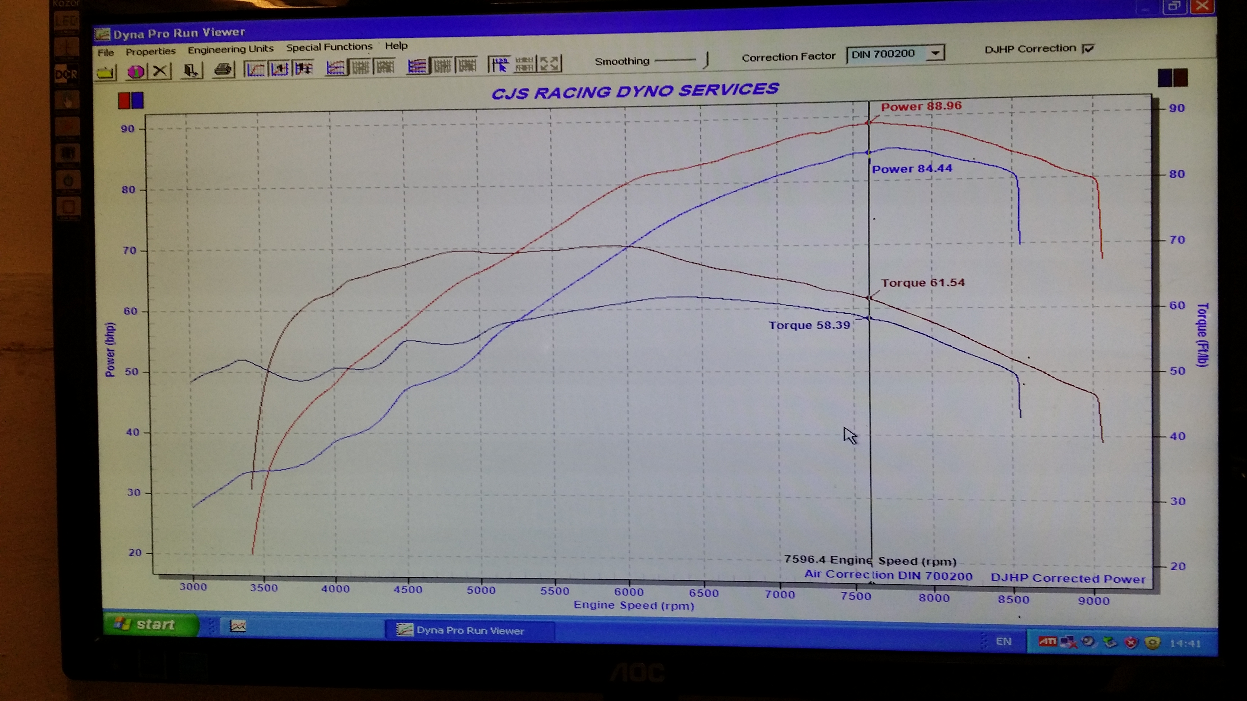

  15. Ken, did you get it mapped by a pro or just use one of the freely available maps? Because I have a pc on my SS and it's transformed the bike, making the fuelling below 3k really smooth and useable. When I first got the PC I tried the standard maps for open pipes and filter but they were crap. after shelling out for a custom map it's beautiful throughout the entire range (as you would expect after investing the cash).
  16. Yeah that was me. They made me stick the medical pass on it for parking and enter paddock. with the dark screen it was only place I could stick it. Where did you see me?
  17. it was set up on a dyno by a professional
    yes it is better than standard, but not as good as a properly set up mikuni
  18. Just goingto
    Just going to wake this thread up again.....
    What's the advantage of disconnecting the O2 sensor ?
    Did you change your airbox setup before this dyno ?
    Cheers
  19. Once it been dyno'd the o2 sensors are unplugged otherwise they try to "correct" the newly flashed ecu.
  20. Ah thanks. So are most of the aftermarket fast flow air filters up to the job ? and I guess the pcv is on the same level as the re flashed ecu ?.
