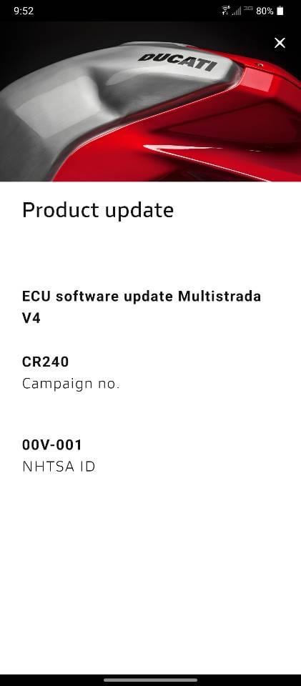

    I just called my dealer and asked - he went through improves throttle response on key off, improved reaction on display of RPM and gear selector. Nothing really exciting.
  3. That’s not my dealer. That came from the V4 FB page.
  4. What does throttle response on key off mean?
  5. Wonder if that includes settling my rpm needle down. It does wobble a bit
  6. From a forum:
