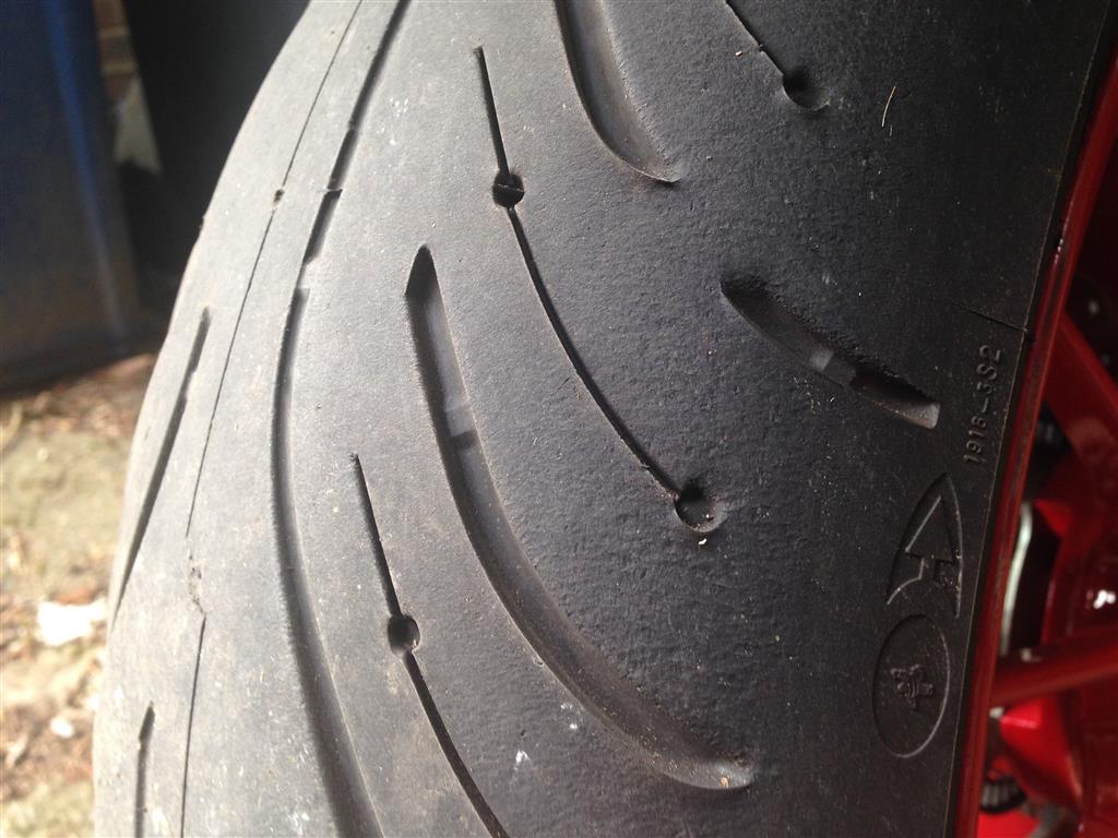

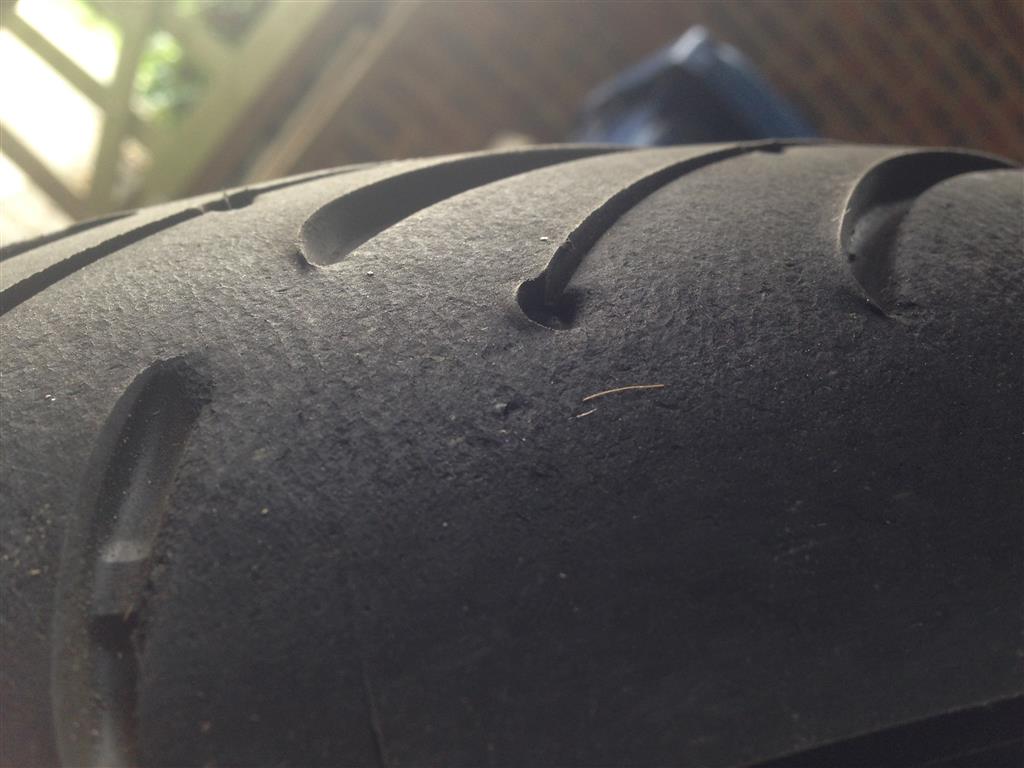

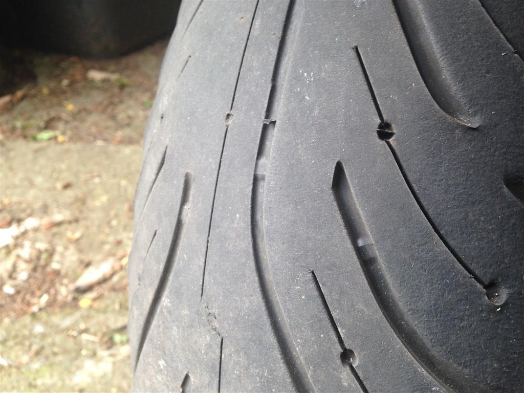

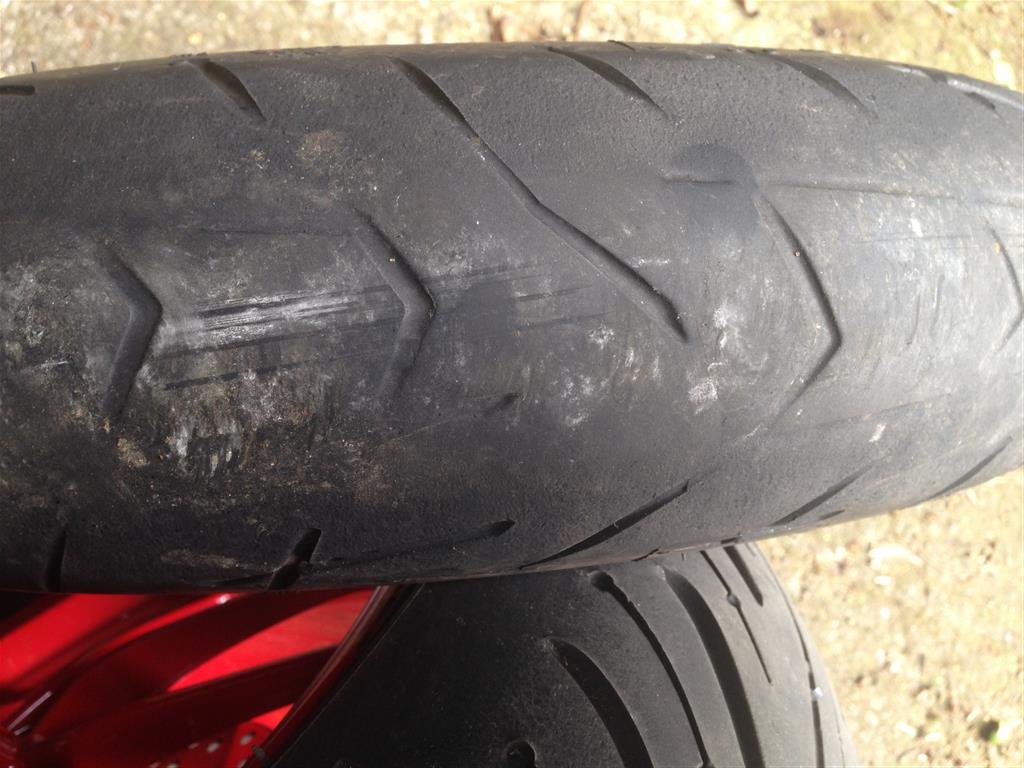

  8. here are some pics of my PR4 rear tyre, after 2k4 miles.
    And one of the front too, 4k miles.
  9. I have found the wear mark from Donington, which was a thousand miles ago nearly, hasn't yet been worn off on the rhs. Surprised it hasn't cleaned up yet
  10. But that looks crap after such small mileage john
