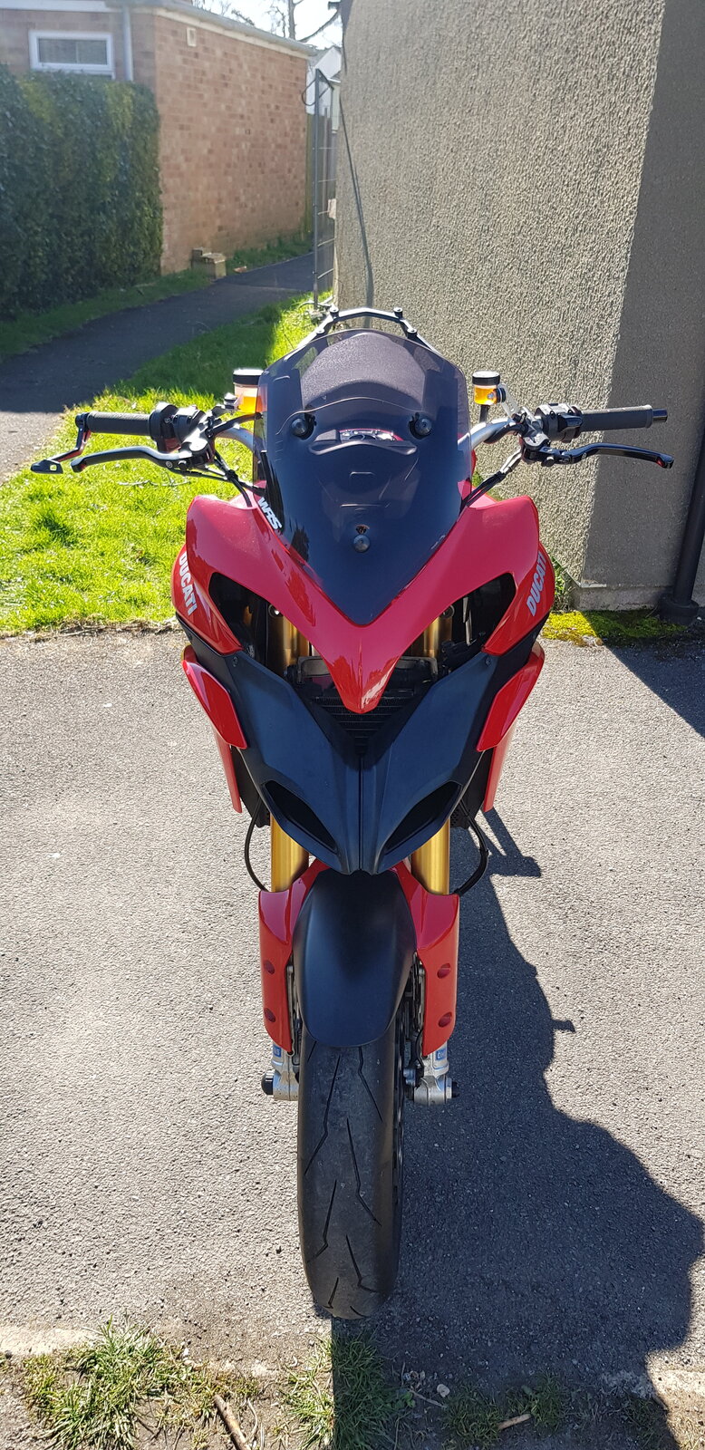

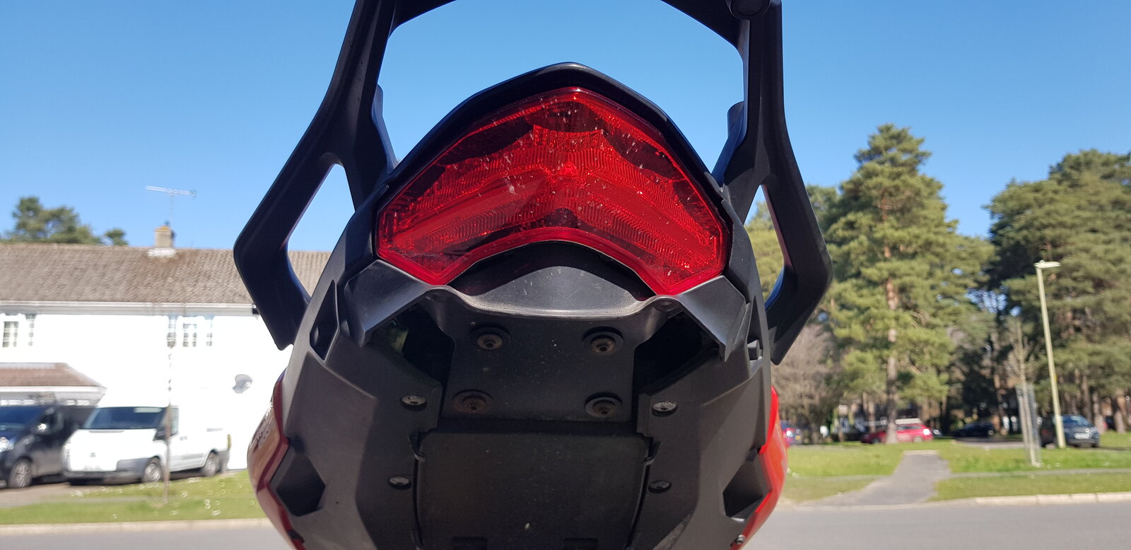

    It looks very purposeful but I’m still undecided about cutting the cast plastic rear grab handle/plate mount off as it gives anyone recovering the bike from the gravel something to grab hold of :joy: I also need to come up with a deflector to stop air coming up the inside of the nose cone/screen through where the headlight unit was.

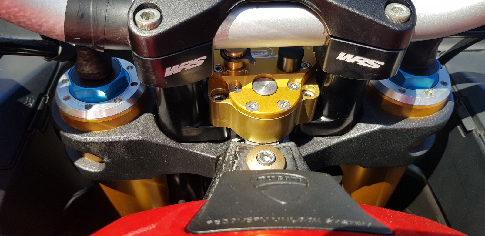

    The headstock felt very light and a bit of head shaking was noted when the front end went light on the test ride so a steering damper has been ordered. The Scott’s rotary damper marketed by WRS in Italy is currently the sensible option for the 2010-2014 Multistrada. The Ducabike fitting kit mounts on the petrol tank fixing points for the petrol cap :scream:

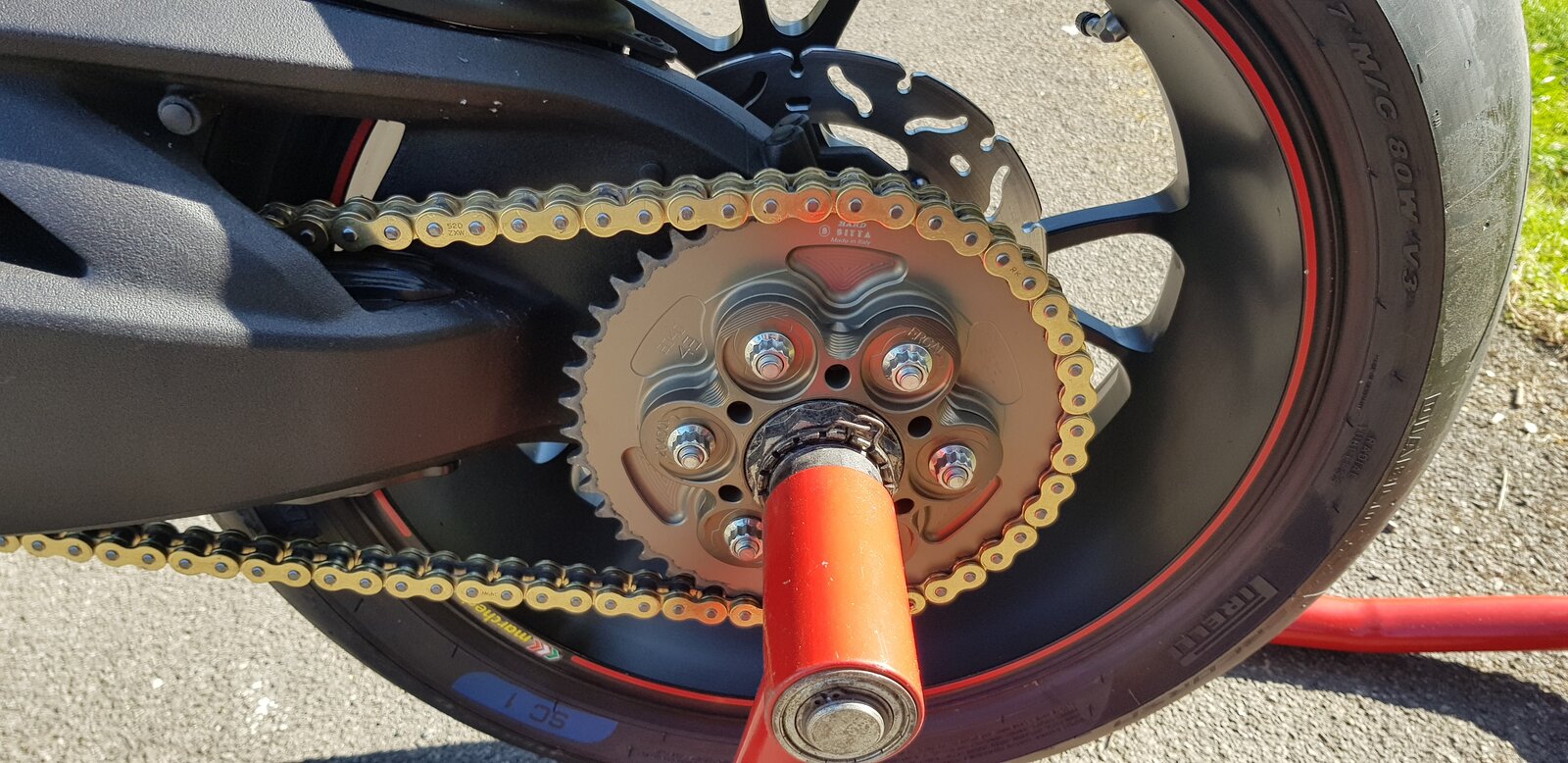

    RK Racing 520 chain
    SITTA 520 lightweight rear chain conversion kit 15T F, 43T R

    Scott’s rotary steering damper

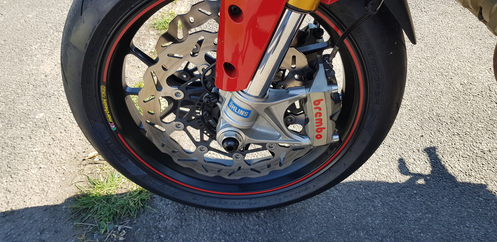

    Brembo M4 calipers (off a 1098R)

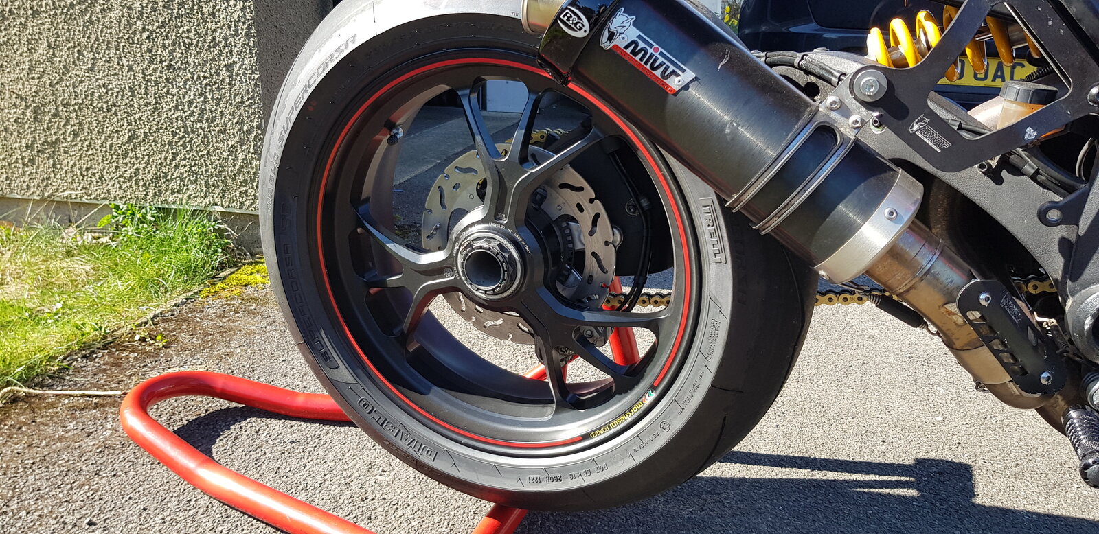

    Panigale 1200S rear forged Marchesini wheel, 200/60/17, Supercorsa SC, SC1 fitted

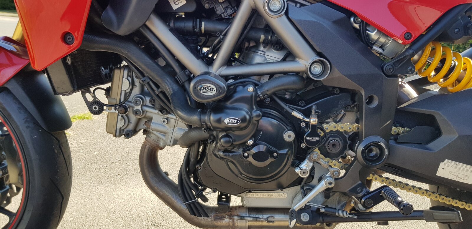

    Radiator guard
    Starting kerb weight 220.3kg
    Finished kerb weight 194kg

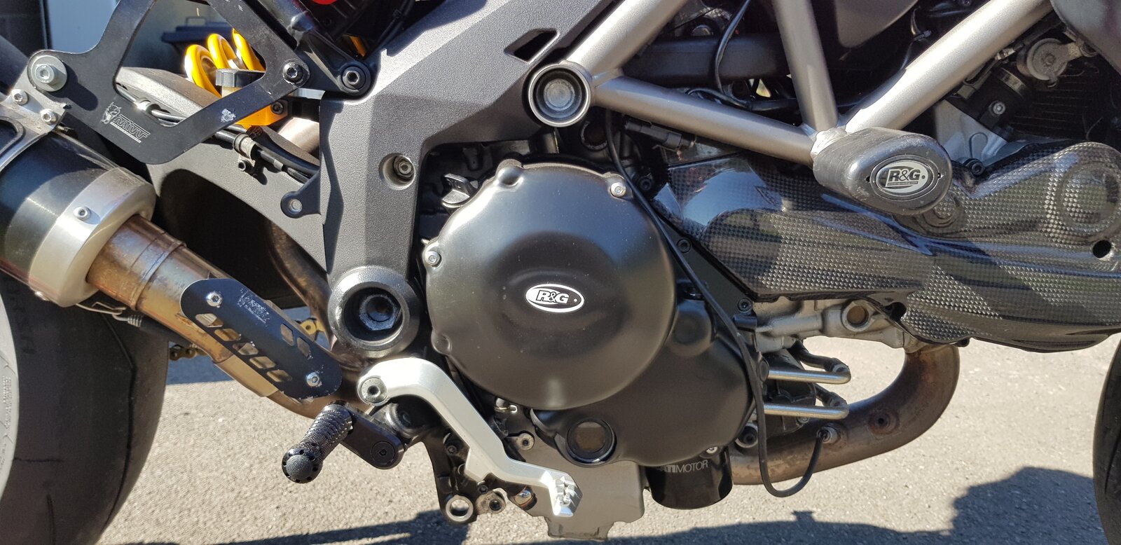

    Got a couple of small cosmetic jobs still to do, took the steel engine plates off but it looks odd so need to look at a 1 piece plastic replacement and I need to fill the gap in the nose fairing where the headlight used to be. Pictures to follow once I get the bike back home.

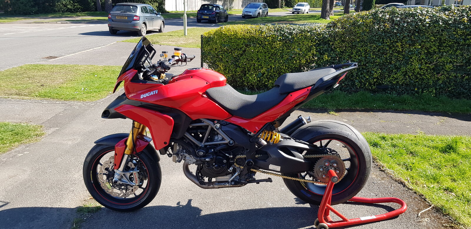

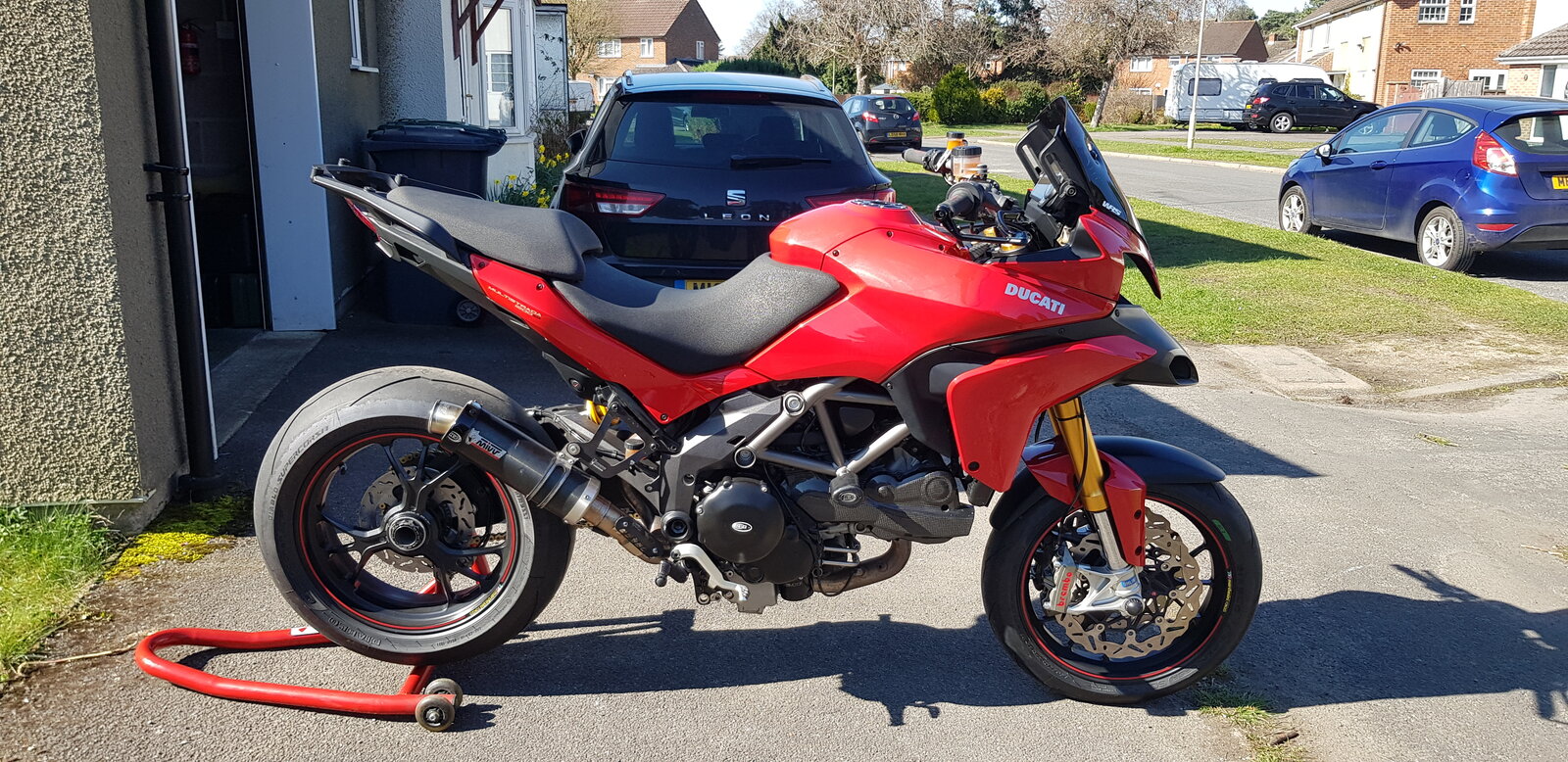

  11. Still a small amount of titivating but you get the idea :D Andy

  13. Needs a paint job. Pikes peak from that period would be good.
    And dump the rack and seat and get a seat pod fitted.
  14. If I removed the passenger grab handle, what do I use to help drag the bike out the kitty litter ? :joy: I did consider it but it’s not a show stopper. Andy

    ABS bypass is for me the way to go, pulling down from 150mph for a 30mph 90 degree right hander is a big ask. The Brembo M4’s were immense and although the Brembo SR pads wore out in 300 miles, the SBS pads I was fortunately able to scrounge from another rider, were not as good. I experienced quite a bit of judder under heavy braking all day but the pads still pulled you up.

    Using the Pirelli Supercorsa SC 200/60 rear was not the best choice. No problems with it, just that the Metzeler Racetec RR in a 190/55 turned in much quicker. I also found it difficult to get the best pressure for the Pirelli whereas the Metzeler was more forgiving of a pound or two either way. Almeria is an abrasive circuit (as @Advikaz said) and the Pirelli paid for my inexperience.

  17. I should have said, once I figured out I could go faster in 5th than 6th, the guess/choice of 15F/43R sprockets actually worked very well. I was able to use 3rd to punch out of most bends and I was comfortable reaching 150mph (indicated) by the 200m board on the back straight. It won’t be the right gearing for outright top speed on the Hanger Straight at Silverstone but I’m okay with that :joy: Andy

    Before leaving for Spain, I upgraded the front brake pads for a set of race pads from the Italian company, Braking. The braking performance was a huge step forward and I’ll not use Brembo SR’s again for the track. Sadly, I can’t find a stockist of this race pad in the UK but I’m going to try Z04’s and SBS DS2’s over the coming track days. I anticipate both of them to be equally as inspiring.
    One potential downside with later and harder braking is heat generation. The front discs are a very fetching shade of blue now. I had been looking at brake cooling ducts as mentioned in another thread but almost all the ducts available commercially either replace the 5mm caliper mounting spacers for 330mm discs to mount to the duct to the bike or, as in the case of the CNC offering, only direct air at the disc and not the caliper/pads. After mentioning my dilemma in passing to a knowledgeable friend, I have now invested in a set of JPB (Jason Pickford Brakes) ventilated, Ti pistons for my M4 34 calipers. Boys and their toys :joy: Hopefully I’ll have the mod done in time for Silverstone.
