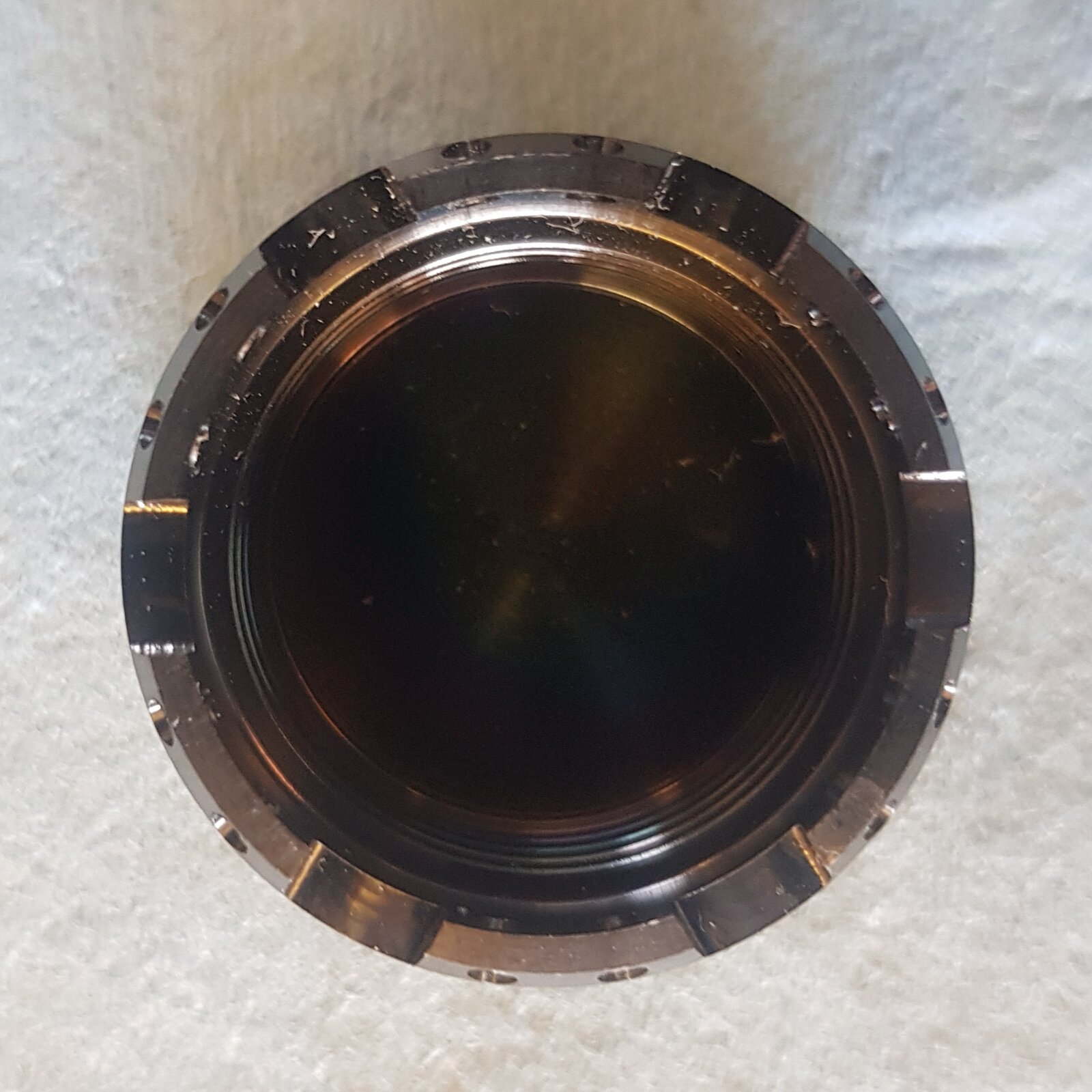

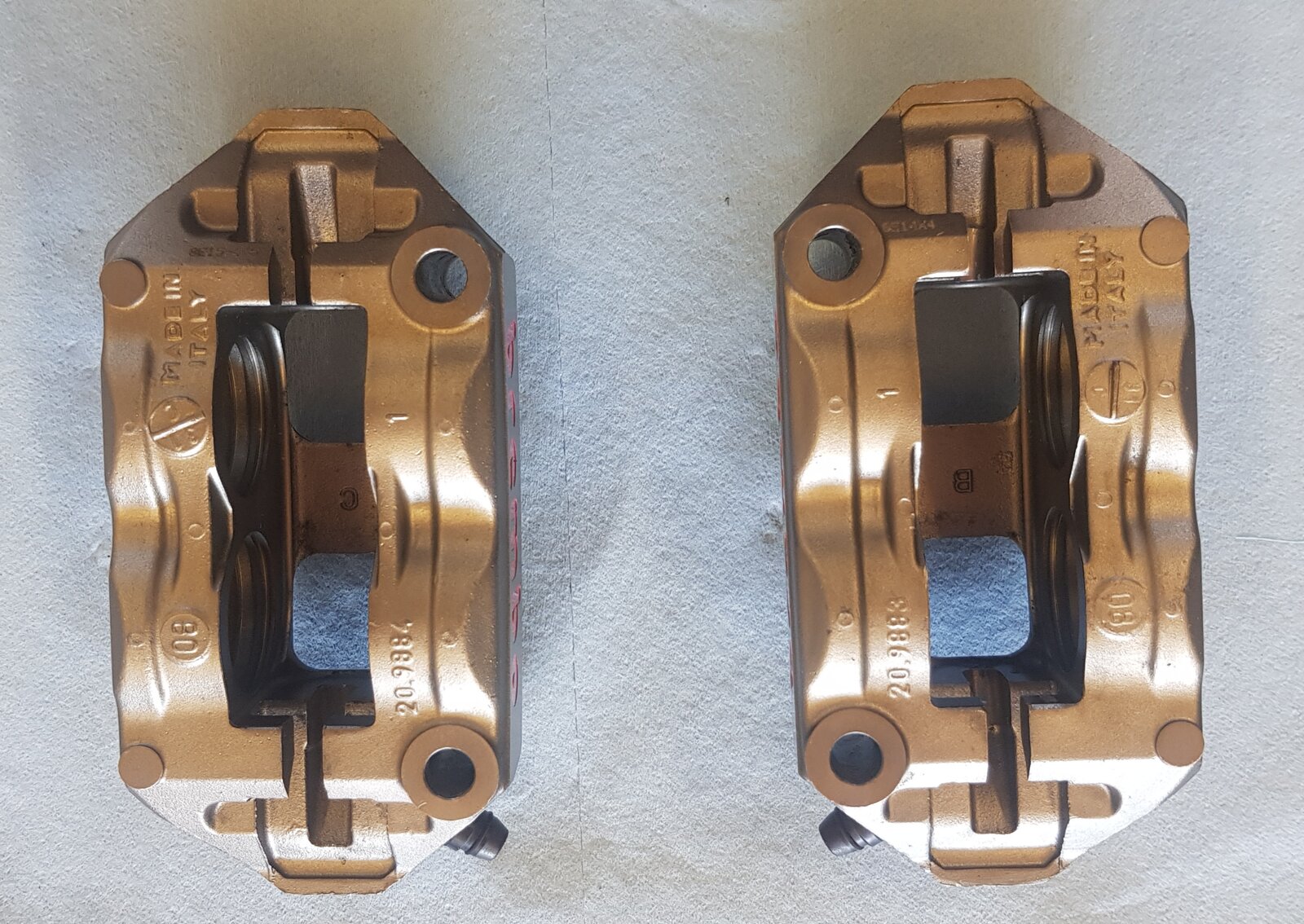

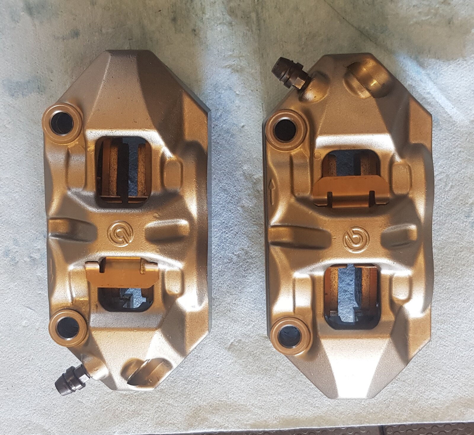

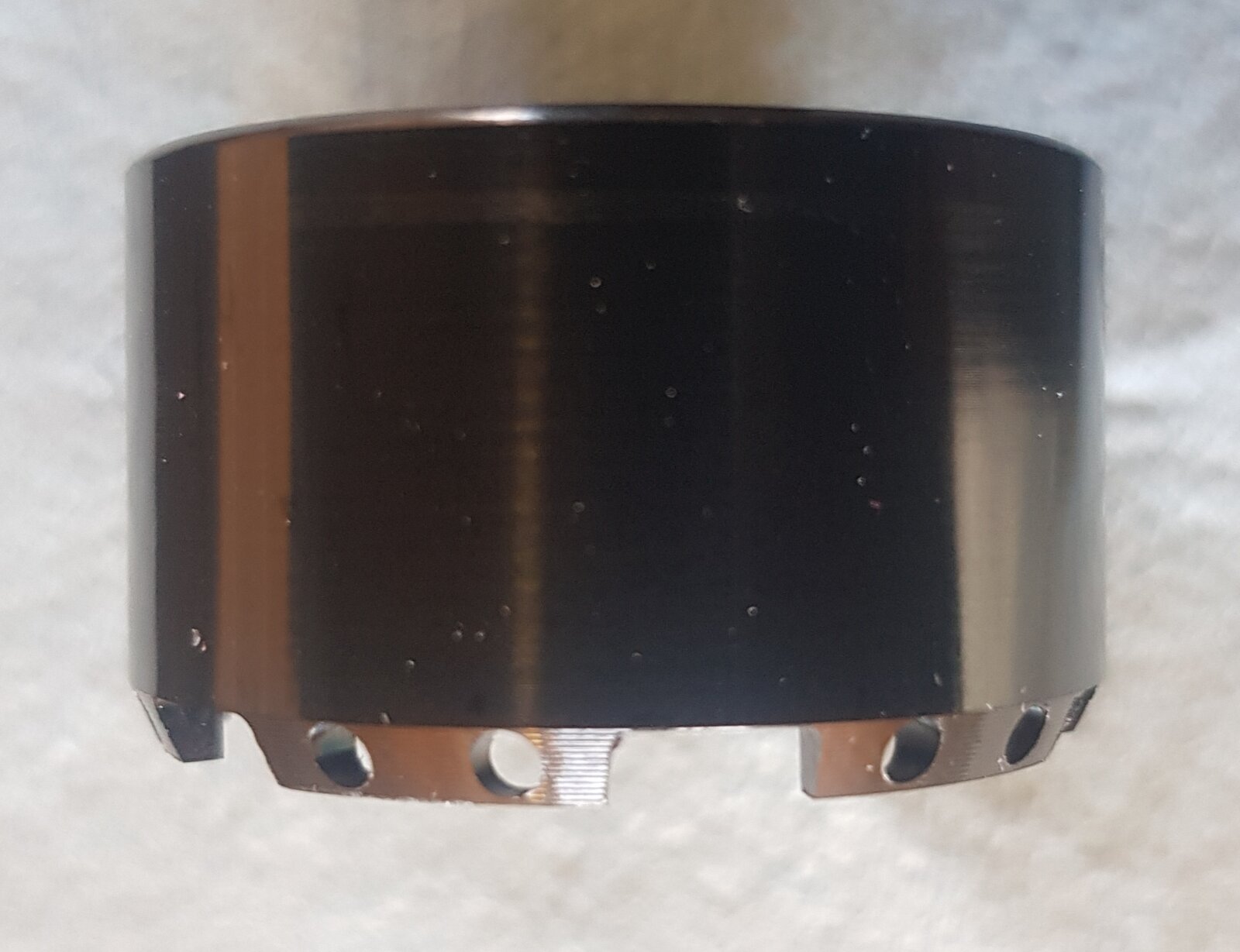

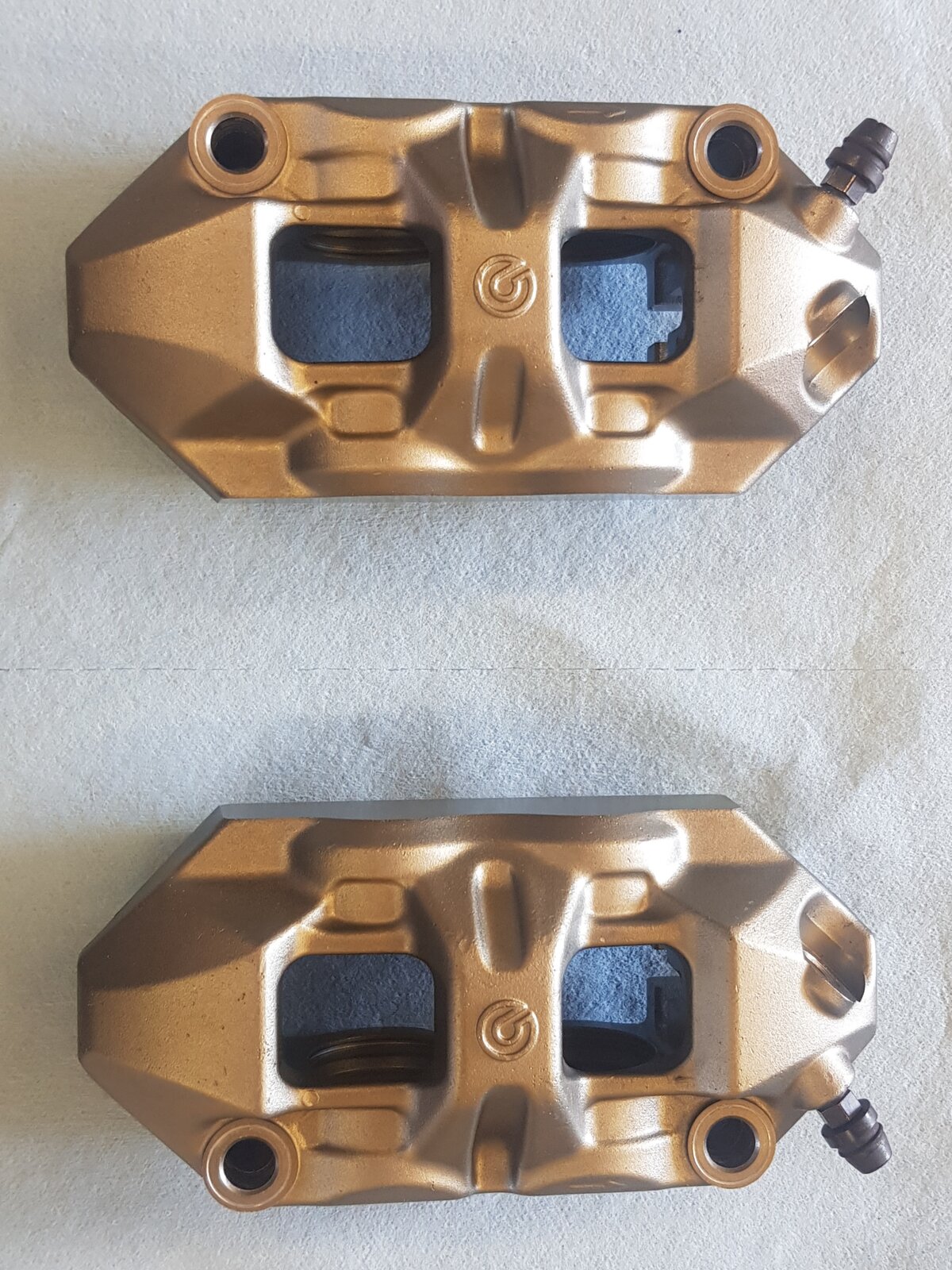

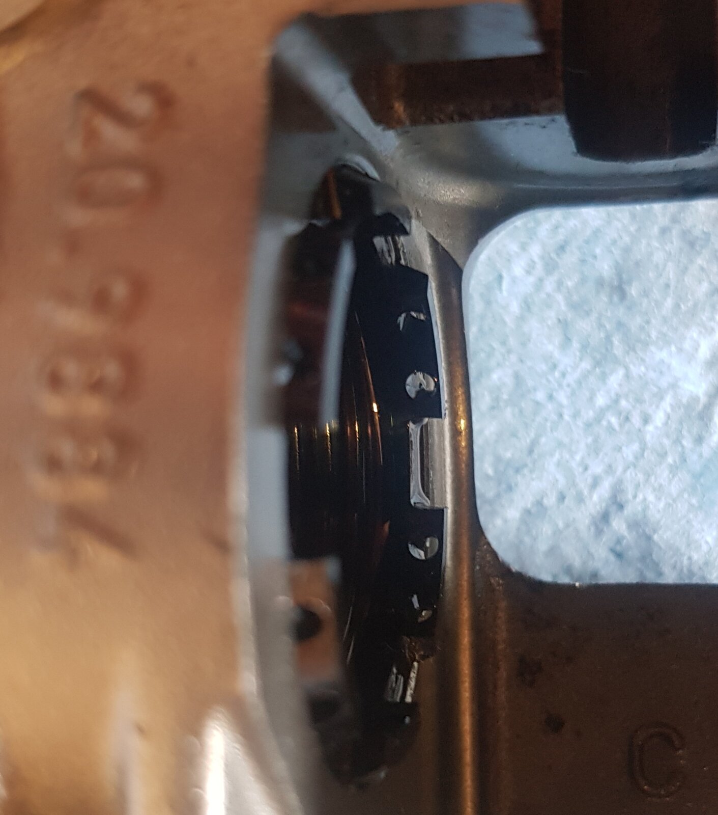

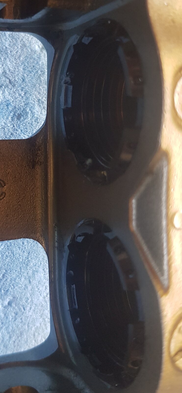

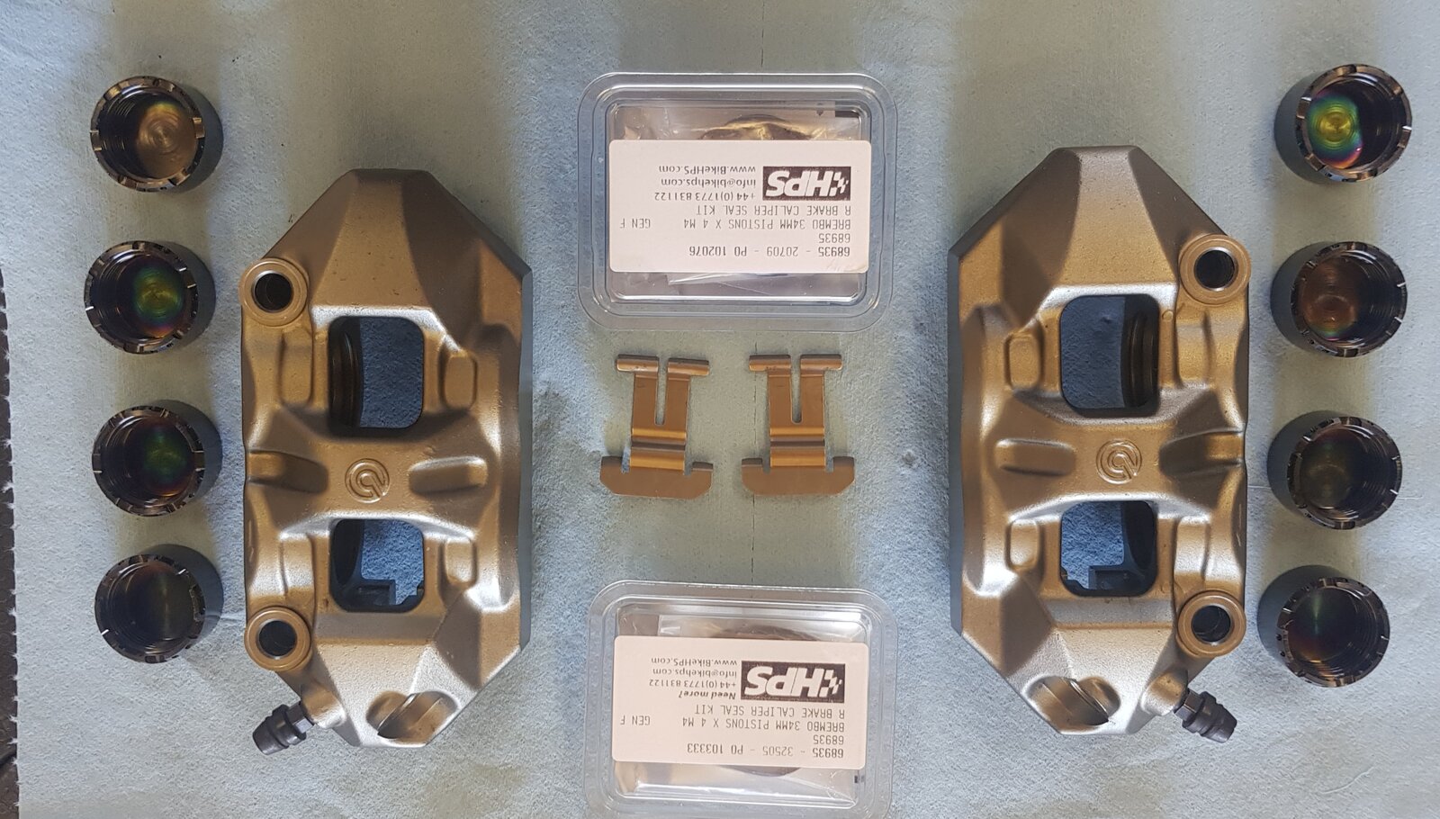

  4. Here we go, the 15 year old M4/34 calipers cleaned up nicely.
    This is the kit I bought.
    Titanium, ventilated and castellated pistons
    and the finished calipers
    Andy

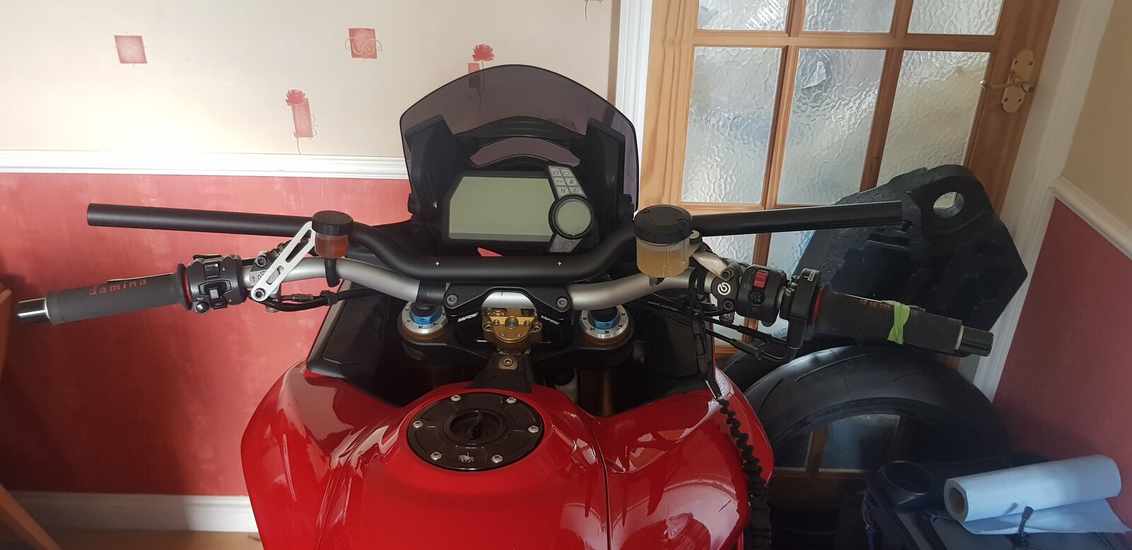

  5. Just collected my Monster handle bars and there is quite a difference in width. Andy
  6. Handlebars have been swapped over which was a fairly straightforward task and I seem to have found a position that works for me. Most definitely not a swap that would work for standard switch gear and master cylinders. The holes in the Monster handlebar for the locating pegs are all out of position for the Multistrada. My billet master cylinders don't have location pegs and the starter switch gear is rotated about 60° forward which is of no issue. It would, however, bug the hell out of me on my road bike. Bring on Silverstone. Andy

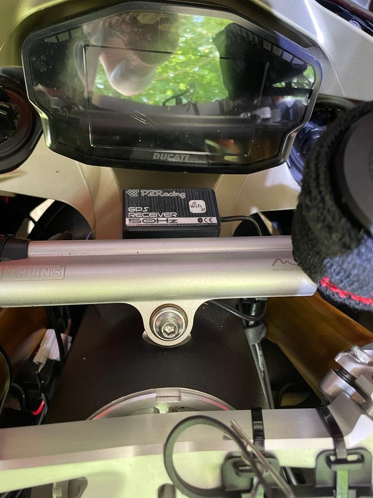

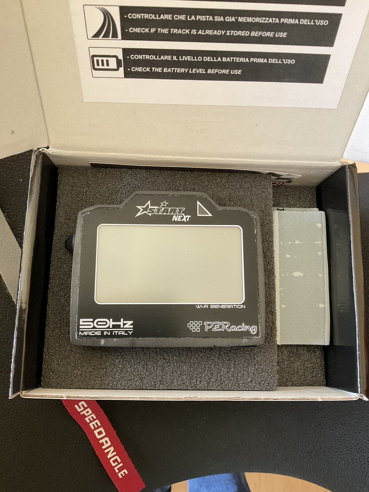

  11. @bradders That PZRacing GPS worked a treat on my 1299. Puts time up on dash and no input from rider asides riding the thing. It knows where you are and where start/finish is.
  12. Great thanks, I’ll get myself one of those
  13. Now trying to figure out how to fix it securely to the bike. Just how good is this new version Velcro that looks like lots of little bobbles. Andy
  14. Have you tried it on the road? Also any pics of it fitted, see how you mounted it
  15. I’ll post a pic tonight brad.
    I have mine mounted on the fairing subframe (gold thing) in front of dash. I used the velcro to lodge it there.
    For it to work your dash needs to be in track mode display. It does nowt when in road mode display. So for the road, its pretty much just an ornament. In track mode display, the lap timer function is prominent. It has all the tracks built in. When I cross the start/finish it activates itself and begins and stops once ive crossed again and shows your time. The module holds 6hrs of data which you can download to pc using raceapp app. Ive learnt that I need to set that up on pc BEFORE I go. :)
    However, for each lap it displays it and thats all i ever wanted.

  16. @Biot, the brake mods made a noticeable difference, I’d go as far as to say, transformed is appropriate. True, a lot of money but the difference in how and when I brake, has made a huge difference in my lap times. Andy
  17. Appreciate the feed back @Android853sp.
    I've followed his story and good to get a customers perspective. Just wonder why Brembo et el don't make similar if the benefits are so pronounced:neutral:
  18. As far as I know, they are but not for the likes of you and me. Much like the Braking race pads I acquired. The technology has to have come from somewhere and wonder if it's a car thing. Found 3 manufacturers offering their own versions for most Brembo calipers, including the Stylema. Andy
